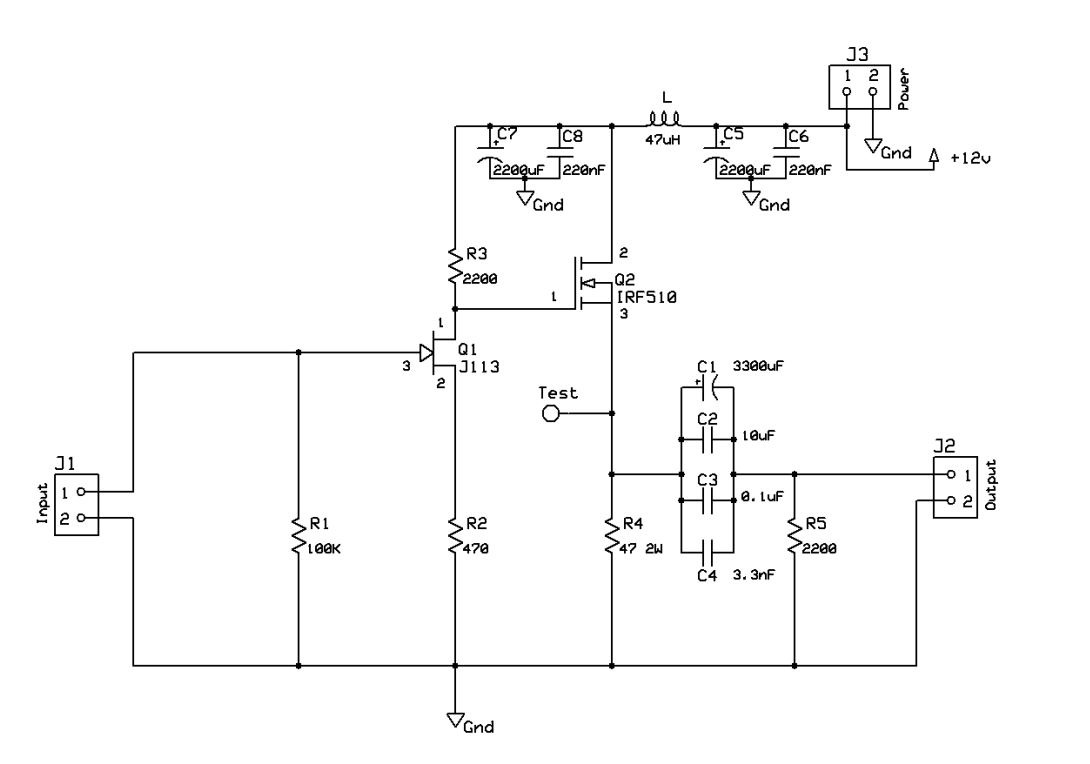

What about J112? Did someone try them in combination with IRF510? Or can yout tell the difference - other than gate current from datasheet - in this schematic? What should I change in a set of values calculated for J113?found a bag of BF245A JFETs, they seem quite similar to the 2N5484 so im going to see if i can get this working on a breadboard this evening. Just need to find another IRF510 or a pair of similar ones in my collection
Maybe it's a silly question, sorry, but I have very limited experience with j-fet or mos-fet...

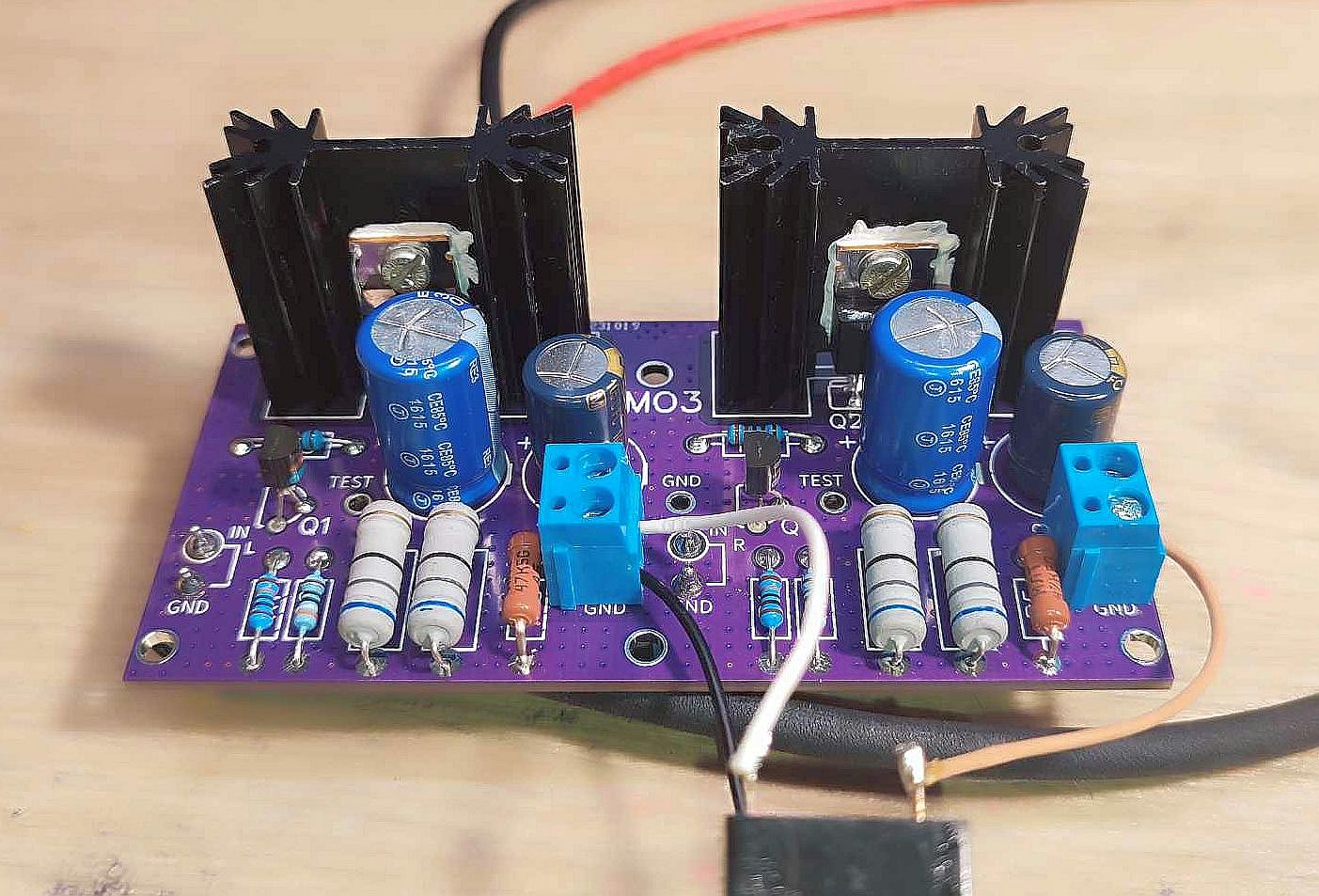

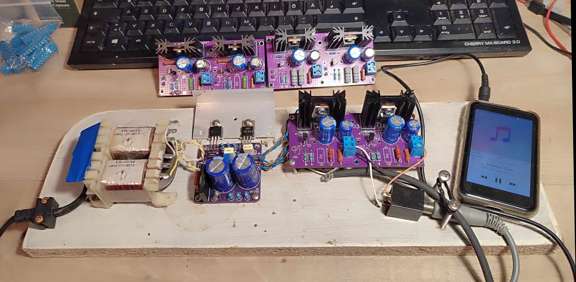

Here below is my work of the few last days: all 3 impedance version of this intriguing amp. All are working, nothing measured yet, apart from correct bias, but the listening impressions are awesome, and my greatest surprise is that all versions are fully interchangeable with all kinds of headphones - range 18-300 ohms - with some gain limitations, of course, but fully playable.
I have some mentions - based on my practical approach:
1. I recomend, if you don't have the best quality capacitor for the output C, use in parallel an 1 uF non-polarized one, in my case soldered on the back of the PCB.
2. In the first built version, the "Medium", I used vintage J113, salvaged from an old mixing console and the schematic values were the given ones, with the 330R I got above 2V on the test point. I mounted 390R and the voltage on R4 raised to 2.7V. But in the other two amps I used new On-Semi j-fets (or just hope to be OnSemi, as the store says...) and in this case the correct bias worked only with severely adjusted values, for "Low" I used 120 and 135 ohms - some channel imbalance which I cannot explain, on my tester both fet and mos-fet pairs were almost equal. This was my second amp, the last build was the "High". Here I used 240R and the voltage in the test point is around 4.6V. I strongly recommend, before mounting the R2, to use an adjustable trimmer of 1k, previously measured and adjusted to the schematic value and to choose the right value for you, measuring the voltage in the test point. After that you can replace the trimmer with the closest resistor available, or to use a combination of two if you want to have the absolut exact values as measured.
The power supply I used in all 3 cases is a Nazar power supply, the positive half. It provides very good and clean output, no hum was present at the output, at least in the limits of my hearing and headphones available.
The author of the pcb's I used is here, in this discussion, if he wants, I kindly invite him to show here and if someone wants the files of the projects, feel free to contact him.
By now I just listened to all three amps, in the weekend I try to make some time to put an osciloscope and a generator, but musically these amps earned a good place in my collection, that's sure!

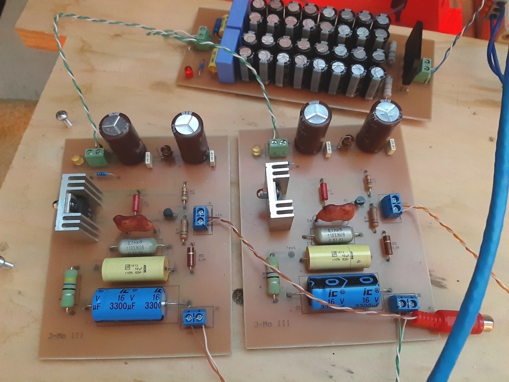

Listening to it right now.
Preliminary impressions: A well-defined, full and dynamic sound. Very positive.
It sits on a breadboard at the moment.
The 2 separate PCBs are one for each channel, sharing a common PSU PCB.
Might populate another PSU PCB (with its separate power TX) for a true dual-mono setup.
Schematic:
*actually powering it with 14VDC instead of 12VDC seen above

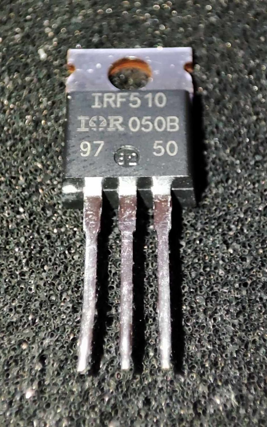

Hello!
Has anyone of you tried other types of mosfets instead IRF510?

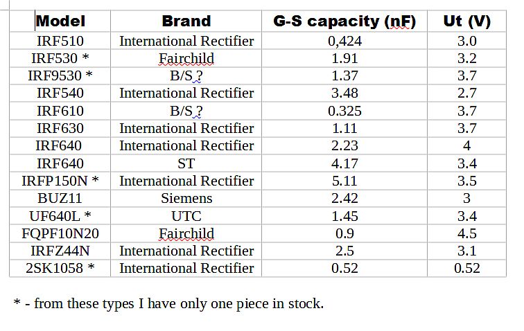

As far as I know, the most important parameters in audio, for a mosfet, are:
Input Capacitance (Ciss) / Output Capacitance (Coss) and Reverse Transfer Capacitance (Crss).
I don't have gear to measure such parameters, but I have a multitester which displays one capacity and one voltage, I think it's the gate-source threshold voltage.
Based on this information, I made this table...After I made 3 version of this amplifier with the originals NOS IRF510, made by International Rectifier, I want to fiddle a bit with this schematic, seeking the best performance. From my measuring, it seems the IRF610 has even less capacity, maybe the G/S capacity. I will try this first, but maybe it could be interesting to test the others, unfortunately I don't have pairs of all the mosfets in the table.
Maybe this curiosity is useless, for such a simple amplifier, still, any documented opinion, based on theory or taken from practical test or audition should be welcome!
The differences in sound I expect to be more significant than the tube rolling, where maybe 10% is true sound difference and 90% placebo...don't shoot, I also like/use tubes! At least the frequency response should be different from one device to another, regarding the capacity differences.

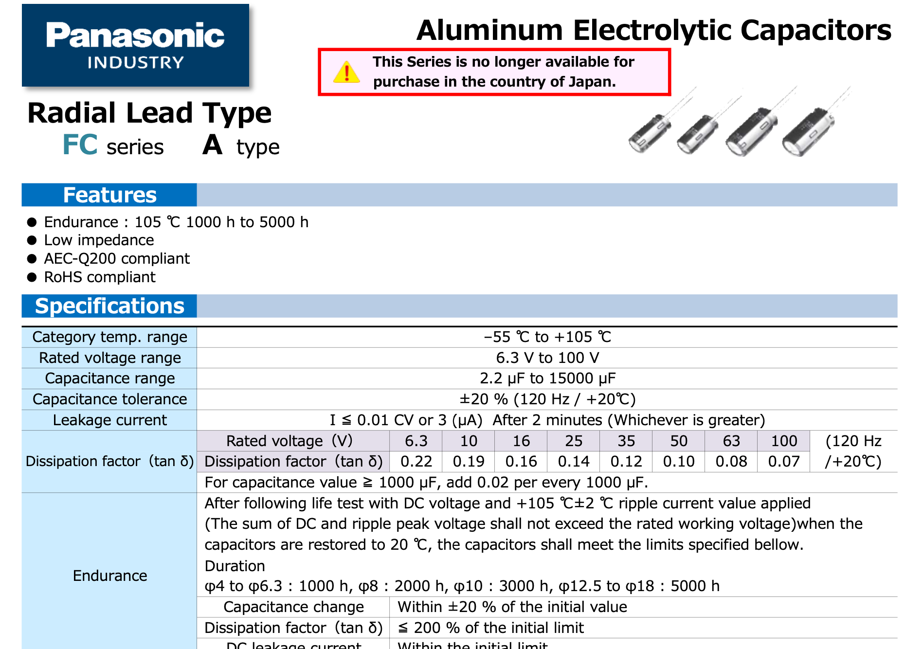

One observation: initially I used a 2200uF 25V capacitor at the output. The sound seemed a little flat and dull. I then replaced it with a 2200uF 50V capacitor and the result was that the sound opened up on both ends of the spectrum. It sounds pretty good now.
Any reason why a higher rated cap would make a perceptible difference?
For sure it's not the higher voltage rate the reason, but the better capacitor brand. Also you can try to add a non polarised 1uF parallel to the output, the highs may be further better this way. If you have some higher quality 1000uF, this is enough, except maybe for lower than 32 ohms headphones.
The reactance at 20 hz for 1000uF is about 8 ohms, and around 4 at 2200uF. For higher than 32 ohms it's obvious the 1000uF value is enough...
I think I read somewhere, the higher voltage caps have lower ESR? I don't have the specs for the caps I'm using (both from the same manufacturer: Keltron)
ESR is irrelevant here, maybe better isolation between plates...try also adding 1uF and compare the high frequency response 🙂
Low ESR is recommended.
Use Panasonic FC-FR /50V . After a while, a few hours of operation it will sound very good.
