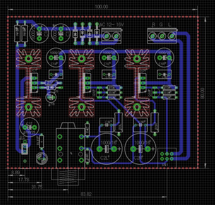

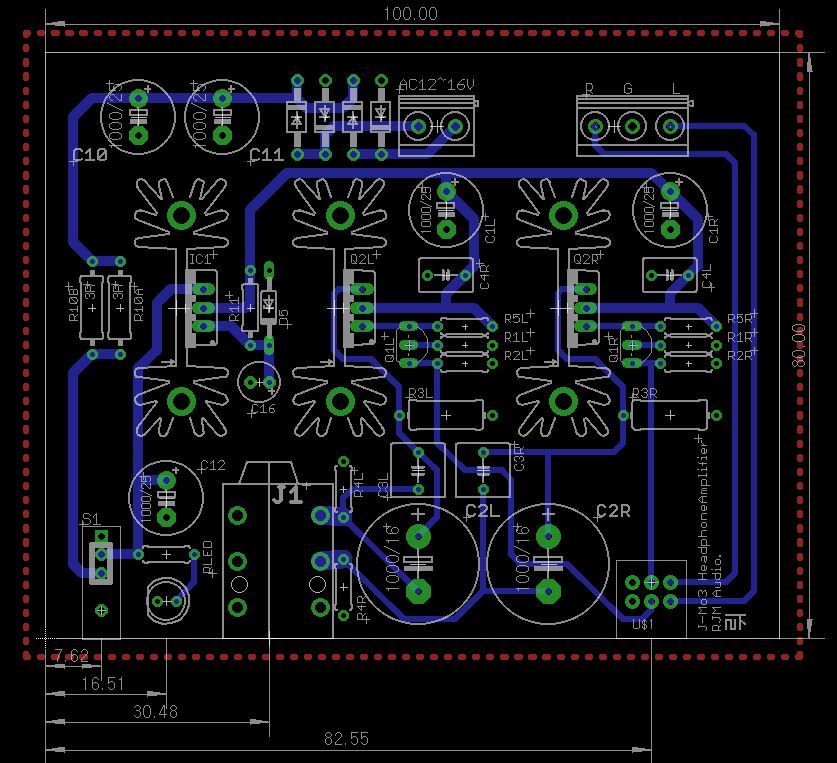

low cost desktop amp project based on JMO3
Have been thinking building a low cost desktop amp for working place. JMO3 was one of best candidate. I made first layout for 100mm*80mm PCB. Any recommendations or advices welcomed🙂
I like it.

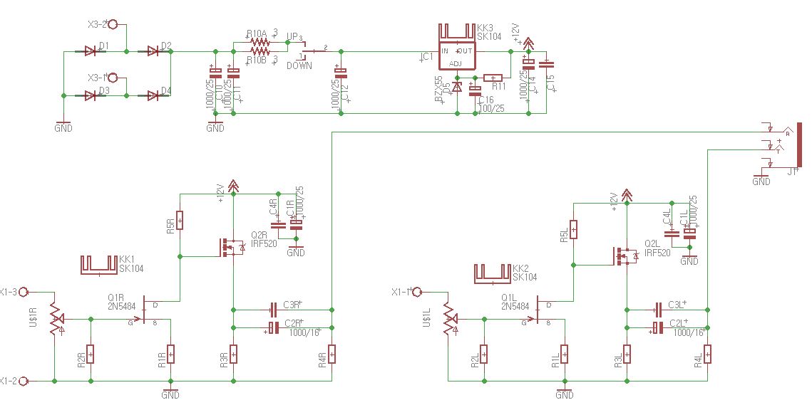

1. It seems an odd place to put the power switch, after R10. I understand that it doesn't switch the AC, since the power brick is external, but is there any logic to having it after C10,11?
2. power terminal incorrectly labelled RGL.
3. C2R/L butt up right against the front panel.
4. is the volume control the correct outline? It doesn't show the mount or the shaft.
5. I would add a mm or so clearance between C14/C15 and similar.
6. is a Zener really better than a resistor for the adjustable voltage regulator?
Richard
Richard
Thank you, Richard!
Actually not.
I just wanted to keep power switch on front.

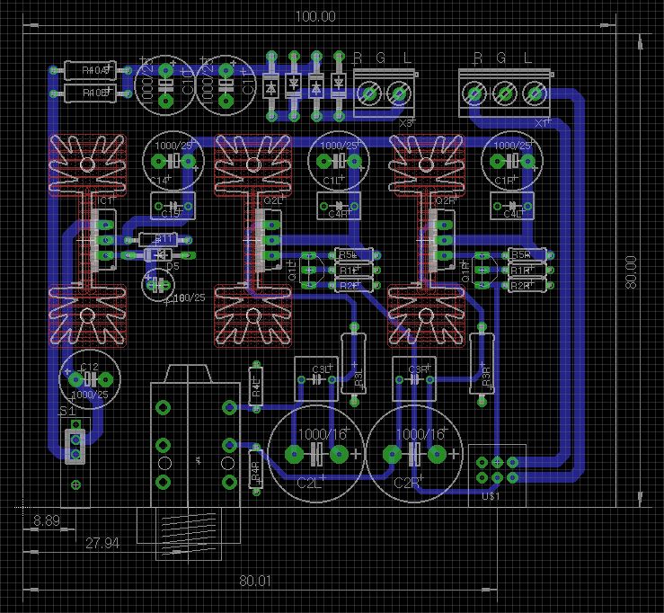

I will modify schematic and layout tonight.
Any other advice is welcomed🙂
Actually not.
Do you have any reason with E-cap direction?3. C2R/L butt up right against the front panel.
I haven't measured it, but I read an article that using zener reduces output noise of LM317.. I don't know it is really better or not, but I decided to try since BZX55 is cheap.6. is a Zener really better than a resistor for the adjustable voltage regulator?
re. 3. not the direction, but the lack of free space. If the capacitor is a little large, the board cannot sit tight up to the front panel.
/R
/R
If you upload the eagle brd/sch files maybe I or someone else would volunteer to do some touch up.
I think it's basically fine though. Did you check it passes ERC/DRC?
Yes. I checked with Seeed studio DRU, no issue found.
I will upload eagle files tonight🙂
