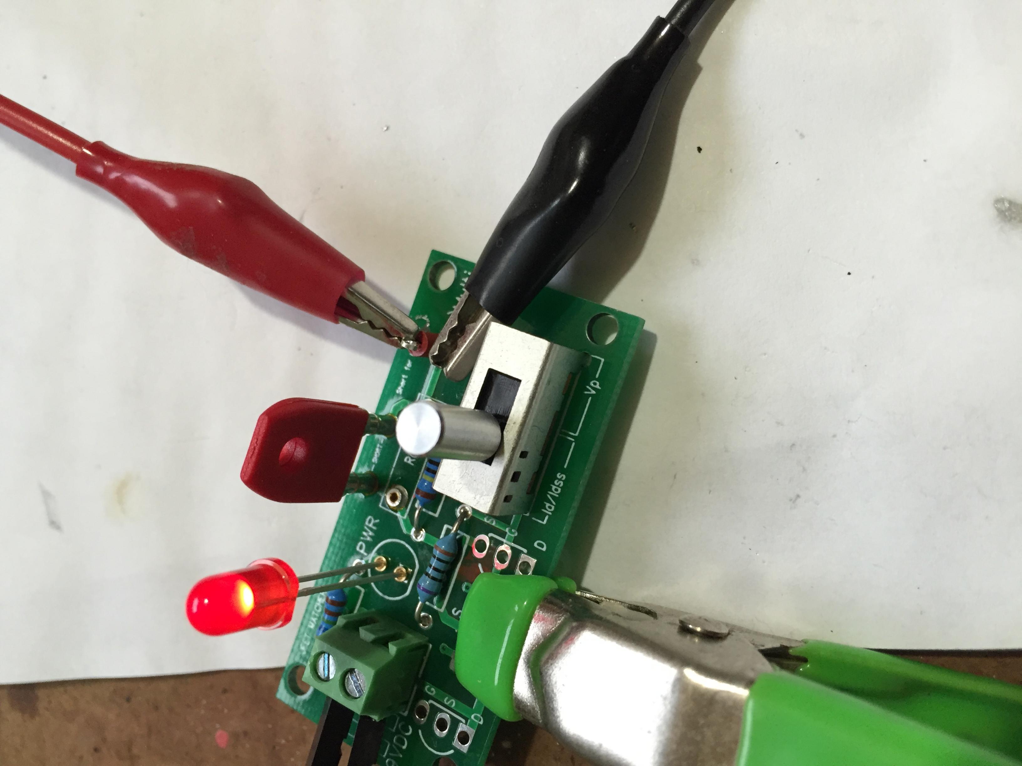

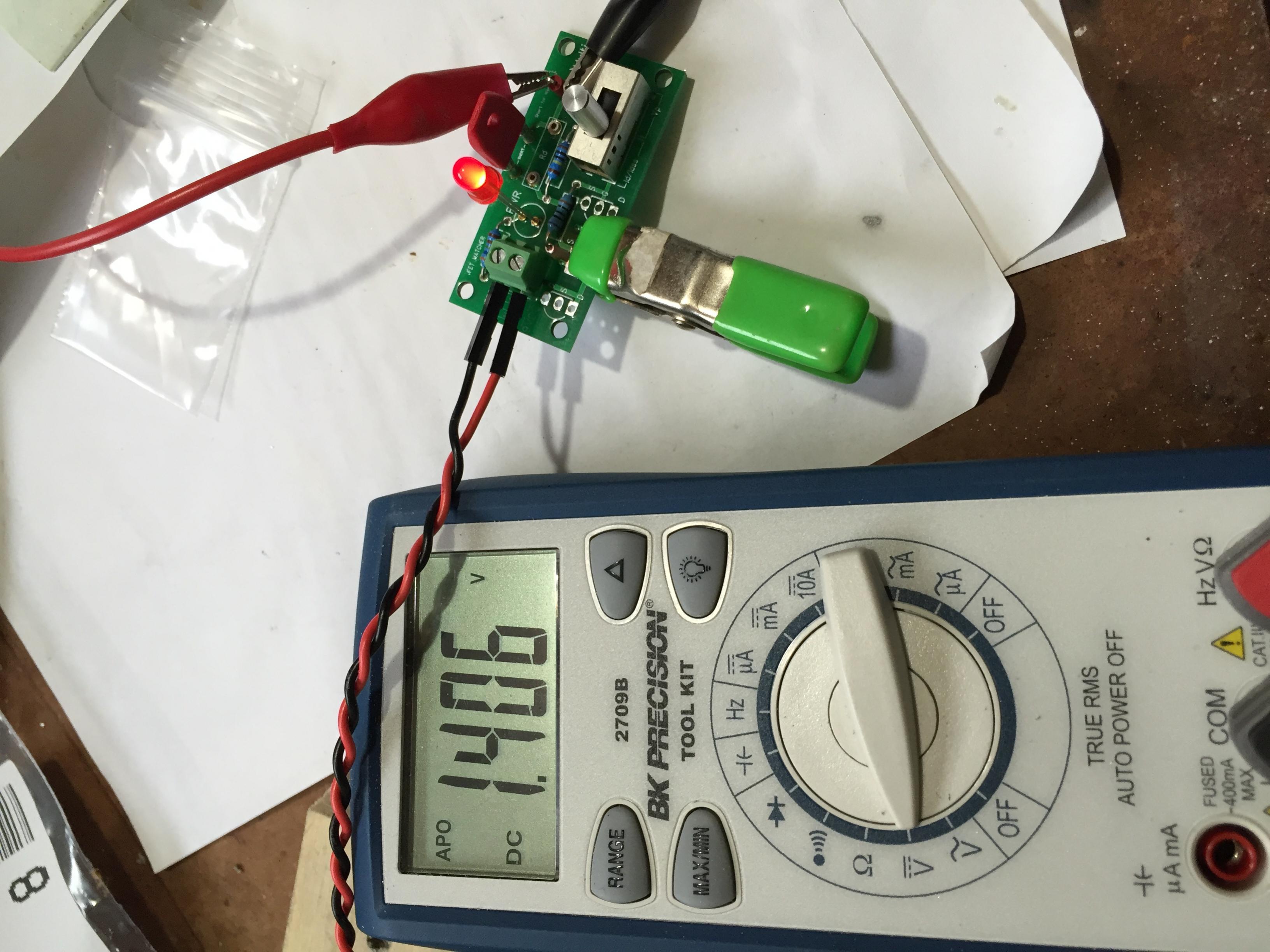

Assembled and tested
So today finally I am free after many days of work.
Assembled the board and happy to report everything working as expected.
I went ahead and matched few JFets on the spree.
Must say a stable jig is very essential in matching Jfets. I guess since we are dealing with ma currents and wants to match for 0.5% etc.
Attached the pic of my setup. Only thing I will do different next time make board bigger to make things easy to manipulate.
I will start shipping today afternoon!
I will start making a document on set up this week.
In general ,measure the resistors before you assemble. Assemble the smallest components ( in this case the PCB mounting hardware for resistors and led etc) first.
Very important apply a tiny bit of solder on SMD pads to make the surface irregular , seems like in the untouched form they are not making contact with SMD pins, too smooth?
Thank you.
