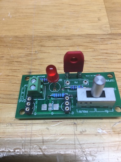

So that is just a package designation for original Toshiba dual JFETS.And no such socket is available anywhere that I am aware of.
So what I did was get these two parts (Its in the mouser list linked at the first page)
90147-1104
90147-1103 and solder them at the 4 pin and 3 pin positions and use a drop of superglue between them. Don't forget to hold them together tight while glue is curing, with a clamp.
The dual jfets will slide in without any difficulty.
DON'T FORGET ,if you don't hold them together they may get pushed to the side by glue while curing.
However ,You do not need the socket or dual switch for board to work with non dual jfets.
I will add this description in first page.

Switch question,
There are two different switches in the BOM,
The first mouser has stock.
The 2nd, mouser is back ordered.
I've seen a pic of one board with the metal vertical slide
switch, but the black plastic vertical slide switch was back ordered.
Does it only need either swich?

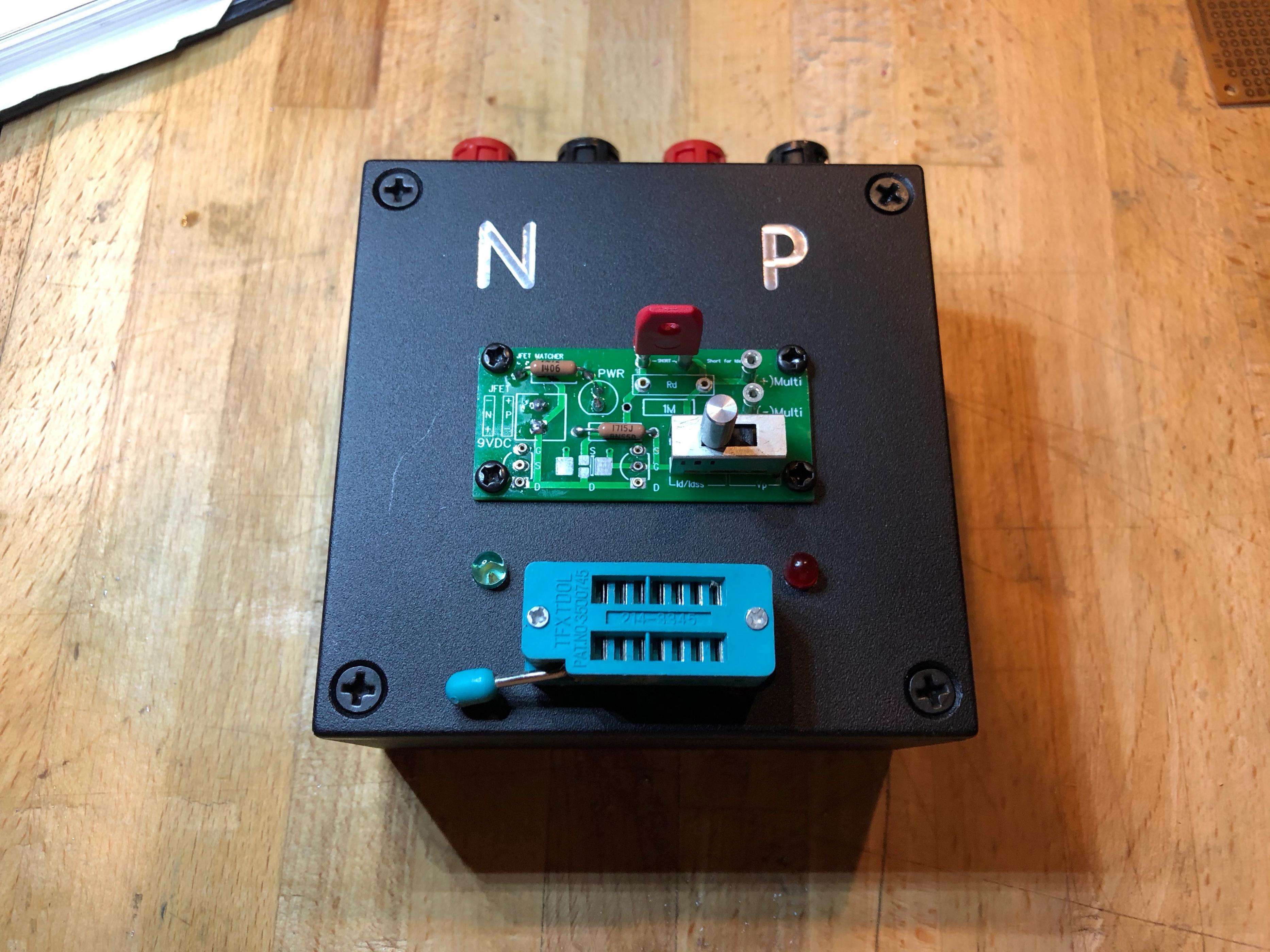

My take
