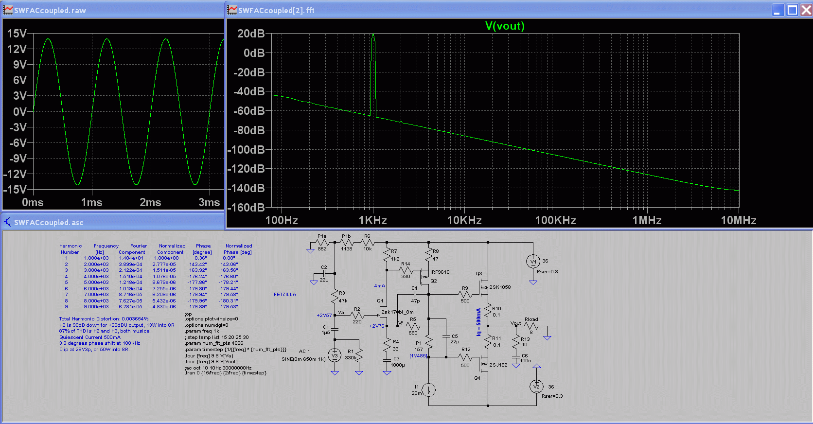

FETZILLA UNDER SPICE
Here is the Spice analysis of FETZILLA. I have reduced the jfet stage current to 4mA for reasons of dissipation, increased rail voltage to 36 for 50W of output power into 8R, and amended gain very slightly to 21.6 (26.7dB, close to the THX standard of 29dB).
This is a VERY good amplifier, hats off to Lineup, SWF, and all others who contributed.
Hugh
Hugh

Hi SWF,
Yes, good results.
You have to watch those jfets. Even the K170 is only rated to 40V, and with 36V rails it's pulling Vds of just under 30V, you wouldn't want to go higher. And if you are forced to use a cascode, then I'd be tempted to go bipolar input stage, OR, use the DN2530.
I did the OLG calculation on LTSpice. For an output of 28.2Vpp, the differential across the input gate and Q1 source is 0.93mV. This gives an OLG of 28,200/0.93, which is 89.6dB. Since gain is fixed at (680+33)/33, 21.6 or 26.7dB, we have a loop gain (at 1KHz) of close on 63dB, which is actually pretty high. I was surprised at this; it's about lineball for a BJT design, and would give high DF and flat frequency response.
In short, given that 33R rather than 20R on the fb shunt allows use of a smaller blocking cap, improves overload capacity and the loop gain is high anyway, I would be reluctant to deviate from this from a technical POV, but if it transpires that it actually sounds better, then why not?
I will leave provision on the board for a gate stopper on the VAS; this will permit a variety of devices to be tested, which is a practical feature for a forum design.
I use a Black Gate NP 22uF rated to 6.3VW as bias generator cap, and have enjoyed very good results. We could use a smaller one, but at the very high current of this VAS, 20mA, it needs more rather than less to keep the bias voltage constant. I will have a look at the model, see what happens when it's varied.
Yep, damn good design, this one is really worth running with!
Hugh
