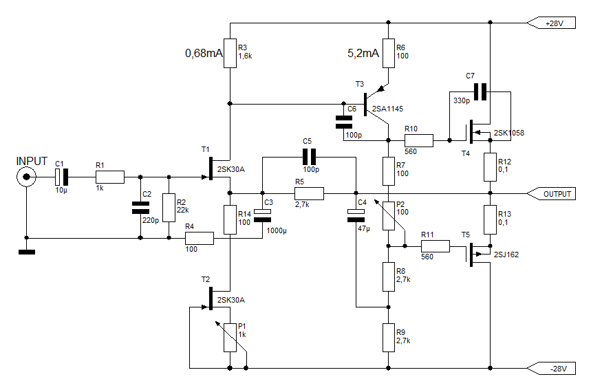

Where you been!? Are you still listening to this amplifier? What are your current feeings about the sound? Is the circuit you just posted the one you are currently listening to?
Btw, 4700uf seems small for an output cap....
I can't Rush when i build Amplifiers, too much tension blinds my hearing.😀
At the moment I hear this circuit.
The wan I just posted was only a to Fet modified drawing of the Black Devil Amplifier.
VAS MOSFET
It is easy to use Fetzilla as preamplifier.
Just remove the output stage and take output from VAS.
One can adjust for more or less current.
In my diagram it is 11mA. This is standard for VAS.
A good project to begin with 🙂
Distortion is low and sound should be good.
But this remains to see/hear when somebody
builds Preamplifier Fetzilla.

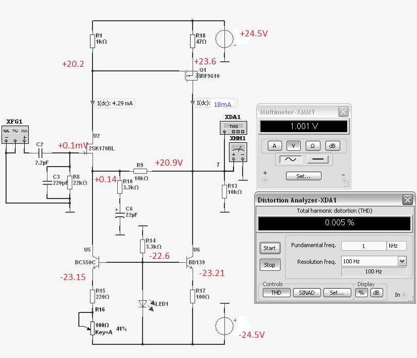

Hi Lineup,
I tried to build the official Fetzilla power amp using a old PCB. I don't have the IRF9610 so I used IRF4905 and IRF4905 does not work too well. I got about +21V at the output. I swapped the BC546 & BD139 & IRF4905 and it made no difference.
I removed the output L-FETs (K1058/J162) and converted it to a Fetzilla pre-amp & it gave similar result.
Here is some voltage readings:
Vsupply = 24.1V
Gate of k170 = 0.1mV
Drain of k170 = 19.8V (I-ips=4.3mA)
Source of k170 = 0.14V
I used a trimmer (213R) to substitute R15 & R16.
For U5, I used BC546C
Collector of BC546 = 0.14V
Emitter of BC546 = -22.65V
Base of BC546 = -22.05V
Base of BD139 = -22.05V
Collector of BD139 = 20.8V
Emitter of BD139 = -23.21V
Source of IRF4905 = 23.35V (I-vas=16mA)
Gate of IRF4905 = 19.8V
Drain of IRF4905 = 20.8V
I just ordered a few IRF9610 from RS and hopefully that they will arrive in a week or so. I will try Swordfishy/Hugh's version as well. I think that the magic of this design lies with the type of MOSFET for the VAS.
Cheers, Stanley

Stanley,
Can you post your schemat with voltages highlighted?
There will be a good reason, but we are a bit in the dark with the schematic.....
Hugh
Hi Hugh,
I have attached the schmatics, the voltages are in RED.
It is possible that I made some mistake with the wiring, I will replace the Q1 with a PNP BJT tonight.
Cheers, Stanley
sng001, you'll have to use multiturn pot in place of R17 in order to set 0V at Q1 Drain.
You have to equalize currents through Q1 and U6.
Also, it would be nice to isolate U5 and U6 bases one from another (put 1k in U6 base).
Stanley,
Because your fb resistor is a high 10K, necessary to reduce loading on the VAS (IRF9610), any current not passed by the lower left CCS (U5) will pass through this resistor. In fact, only 2mA through the 10K resistor (50% of the drain current through the jfet), will generate the +20V offset you are seeing.
Solution: The CCS is drawing too much current. For the jfet biasing shown, it should draw around 4.1mA. This corresponds to 330R between emitter and negative rail of the CCS, so simply replace the 100R trimpot with a 200R trimpot, OR, increase R15 to 270R and use the existing 100R trimmer.
Hugh

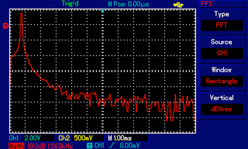

FFT Analysis
Hi All,
Today my new 100meg scope arrived. It's only a cheapie, but here is the FFT analysis at 1kHz, 8V p-p into 7.2R for the bootstrap VAS version.
Y axis is 10dB per division, x axis is 1.5kHz per division.
The noise floor is similar to my sig gen alone...
Interested to know if this is a decent result, or if I'm even using it properly. There's a few different types of FFT to choose from and I'm not sure this is the right one.
Look forward to your comments.

Mikelm, looks good. I really like the idea of using an LDR for the servo. Please keep me posted.
Do yourself a favour and build the ccs vas version first. It's the best for multiple genres. Bootstrap is nice for vocals and that's about it.
Take your time, I'm eagerly awaiting your impressions. I hope it lives up to your expectations.
By the way, did you get an small signal fets to try at the input?
I'm waiting on some irfp9240s. Gonna try it with vertical fets biased at 2A!
SWF,
Your FFT looks good to me
