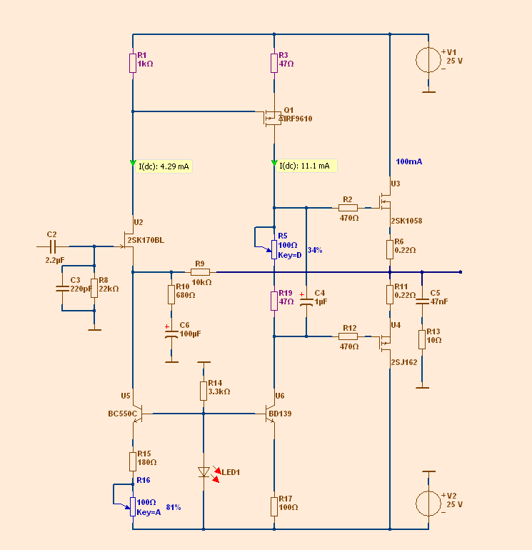

Direct Coupled DC Offset Test Results
Mikelm.
Here are the DC offset test results for the direct coupled circuit I posted. As you can see it did not stabilise within an hour, though it was better than I expected.
I must admit, this is the first thorough test I have done with the mosfet VAS, so I don't know if this drift is caused by the fet VAS or the direct coupling or a bit of both.

SWF,
This seems pretty high.... too much, in fact.
The drift indicates quite a big change in Vgs on the VAS, but there may also be changes for the input jfet as well. Both will compound the offset drift.
Is there a heatsink on the VAS? Reducing its temperature range will reduce the drift.

Hugh,
No heatsink on the VAS.
Maybe a better option is to use an IRF610 n channel fet as a CCS for the vas? I assume this would work in opposition to the VAS device and stabilize the offset - though the bias would increase slightly, but not really a big deal.

Swordfishy,
The change in Vgs of VAS MF may act to cancel DC offset at o/p so we don't necessarily have to try to reduce it.
As someone said already the key to DC offset is current in the i/p stage.
If we want to achieve low DC offset without a servo (which we know is possible because TimA has already done it)
The first thing we need to know is:
How the current in the i/p stage changes with time.
Then we need to establish what final adjustment is needed to that current to restore low DC at o/p
Then we need to go figure.
Let's examine offset drift in SWF's design.
As Mike identifies, it's controlled from the source voltage of the input device, which in turn works off the gate, which is fixed by a bias voltage. Set the gate voltage, and the source will follow, though there is always some mischief between gate and source on any device. Typically it will change by around 2mV for each Celsius rise in temperature.
Let us assume the output is a 0mV offset, that is, perfectly nulled.
The entire current from the input device, the jfet, is passed through the feedback resistor to the output. This current enters the jfet through the drain, and originates at the point where the gate/source resistor on the VAS, in this case 1K, is attached to the rail.
The value of this VAS gate/source resistor, 1K, fixes the current through it when the amp is operating. The VAS operates at around 4V of Vgs, so since the gate passes no current 4mA must flow from the positive rail, though this resistor, to the drain of the input jfet, and then out of the source and into the series feedback resistor to the output of the amplifier.
Now, consider what happens as the VAS warms. This is a mosfet, and the bias voltage changes far, far more than it does for a bipolar or jfet device. It's Vgs drops precipitously, let's say from 4V to 3.6V.
This reduces the input stage current from 4mA to 3.6mA since any fixed voltage across a resistor comprises a current generator. With an amended stage current, the jfet will also see a change in its Vgs, slightly lower in fact since the current is less, and this in turn will shift the potential at the jfet source up slightly, but this effect is secondary and lower since jfet biases are an order of magnitude lower than mosfet biases.
Of most significance is the reduced current through the series feedback resistor. Assuming it's 500R, what was once a voltage drop of exactly 2V leading to 0mV at the output, is now reduced to 1.8V, and in consequence, since the input stage bias voltage remains hopefully unchanged, we see a rise of 200mV in the output offset. In fact, any current change through the VAS gate/source resistor will also show up at the series feedback resistor, and since the ratio of these two resistors is 2:1, then the offset voltage change will always be exactly half the voltage change in Vgs at the VAS.
We have some options; one is to cool the VAS and keep it as close to room temp as possible; another is to use a different device whose bias voltage changes little with temperature (any bipolar is good here, such as a 2SC3423, which might change only about 60mV in a 30C rise).
A decision may be needed. My own preference would be to use a different VAS, and keep it well cooled.
BTW SWF, using another mosfet as CCS won't change things at all, since it is not the current through the CCS which is controlling proceedings; rather it is the current through the first stage, and this is controlled solely by the resistor between gate and source of the VAS.
Hope this explains things clearly,
Hugh

But, Mike, that won't change things...... when you switch on the amp, it's cold, then, regardless of constant power or otherwise, it still warms up, moving the offset.
Nah, only one way around it. Either keep the VAS at room temperature - difficult - or use a servo. On my large NAKSA, the 100W//8R, I use a single transistor servo which keeps it within +/-5mV with a single one time adjustment.
Hugh
Hugh & all,
This is getting very confusing I think we should state if we are talking about DC linked or AC linked versions at the top of out posts.
Hugh,
In your explanation above you seem to be discussing an AC linked version because you say all of the i/p stage current flows to the o/p and with DC linking this surely is not the case.
Since Swordfishy is trying the DC version presently I am thinking to try and address the offset probelm without resorting to a servo.
