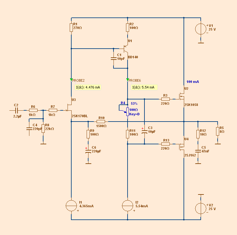

Well I've got it stable again and with no capacitors this time. All I had to do was increase the gain as you guys suggested. I increased the series feedback resistor to 2k and left the input source resistor at 100R. It's stable as far as I can tell. No compensation of any kind.
However the sound is now missing something and seems to have lost the crisp edge it had before. In fact, it sounds ordinary. It's not bad, just not particularly special. Maybe dropping the series feedback resistor to 200R and the input source resistor to 10R would solve things.

It is true. Using one BD140 as VAS transistor and dropping the OLG by increase feedback resistors
we do not need much or any compensation capacitance.
In my schematic below comp cap is smallest: 10p
Closed loop gain is set by 1500/100 Ohm and is Gain=16.
By further increase the 1500 Ohm feedback resistor
I wouldn't need the 10 pF cap.
Another way would be to increase R2 (100 Ohm) for even more degeneration of the BD140.

Hi All,
Just a quick question....what is the official process for testing stability with a sig gen and cro? What is the process for testing capacitive loads?
With the bipolar vas and circuit in post 336 I see no signs of oscillation at any frequency or output voltage between 0 and 20kHz into a 7R resistor or 1uF capacitor. Just nice clean sine and/or square waves (sometimes a little ringing on the square wave, but not HF style stuff). No fuzziness or anything to indicate HF oscillation. Not like my old power follower, see here:

Actually the most challenging values can be 10 - 100nF so if we want to claim the design us unconditionally stable you would have to test 1n, 10nF 100nF & 1.0uF & 2.2uF in parallel with 8 ohms
I'm sure the higher values will cause ringing but should not oscillate.
Personally I think the 1.0 & 2.2uF is a bit crazy but it seems to be a standard test but in spice on this design I found the real killer value was around 100nF
Mike is absolutely right about it. Simulations has shown me that the most difficult load is around 1 - 220nF. To be sure i would recommend to test in 10nF steps.
And a Zobel network would be a good idear together with and output inductor (if you don't fix it in another way =O) ).

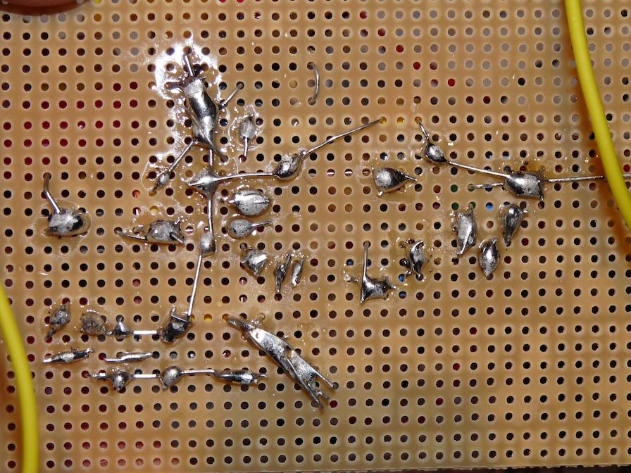

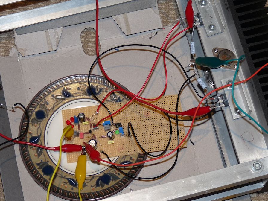

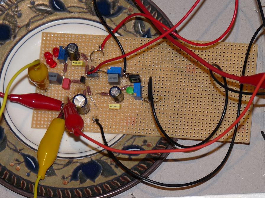

Stable....even with a poor layout
This is how easy it is....

swordfishy
congrats to the result of capacitive testing
You have a very good amplifier there 🙂
Will you add filter against capacitive loads?
For example: One bigger resistor 10 Ohm and wire wound inductor around it.
Like 10 turns. And put it in series with output.
Maybe you do this only if you need it.
Lineup: thank you - it was your design 🙂 I will try the filter tomorrow. I don't think it needs it, but if it still sounds good I will use one.
Moschfet: yes I know the long wires are bad. I almost didn't post the pictures but I thought it would be good to illustrate just how stable this thing is. Even with the very poor layout it is stable and does a pretty nice square wave. On a well executed pcb it would do even better I suspect.
Miib: thanks. Going to look into that part now. I've never heard of it.
