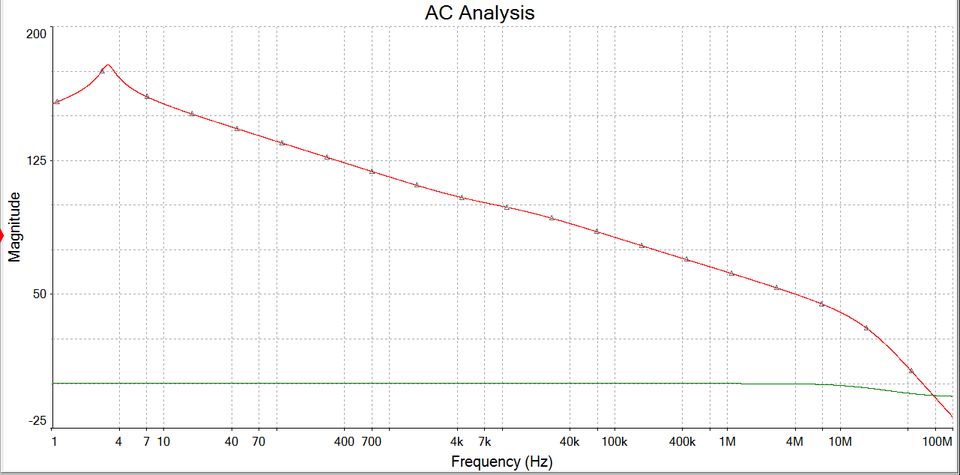

FET has more OLG, wow!
Mike, is your graph a Bode plot, that is, does it reveal how much phase margin we have at unity loop gain? It looks like about 160 degrees, which is remarkable!
Your use of phase lead - John Linsley Hood's technique and one I use in all my amps - works brilliantly and in some cases means you can eschew lag compensation completely.
It's value is influenced strongly by the shunt fb resistor, your values sound good.
If you use 470R of VAS degen, this will greatly increase output impedance of the voltage amp, but it should be OK if you are driving low cap lateral fets.
I had expected a jfet VAS would have less, not more, loop gain. This comes as a surprise to me. One way of reducing loop gain would be to use a bootstrap on the VAS, because the current variation it introduces should exploit the lower transconductance of the jfet, making the input stage work a bit harder.

Phew! So many replies. OK, one at a time:
Yeah this sounds good. Will give it a go tonight.
No not at all 🙂
I did try this on my previous circuit with the FET VAS and it did not appear to help. However I tried much larger values (150 - 330pF), so I will try something smaller.
Haha, now you know what I am dealing with. This thing is a beast. I can put 5 ohms across the output and get rail to rail oscillations way up in the mHz range. It's really quite amazing.

Well, this is amazing......
it's not a bode just open loop gain - I inserted a huge spice inductor to eliminate all AC FB, took out all filters etc and measured levels at i/p & o/p - multisim normalises the result i.e. assigns 0db to i/p signal
Your use of phase lead - John Linsley Hood's technique and one I use in all my amps - works brilliantly and in some cases means you can eschew lag compensation completely. It's value is influenced strongly by the shunt fb resistor, your values sound good.
much of my early audio electronics knowledge came from pouring over JLH articles & designs until I really understood them - it took a long time !
I only did this as an experiment to see what it took to even playing field, 10mA in the VAS gives a 4.7V drop across 470 and this seems a bit too much
I think the BJT has less OLG in at audio frequencies simply because it draws current from the i/p stage - this can be imitated by putting a 470K resitor in the "miller" position across the 4424 ( this gives ruler flat OLG of about 80db up to about 100Khz, not sure if this is desirable or sounds good - I did it to help understand the differences between BJT & FET VAS but I thought even, controllable gain across entire audio band might be desirable ) based on my & others experience here on JLH simple class A, I'm not keen about bootstraps. Most agreed that a CCS sounded better and I suspect one reason for this is that a CCS eliminates more PSU noise and for me that is a major prerequisite for a pleasant & natural sound.
As Swordfishy says how much gain / detail we prefer is just a preference about what sound you like - detailed or mellow . . . but a well implemented high feedback amp can also seriously reduce PSU noise, so choices may depend also upon PSU design as well - which is another topic completely !
What do you mean by "the signatures are different"? Are you referring to the distortion signature? If so, then you are simulating what I am hearing I think. The BJT version sims with higher H2 and it certainly sounds that way. It is very relaxed and nice sounding. Vocals come to life and separate from the instruments. The FET version is a bit more in your face. It has limitless bandwidth and it sounds that way. Very fast transients and no problem doing anything the source asks. BTW, what current are you running in the BD140 for your simulation?
signatures = different OLG at different frequencies

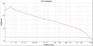

Miller caps reduce HF open loop gain - thus rounding off square waves. If you cannot make it stable using other methods ( that do not reduce HF OLG ) I think I agree that BJT seems attractive but ultimately it comes down to the sound and I cannot comment on that.

The higher OLG from the FET seems to be closely related to how much current is drawn between the 1st & 2nd stage.
With the FET current drawn is more or less proportional to the Frequency and this is reflected in an almost straight line graph of gain decreasing with frequency with huge gains of over 150db in the bass region and falling to around 50db at 4meg hz
The BJT appears to have two principal characteristics that create a flat graph at low to mid frequencies followed by a roll off. I believe this is because the BJT draws some current at all frequencies and this is fairly linear against frequency and this is dominant in the low and mid frequencies causing the flat portion of the graph. However, at a certain frequency the current draw caused by the miller effect capacitance becomes dominant and because this is proportional to frequency we have the decline in gain.
We can imitate a BJT by putting a large value resistor between gate & drain of the FET. This linearises the low / mid frequency current draw and creates a quasi BJT except that the gain is still much higher at VHF. With the FET 4 meg hz is now has typically 50db OLG whereas the BJT has about 25db - Hence the stability problem.
This current draw seems to dominate over other characteristics like lower transconductance in the FET and I would guess this is because the first & second stage are in antiphase.

I've found that in general reducing the impedance of the FB network makes stability worse.
Hugh,
Hope this is clear
mike
Thanks, this is what I suspected.
Lineup, I think you're right. I need to try something silly like 100R/10R. I was just looking at the F5 schematic and realised that this is how NP tamed the F5, which is an even faster amplifier than this one. You need to kill the thing with massive amounts of low impedance feedback.
Also, you may recall that in my first version with the FET VAS this is exactly how I got it to settle down. I dropped the feedback resistor from 1K to 750R and it fixed it right up. That said, I did try 500R last night and it was no good. But I will try to go even lower tonight (100R or so).
Will try this tonight.
The boys say a bit higher value improves stability.
And I think the DC-offset will stay more constant.
The feedback resistor is certainly a compromise to make.
Going too low effects also the harmonics spectrum.
I have used, in my spice with CLG=15,
1500R/100R/220uF
680R/47R/470uF
Possibly lowest is:
150R/10R/2200uF
What you use is a matter of taste.
Depends on what you are after. It is a compromise.
