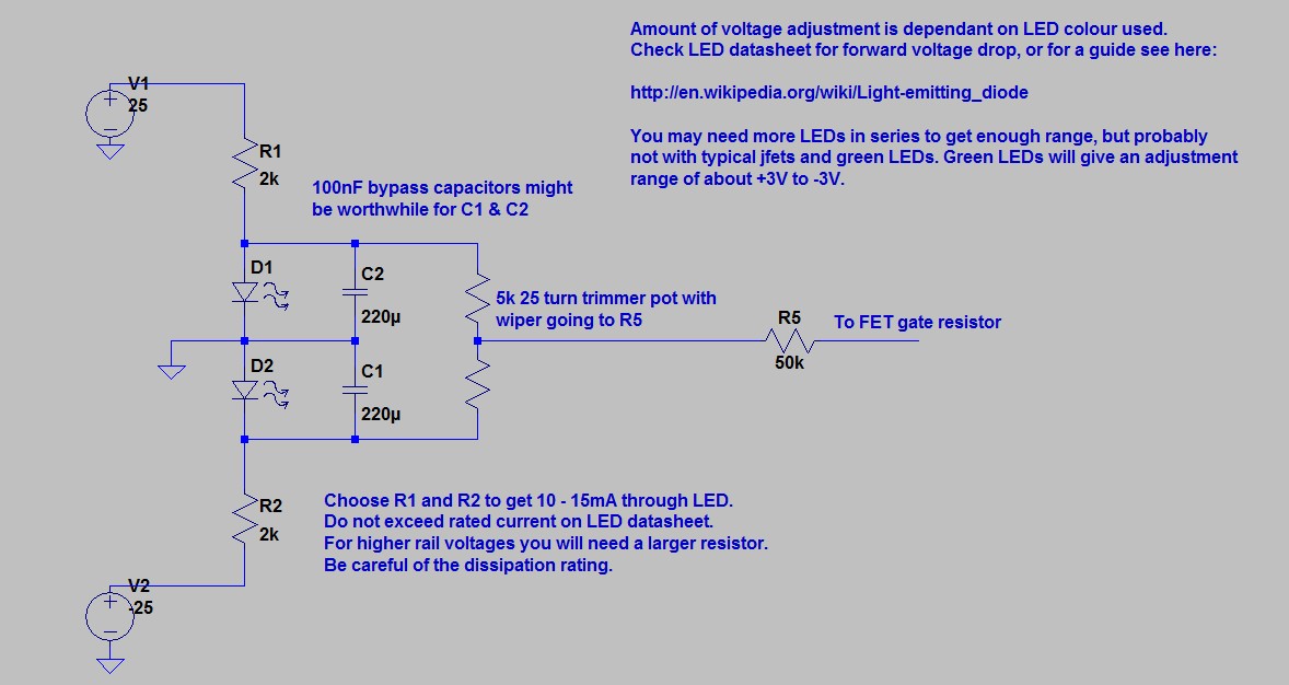

Here you go danspy. I recommend using green LEDs as you should be able to get enough range without needing any more in series. I had to use 3 red LEDs in series for my mosfet version, but if I had used green LEDs two would have been enough. Your circuit is already very simple though. I hope this lives up to your expectations 🙂

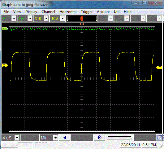

Something else to rouse your interest - 100kHz square wave
The BJT VAS has made everything just a little less twitchy. No ringing at all now on the square wave.
Here is the 100kHz square wave at 20V peak to peak into 7R.
No nasties whatsoever....just a little rounding.
What do you think? Typical single ended VAS character - can supply more current than it can sink...and not helped by the greater capacitance of the p channel output fet. I'm sure I could improve that fall time by upping the VAS current, but what's the point?

For the bias arrangement I posted earlier, I forgot to mention that the one I posted is to allow the use of mosfets or jfets for the input. If you are using a 2SK170 or similar you will not need a positive bias voltage and should only use the lower half of the circuit (remove D1, C2 and R1).
If you don't read this in time it will work fine as is, but it would be preferable to not have any more devices than you need, as the stability and noise will be a bit better. Sorry I forgot to mention it.

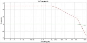

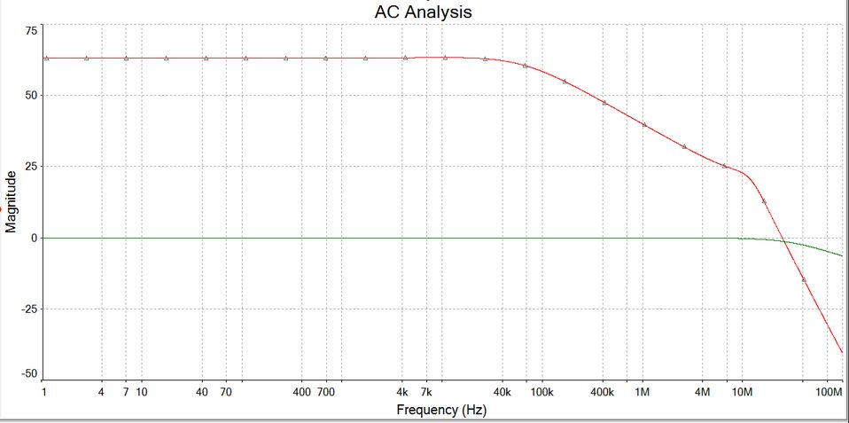

Iv'e been studying the OLG in spice for BD140 & ZTX4424 VAS device and the signatures are hugely different.
the FET has masses more OLG - without VAS degeneration still +50db @ 4megHz !
I needed to add a whopping 470 ohms degeneration to the FET to get similar OLG at HF as the BJT.
So it is now easy for me understand why the two versions sound so different and why the Mosfet needs compensation . . .
