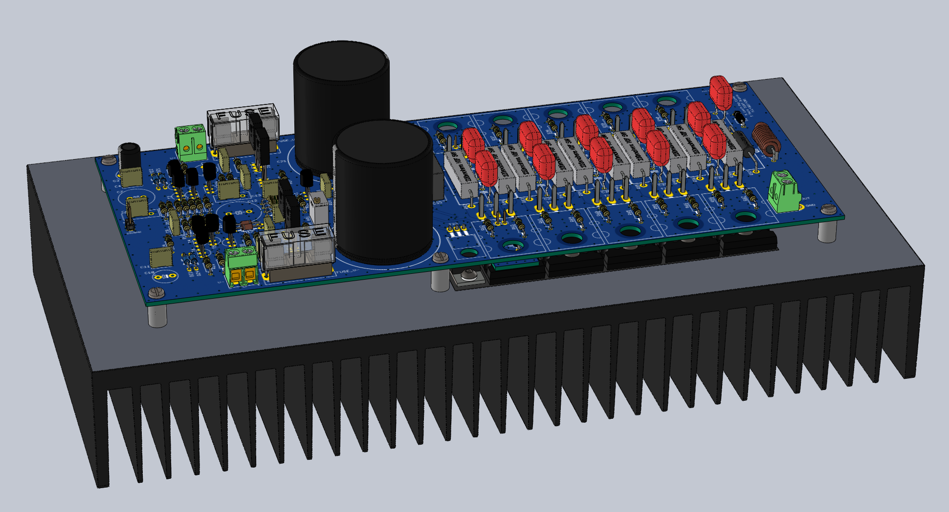

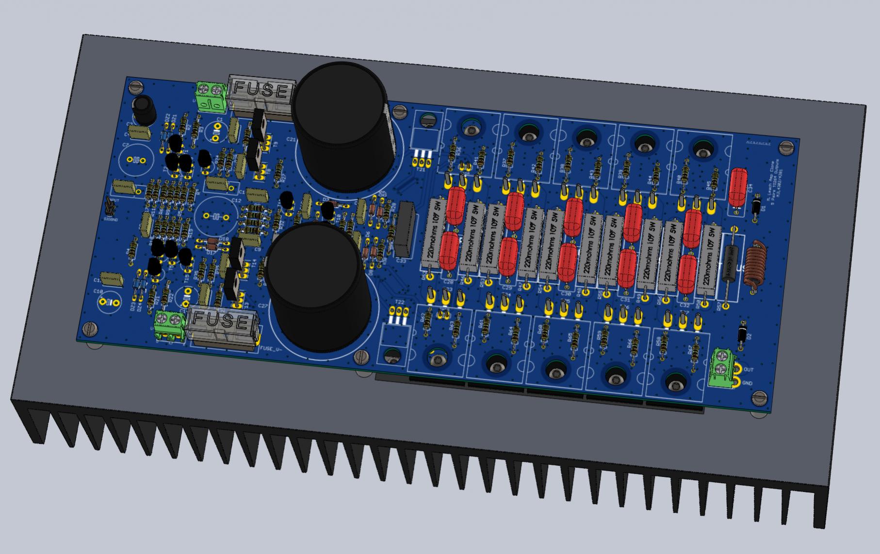

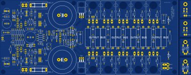

Here is one of my Jens based variants, for a 5 output pairs, with the thermal sensing board changes that I've been tweaking to improve.
I'm still using eagle v6.1, quite old, but works.
I'm posting this one because it's the only one so far that has been actually made by a board house, so the gerbers have been used and accepted by them.
Plus someone is working on building a few right now, and he's even sent me a few bare boards, which look super nice.
I didn't rewrite Jens' excellent build document, with the bunch of maths and all that, because although there were many tweaks and some changes made on this variant compared to his, it's still worth using his build info as a guide, because it still mostly applies.
Now as I mentioned, I also did some cad along with this, and I can post some more visuals next. This may be of interest to some amp builders who are mostly at a dead end wanting to build a leach designed by Jens but don't have original MCAD files to do more work on it and put out updated gerbers.

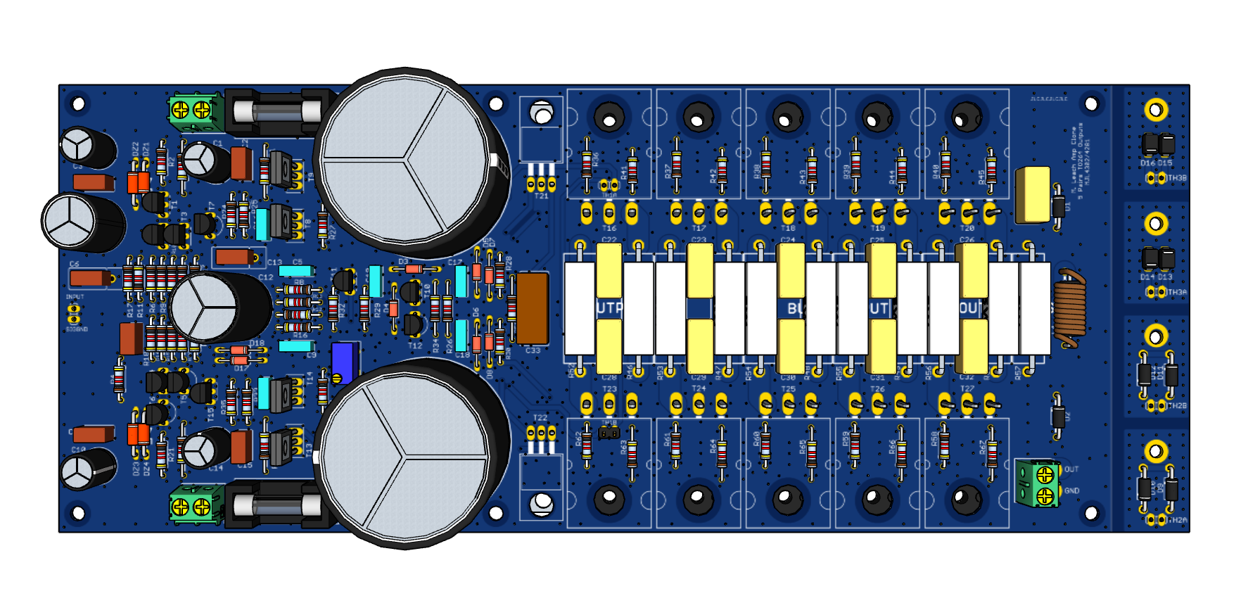

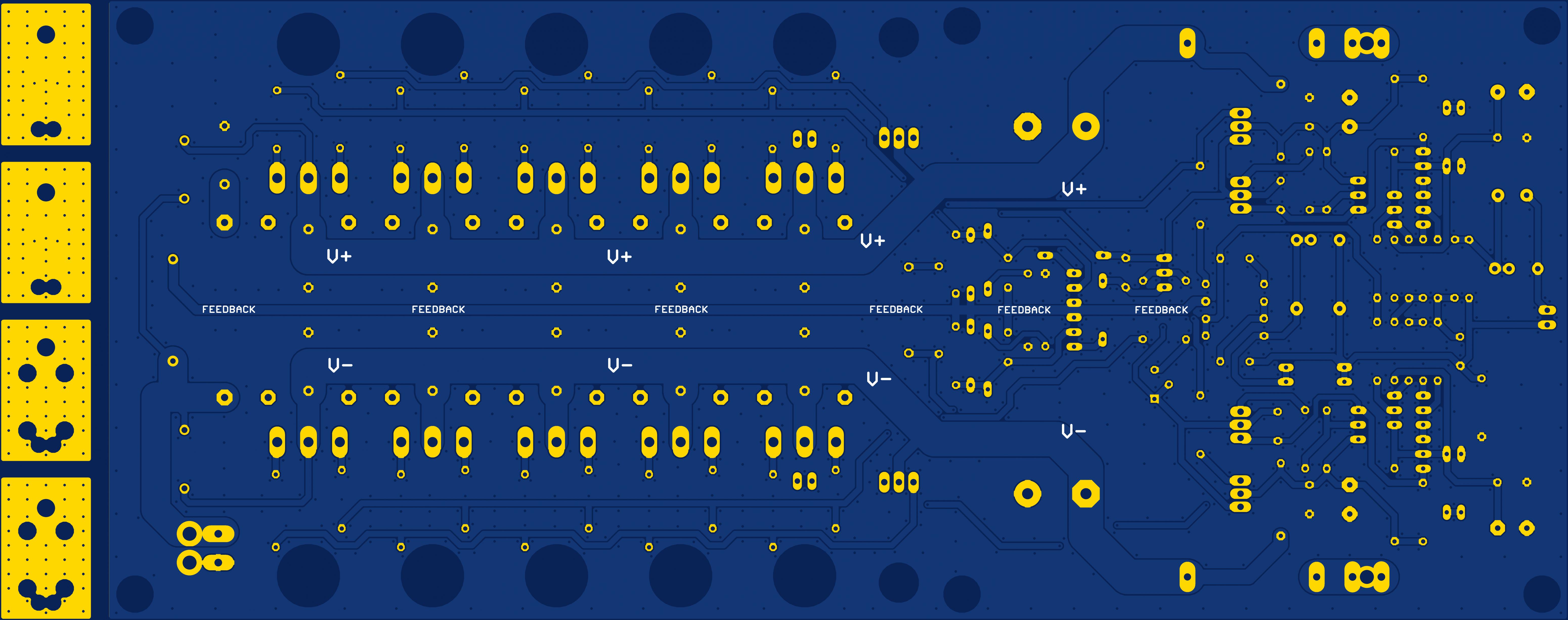

Going with my previous post, here are some more outputs for this leach build:
I had to compress (zip) one of the pdfs, because the file size exceeded the forum's limit.

I could take actual photos of the boards on hand, but they're basically the same as those visual outputs, except they're green instead of blue.

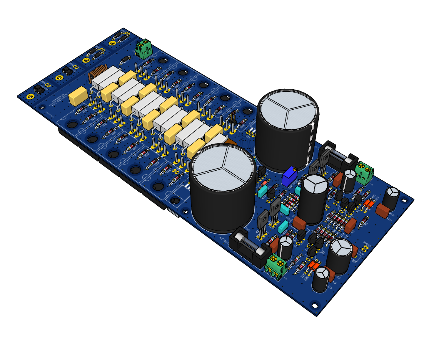

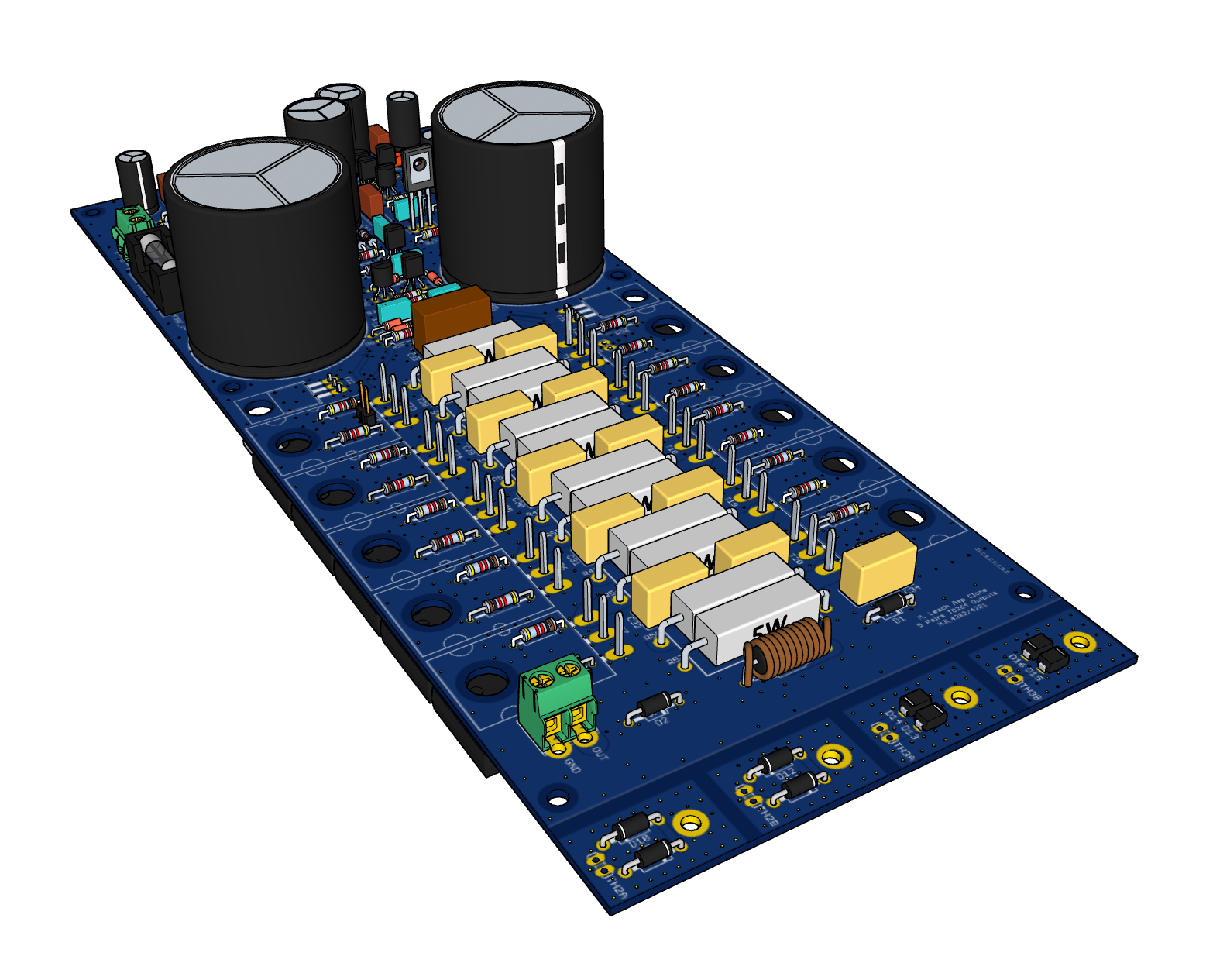

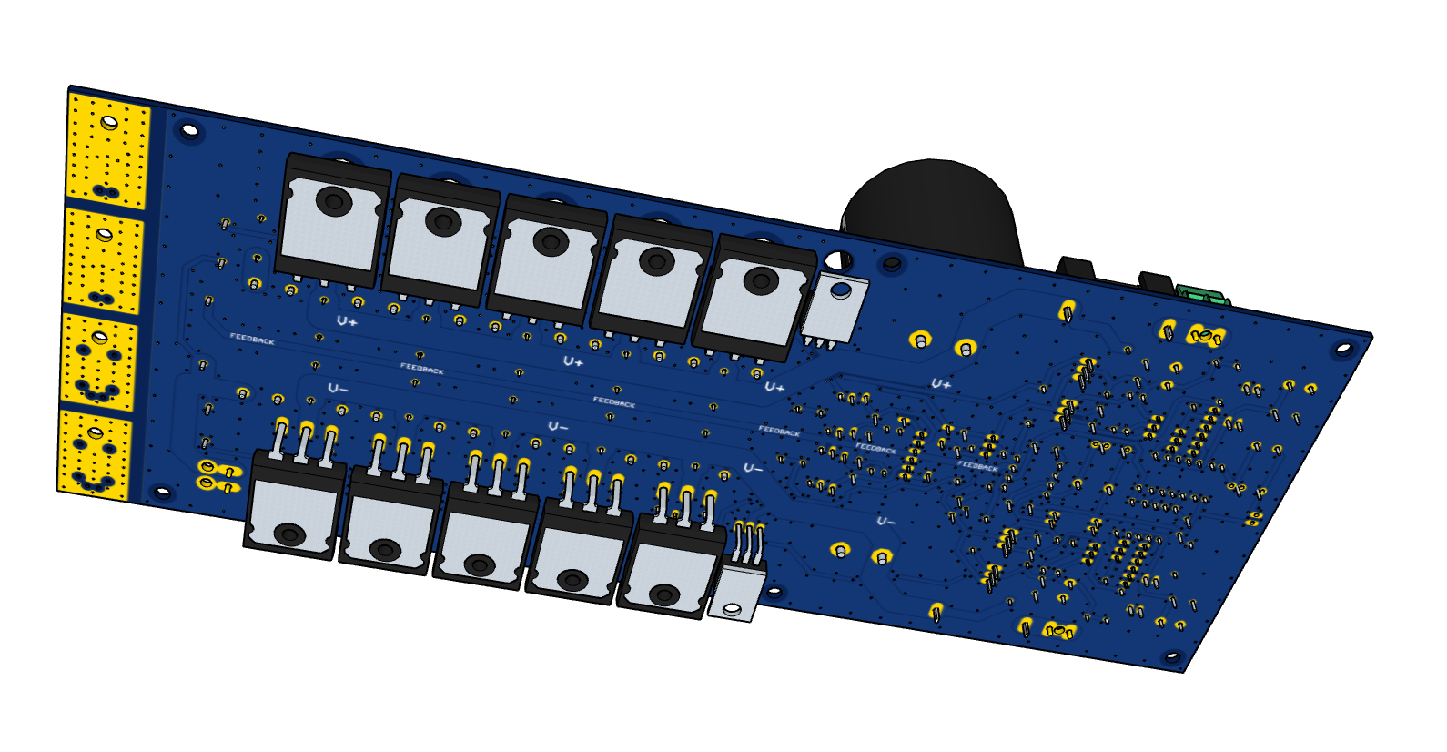

Here are a few more files for the build posted a few posts above.
The board is almost the same size as Jens' original, except for a tiny length difference due to the smaller different thermal sensing boards.
Although a few caps are missing in this assembly, here are a couple more 3D views from an assembly put on a Conrad Heatsink, which was used to make the 2D drawings with dimensions posted earlier.
