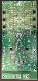

I still have Jens board too and that's a very sturdy/thick board. Does anybody have the build procedure for that amp? I might try to build it when I get a chance.
I don't remember a build procedure having been put together. Have you poked around the threads about it?
Which version is it? There were several.
Jens always preferred thicker boards with much thicker copper, such as 3oz.
How thick is that board?
I saved a lot of info about most of that stuff and have re-created the 5 pairs version layout, since Jens never wanted to share the eagle files. So I guess it should be pretty straightforward to put out gerbers and make more of that version if some wanted it.

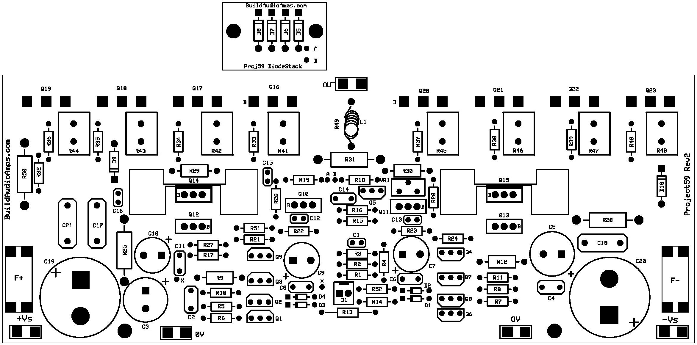

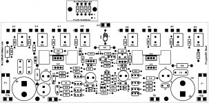

I found this leach at buildaudioamps.com project 59. it utilizes 8 output devices.
Link is here.
Project 59 – BuildAudioAmps
I believe the guy is a member here.
