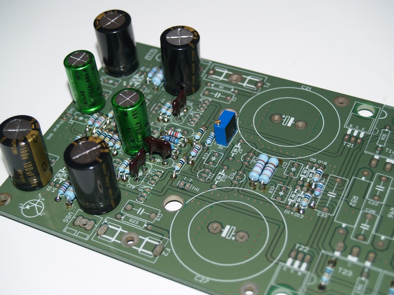

Hello forum,
It been a very long time that i had bought the 10 version transistor - Leach Amplifier from Jens / Delta Audio (that time).
Now i try to get the components for the amplifier as on the pdf manual.
Since now i choose metal film Beayschlag Resistors (both for 0.6 and 1W) and Nichicon KZ & ES for the electrolytic capacitors.
Now i'm searching about the emmiter resistors 0R47/5W and i would like to ask if someone have any experience of Mills MRA-5 and Ohmite Audio Series ?
Any other suggestion for those resistors?
Thanks a lot!
Regards.
P.S. Because i was now following the subject for years, is there any change at the components list for the 10 transistor version ?

I used the Mills resistors in my first set of Leach boards and was extremely pleased with them. I am not overly critical of components if they in some way work.
My set of Leach amps is better than any commercial offering I have ever owned. You will be extremely pleased with the outcome. Be very careful dialing in the the pots on each leg of each channel and the bass will just come alive.
I have several sets of these boards up and running and a pair of twelve output boards which have not made it yet.
Shop wisely for components and you can get some very good deals. I chose to use the Rifa film caps in my amp and like them very much. I could not fit the Dale resistors in the holes on the board and used whatever Mouser had in that range.
Build a very robust power supply and it will serve you for many many years.
Tad
