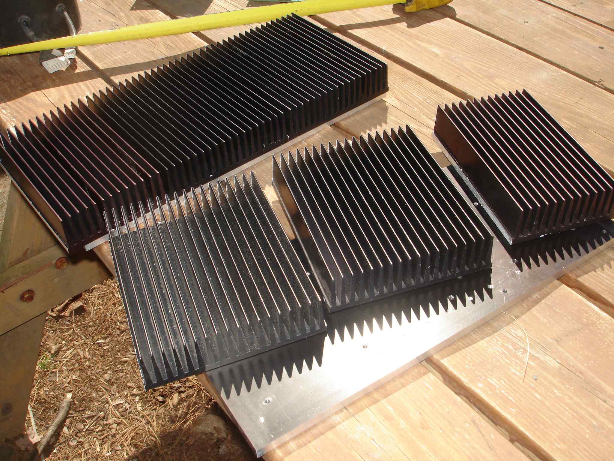

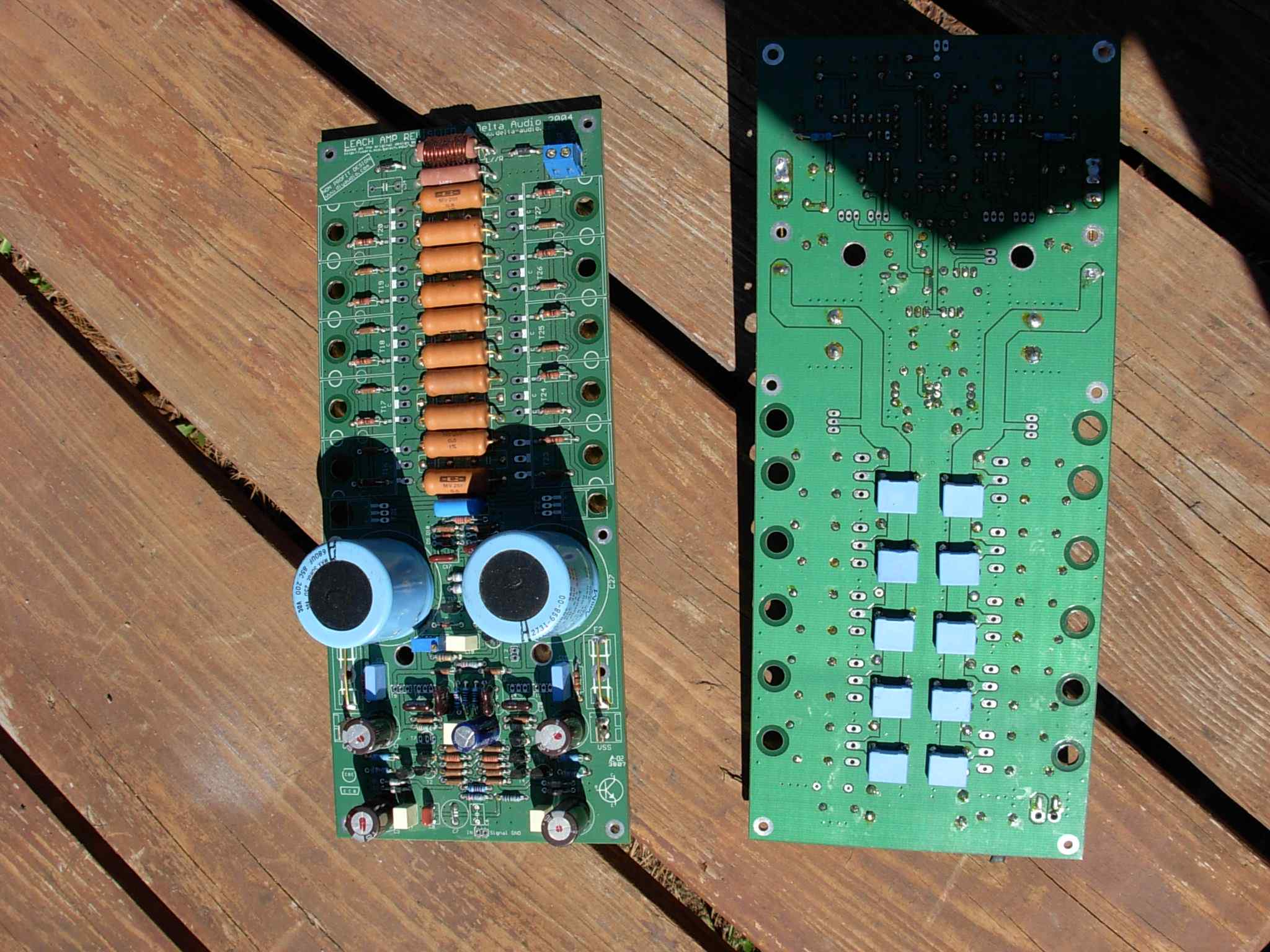

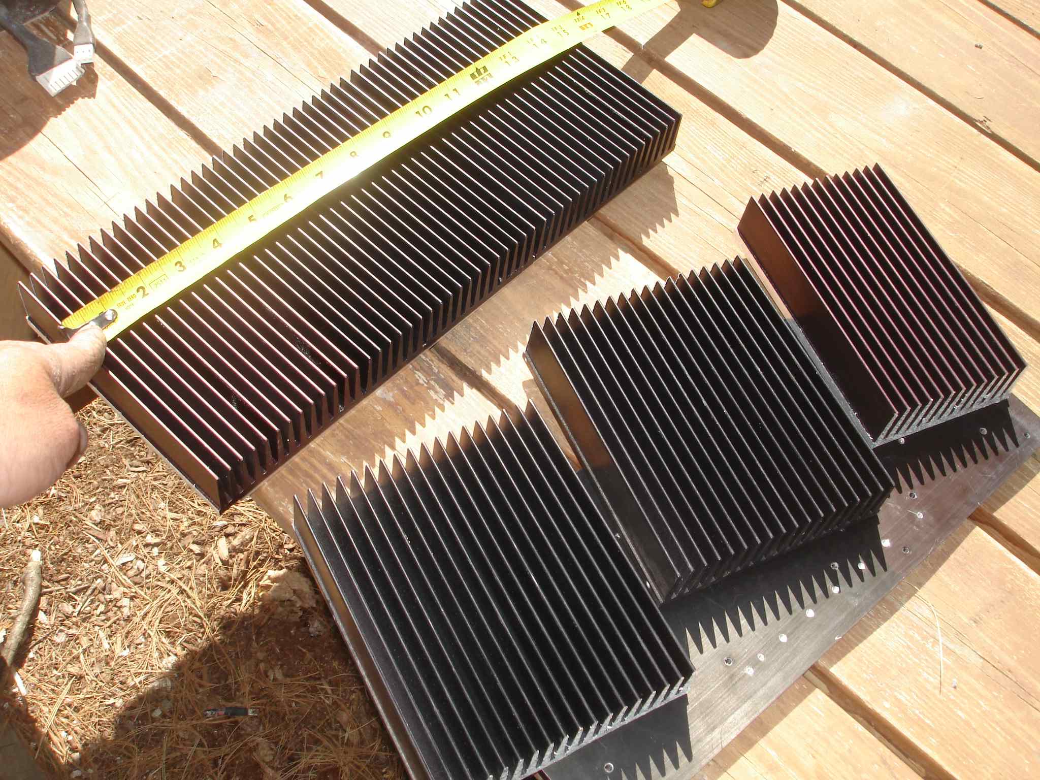

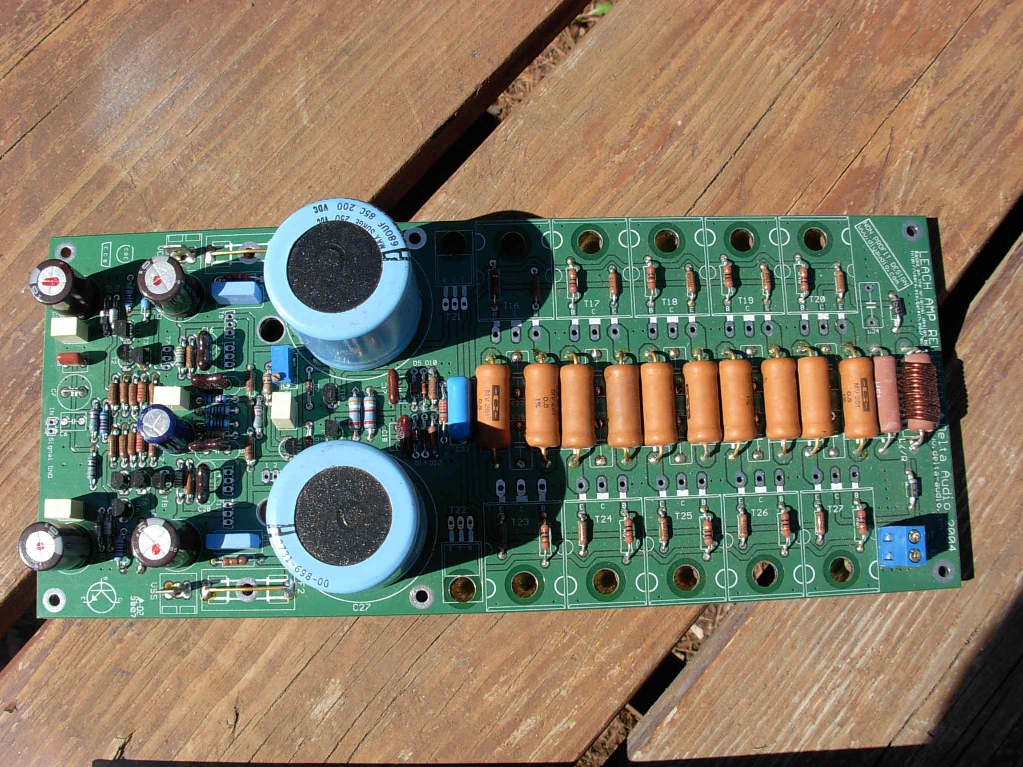

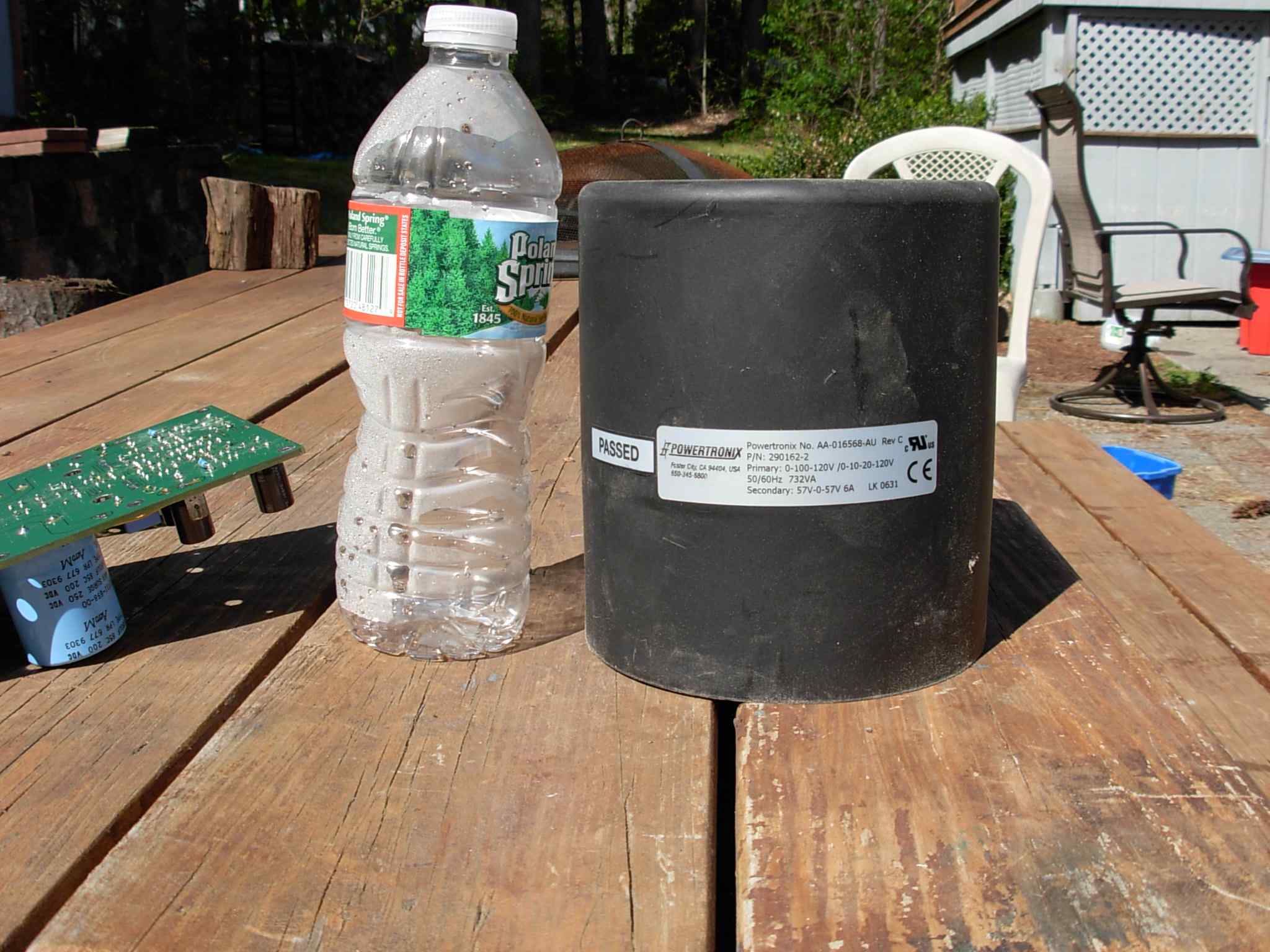

Been a long time since I've been on here. Hi to any I've missed.
Anyway, I recall drilling and tapping heatseanks for this very amp. It was at that time I realized I had an injury and could go no further. A couple years (!) later when I was feeling better I found new interests.
I just unearthed a box in the garage. Within is a set of partially completed Leach 10 transistor boards, A nice Mark Levinson (by powertronix) fully potted transformer, the heatsinks I was going to use, and some ON outputs new in the tube (got to through them)
I have no intententions to finish this and was going to stick the whole thing on ebay - but figured I'd pop in here first. Any interest?
