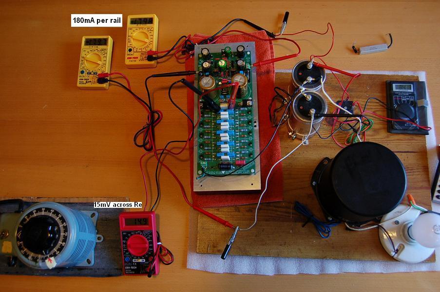

Testing Rasmussen-Leach board assemblies
Hi All.
After an unsuccessful search, I now am wondering if there is a need for another thread devoted to testing and trouble-shooting these Rasmussen-Leach PCB assemblies? Or does anyone here know of another thread devoted to sorting out these assemblies?
Below is a pic of one possible test setup, where we used a variac to adjust voltage, light bulb to current limit, and several cheap ($2 @ HarborFreight) DVM's to monitor everything. I like this, as we can see operating voltages/currents instantaneously, as we adjust settings...
-Chas

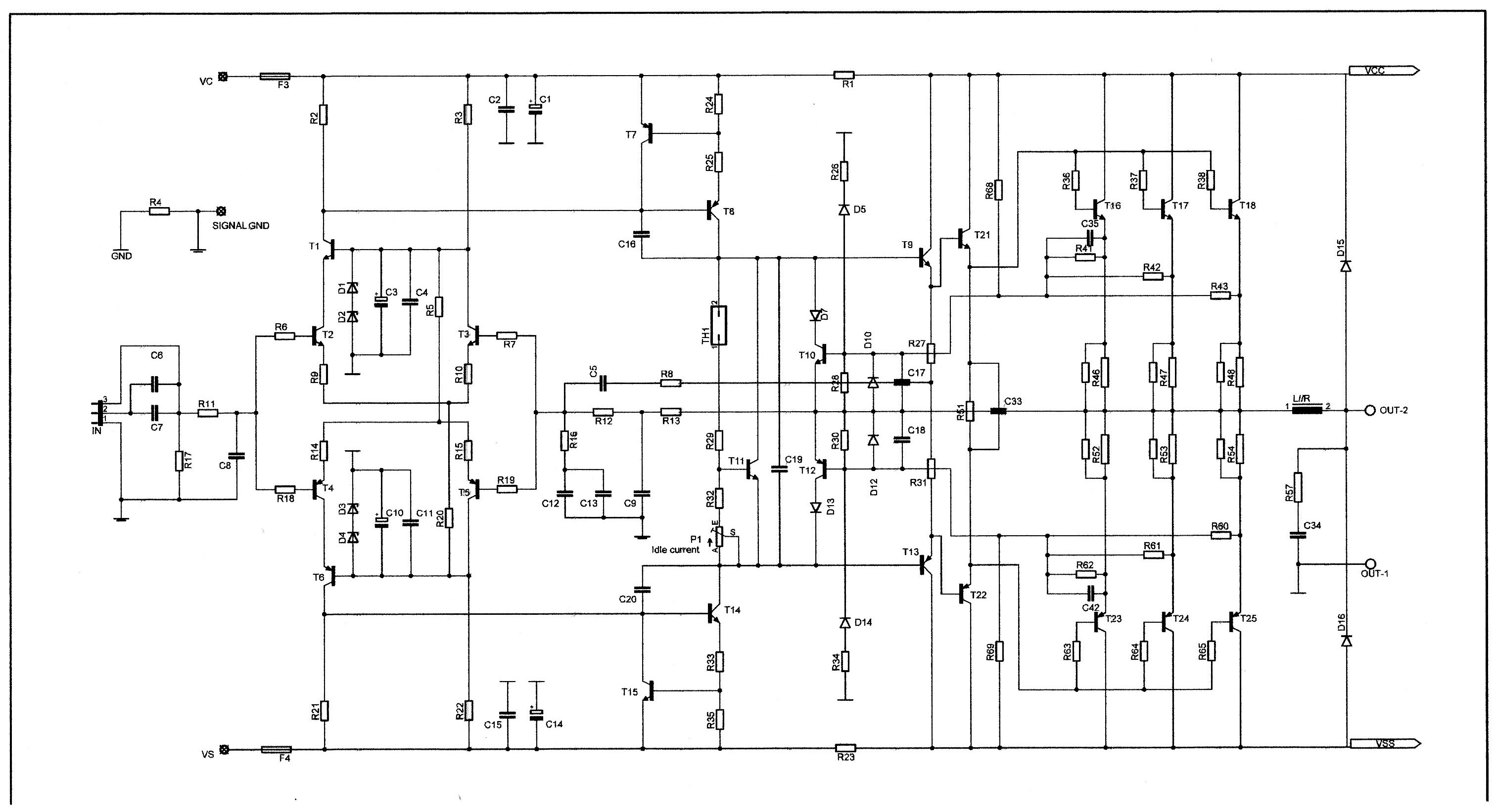

Regulation/separate supplies for 3 amplifier stages
I have an interest in providing separate supplies to the stages
of Jen's Leach amp and regulating the input stage.
Is it worth doing if I have the available supply rails?
I have transformer with taps at 32.5vac, 37vac and 40vac.
For the lower voltage tap I have a suitable 40vdc regulator
(which accepts 32-35vac) to replace the Zener supply.
When rectified and filtered the other taps provide 52-0-52vdc
@1.5A and 56-0-56vdc @3.2A,respectively.
How can these voltages be used to provide separate and stable
individual voltage supplies to each stage with Jens Board?
At what points in the diagram and where on the boards
should the VCC and VSS traces be cut to do this?
TIA,
-Chas
Vc is the second power supply. Vcc supplies both ends via the fuse then R1 to the front end. Simply omit r1 and you have a twin power input.
If you read Jens' description, he tells you all.
32.5Vac is a bit low for regulated 40Vdc.
I suggest you use the 37Vac tapping and get a regulator that can accept 37+20% Vac as the maximum input voltage.
Note that the VAS is connected to Vc and Vs when you remove R1 and R23. If you limit your front end to 40V, you won't be able to swing full output rail voltage. Not that you'll hurt anything, but you will waste energy in the outputs and limit your output voltage swing.
Your best bet is to have the regulated front end voltage approximately the same as the output voltage, maybe a volt or two higher.
You can separate the VAS if you really want to by cutting traces to isolate T7 and R24 as well as T15 and R35. You'd probably want to add local decoupling (like C1, 2,14 and 15). Seems like an awful lot of trouble for minimal gain.
BTW, your transformer is a bit light unless it's just for one channel. You'll probably be OK for "normal home use" - maybe a few watts RMS output, but you won't be able to drive full power for long.
