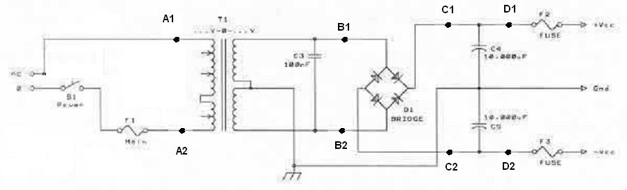

Use of current limiter vs delay relay...
I'm embarassed to admit I'm still confused.
There seems to be a lot of differing opinions as to where to put the thermistors(most posts relate to tube amps, Class-A amps, etc.); I did read that the constantly changing current demands of a Class AB amp may not be enough to keep the thermistor hot (and therefore its resistance low). Many recommend a delay relay (extra circuitry which I 'd like to avoid).
At the risk of sounding a bit daft
, I'd like to ask:
where (exactly) should one locate these in a 100-200W Leach Class AB amp with a "basic" power supply(if at all)? Pros & cons?
I've attached a diagram of a typical "basic" power supply*, showing several possible installation points.
THANKS! And Happy New Year to all!
-Chas
*courtesy of TNT audio's website
OK, I got the CL-30's from Mouser.Try CL30 for current limiting. It's 2R5 cold and 0R34 at 2 amps. One per rail - driving both channels should work well.

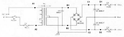

-Chas
