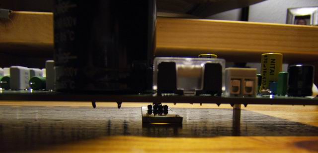

thermal track pcb
I noticed that the Thermal tracking diode PCB's in this latest group buy are plated thru-hole to unmasked pads on the bottom side.
As seen in the PCB photo on Jens' Delta-Audio website, the pads should have been omitted. These bottom side pads can short out to the heatsink when mounted.
So, best way to remove the pad? Take Exacto knife and scrape 'em off, or hit it with a hot iron until the pads lift?
The first batch of boards did not have pads on the bottom of the diode boards. It sounds like a manufacturing error since Tad just reordered - the first I've heard of from Advanced. Maybe they'll give us a break on the next buy.
I'll grind the pads off with a Dremel. If you have a sheet of mica or some Kapton tape, you can just insulate them.
