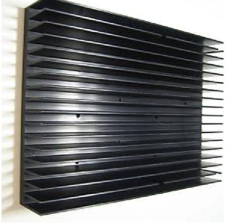

Hello all.
I was wondering if anyone here would be interested in a group buy for some nice, new black anodized heat sinks.
I've located some nice ones, measuring 5.25"Wx7.5"Hx1.25"deep(fins are >1" long).
One could use a pair of these , side by side for each channel of a 100-120W Leach amp...
The cost will be approx $8 each, so around $32 for a stereo amp, plus postage.
If anyone is interested, please send me a private message.

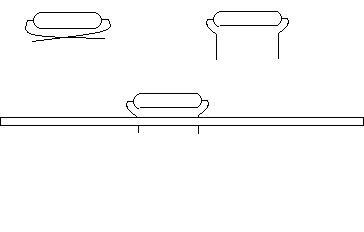

kraljmatjaz,
I'm using the same PRP resistors. Just bend the leads under, then down to fit (see illustration). IMHO, these(and the Holco's) are better sounding resistors than the small generic metal films I've found.
Just be careful to use fine needlenose pliers or a lead bending jig to avoid stressing the leads where they attach(especially with the original Holco units).
