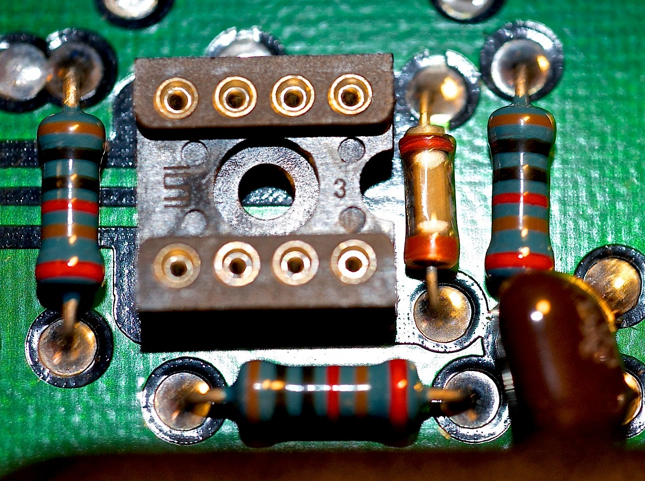

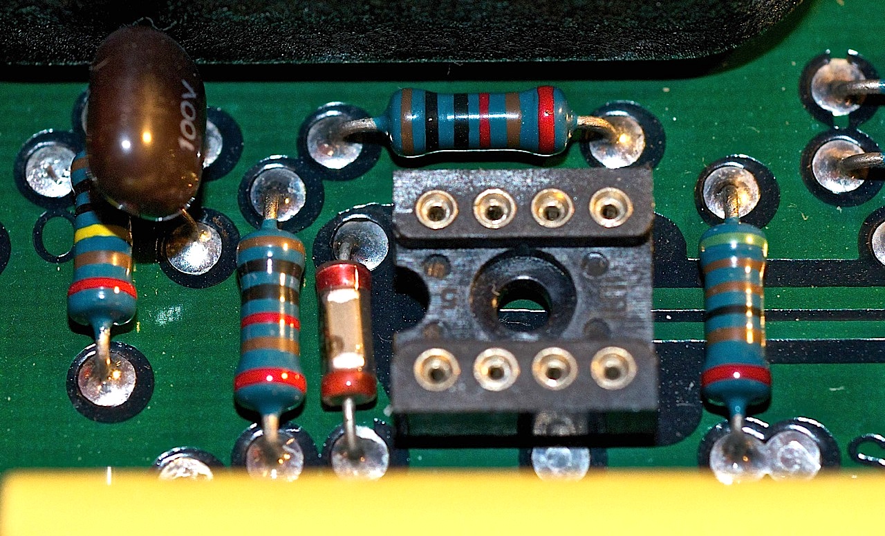

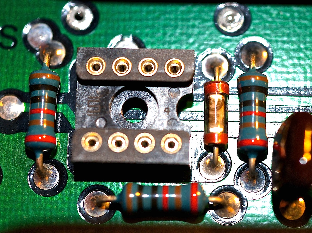

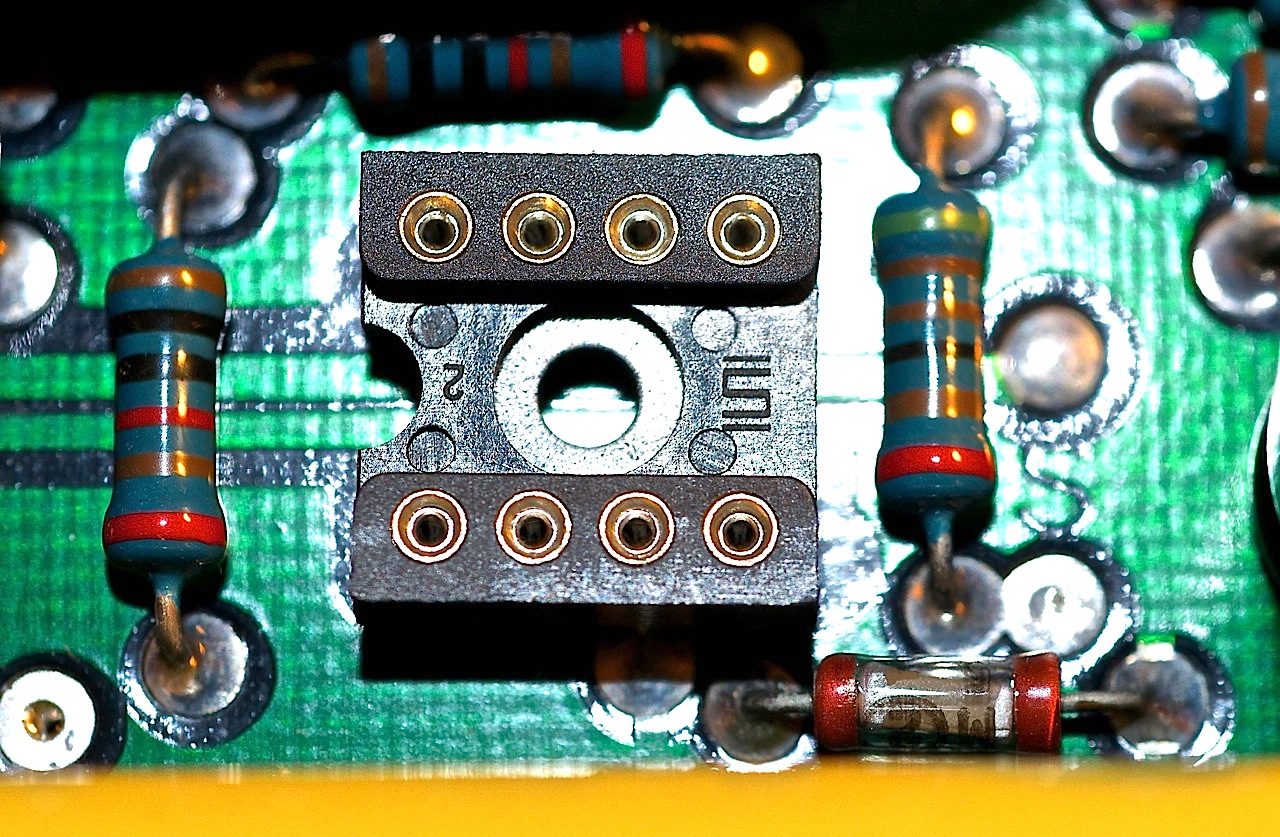

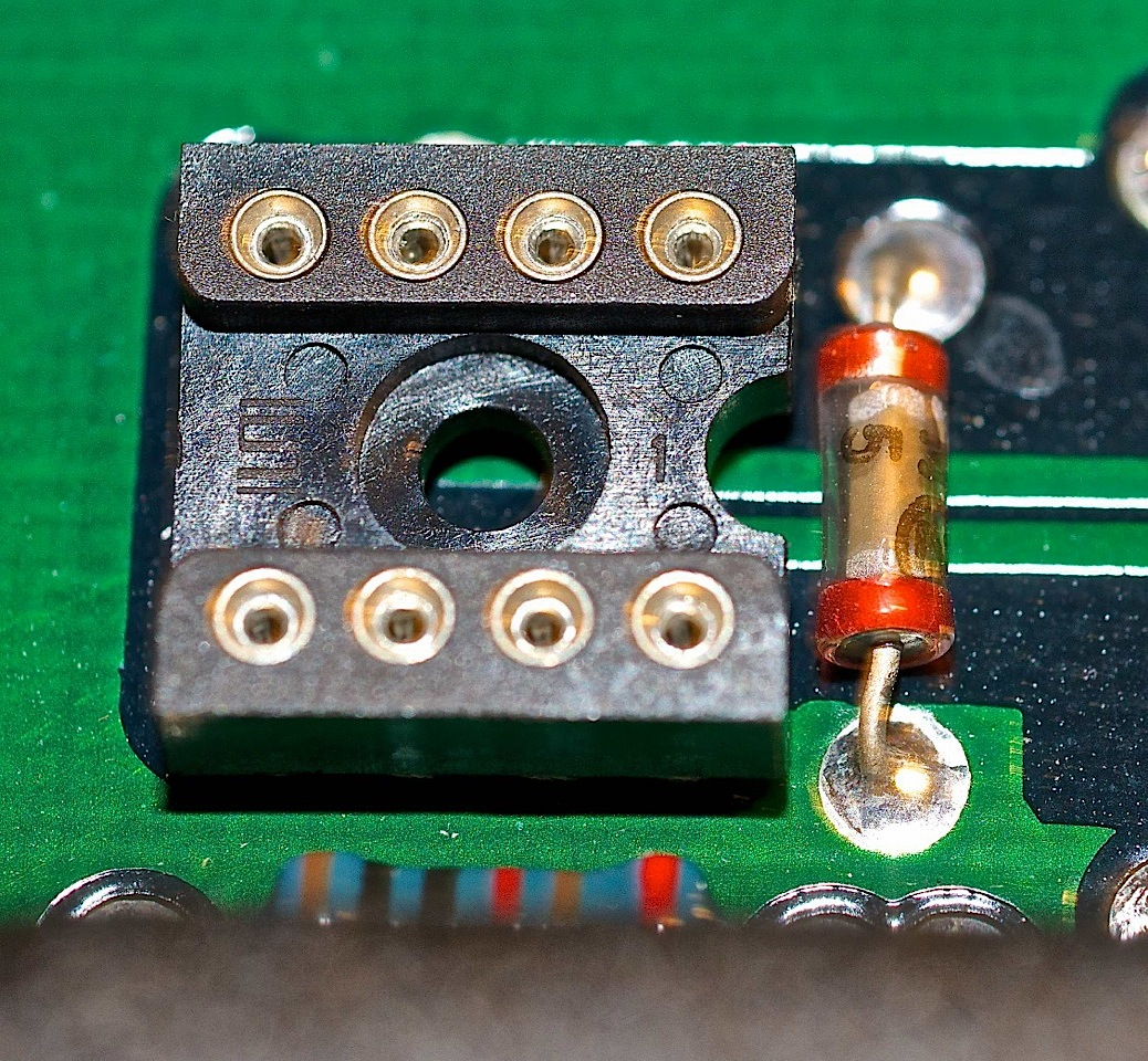

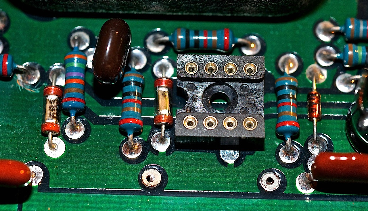

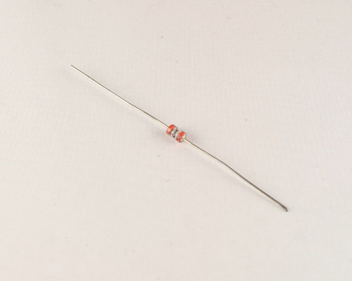

this unknown part is to see at second picture from post #2, main PCB left corner, in front of "PHONO AMP HIGH LEVEL" - module resp. left hand from DIP-8 socket.0.1 uf cap?
0.1 uf cap?
high resolution pictures in the attachement.

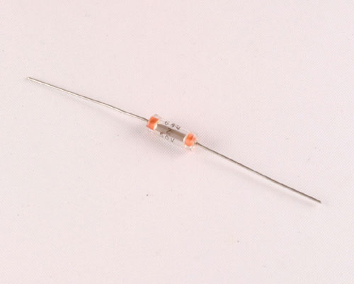

Yes, it is a chip SMD capacitor like
http://de.farnell.com/jsp/displayPr...ductlistings&gclid=CMa3xMm9srwCFYjLtAodB2AA6g
in a vitreous envelope, maybe for military and aerospace applications.
Who know the manufacturer?
CC1206KRX7R9BB104 - YAGEO (PHYCOMP) - KONDENSATOR 100000PF 50V | Farnell Deutschland

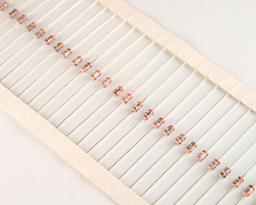

according
Unitrode UICC
and
Unitrode Distributor - 4 Star Electronics
the Trademark "U" is Unitrode UICC
examples as offer
684 = 0,68µF
CGF684ZDZ UNITRODE 0.68uF 50V Ceramic Monolithic Axial capacitor 2020022399
560 = 56pF
CGB561JDN UNITRODE 560pF 50V Ceramic Monolithic Axial capacitor 2020022373
CGB560JDN UNITRODE 56pF 50V Ceramic Monolithic Axial capacitor 2020022370
who can upload a datasheet ?

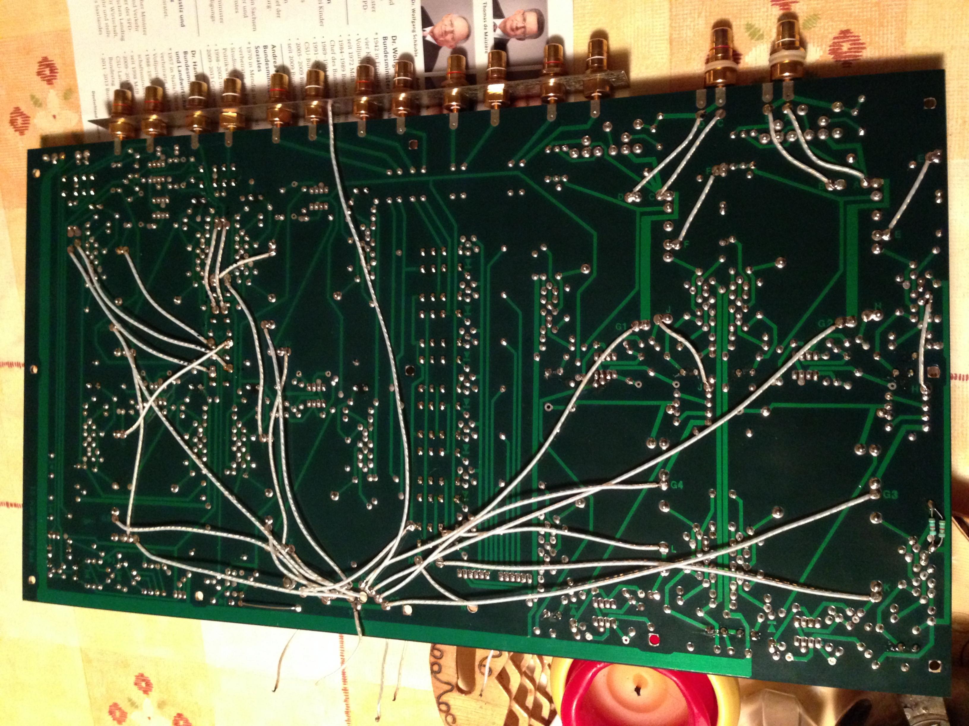

Last picture shows the PCB from solder site.

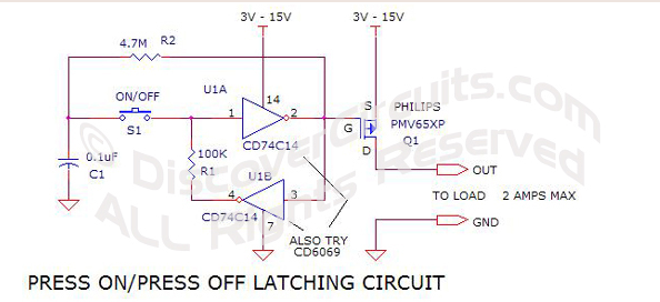

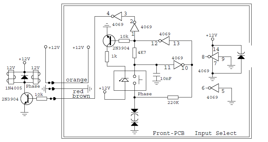

tiefbassuebertr. I simplified your schematic by white'ing-out the NU [not used] DC servo circuits; since they do not affect operation. An outstanding question maybe: What is the DC offset at the preamp outputs?. Noting that the Tuner, Tape and CD outputs from the equipment of other makers are probably capacitor-coupled to the input ports of this preamp. Maybe all that was needed to remove DC offsets was the one DC servo seen in the general schematic of the JR power amp; in the absence of an input coupling cap.It is a MIL specified capacitor from the 1980's. See data sheet:
I wonder why he used two CD4069 hex inverter ICs, instead of one CD4027 dual JK flipflop IC?... he is making a T-flipflop (push on, push off) out of CD4069 CMOS inverters ...
Both chips are in my 1983 RCA CMOS databook, so they were both available in ~1989 when the preamp was designed. Today the two chips sell for the same price; in 1989 I suspect their prices were very close as well. The JK flipflop implementation requires one fewer passive component than the hex inverter implementation, so it wasn't external parts count/cost either. Maybe he farmed out that little piece of design work ("eww! it's digital! yuck!") to a summer intern or something.

Thank you very much for this informations and imagesIt is a MIL specified capacitor from the 1980's. See data sheet:

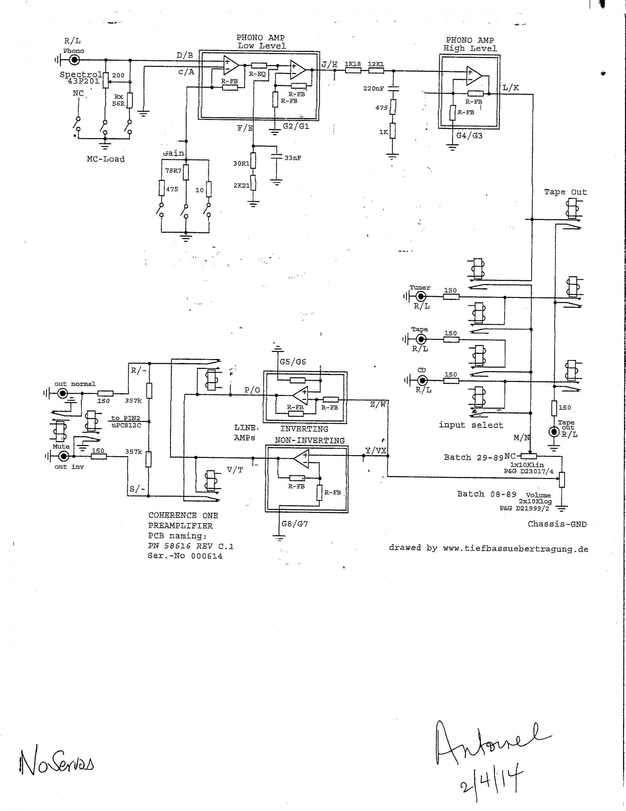

new questions are rises up. There are for each channel an inverted modul (for the invert output) and a non inverted modul (for the normal output). Additional there is a function-button (pushbotton) on the face plate, that is call "Phase REV".
This works effectively at both kind of outputs (i. e. at both line amp modules). I see no advantages for this approach at first look.
What purpose is to be fulfilled by this phase toggle switch ?

Last updates - schematics now finished, so I think.
In case of the phase mode select (normal and reverse) I note some trouble concerning the current flows (quiescent/idle current) by the modules used in the left channel:
1) a. The inverting LINE AMP current flow is correct in the position "PHASE REVERSE ON" (+/-45,7mA) and
1) b. The non inverting LINE AMP current flow is correct in the position "PHASE REVERSE OFF" (+ 44,9mA and - 45,1mA)
2) a. The inverting LINE AMP current flow isn't correct in the position "PHASE REVERSE OFF" (+33,5mA and - 95,5mA | associated module runs hot).
2) b. The non inverting LINE AMP current flow isn't correct in the position "PHASE REVERSE ON" (+ 33,3mA and - 93,3mA | associated module runs hot).
Mixing up resp. interchanging cross the modules from left channel to right channel and vise versa brought clarity about the fact, that the error is not coming from the modules itself.
