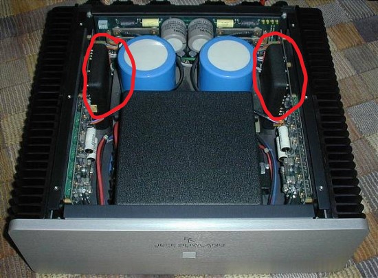

Hi all,
can I still find available the resin-coated modules for the JR model 1power amplifier?
I'm afraid one of these has some problems.
Thanks.

Mr Rowland has new modules available now. You could upgrade. I think Stereophile did a follow-up on the new modules.
Since he’s selling some as upgrades, he may have some old, working modules if you’re trying to save some money. I know mine were working when he replaced them.
Jeff

I'd like to understand if you are referring to the availability of the power amplifier model 1 driver modules.
The problem is that I don't live in the States but in Italy and I don't want to send the power amplifier at Colorado or entrust it to the assistance of the national importer but I prefer to do the work myself.
I know that Mr. Rowland intervenes very little in the forum for this I need precise information on the availability of the 2 driver modules.
Thanks.

I think it cost $450 for the upgrade of both modules. I was able to drop it off at the factory since I live close by.
To make sure we are talking about the same thing, here's a picture of the Model 1 and I've circled the modules I'm talking about.

Could you please do a simple check on your model?
Could you measure the temperature of both channels measured on the heatsinks in several points of the same?
I can't find an owner who currently owns this power amp. 😡
Many thanks.
It might take a bit, as it is in storage right now. I can take the temps, but it may not help you troubleshoot if the bias is not set to the same value. I can check the bias values and let you know what those are too.

After a long search, Mr. Jeff Rowland has now found the circuit diagrams of the modules and kindly sent them to me as a PDF.
After study the topology it is completely clear to me that the not potted line-level replacement modules with the AD746 cannot provide the same sound quality resp. sonic character than the genuine discrete modules.
From the genuine potted line-level modules I note, that the version for inverted mode sounds even a bit better than the non inverted mode.
I carried out the comparison by a listening test in a non symmetrical operating mode (power amp with cinch/RCA input) at a Aleph 4 from Pass Labs.
The reason therefore also explains the circuit topology:
The inverted line level module consist of only one inverted voltage gain stage (folded cascode consist of two single cascode configuration) which is buffered by a BjT Sziklai-Darlington.
