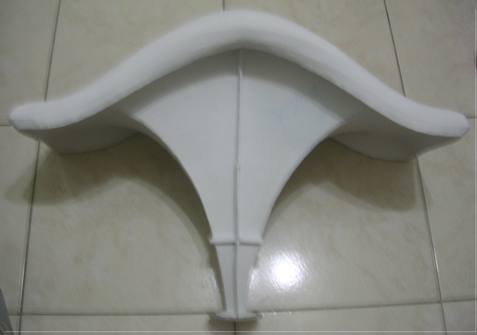

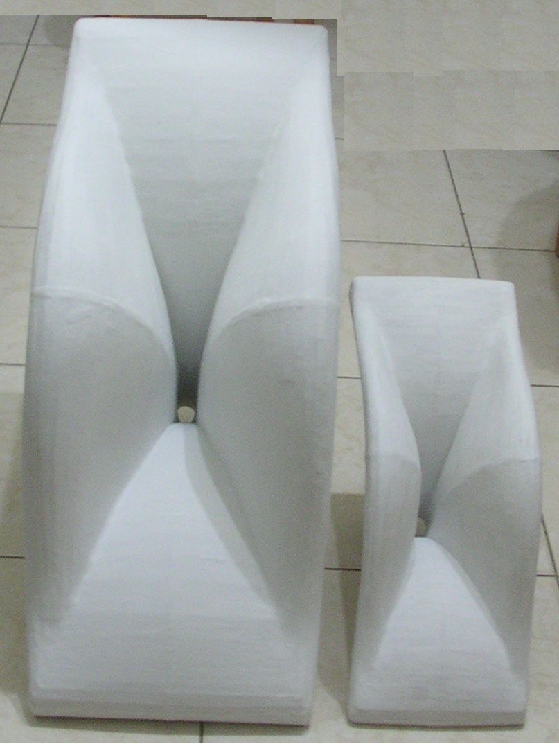

Hi Jean-Louis,
The constructing steps are very simple.
A round horn can be approximated by a set of conical segments.
A JMLC type horn, with equal wall length at every direction,
can be decomposed to small pieces like a round horn.
I write a procedure to do this, and print it out by a CAD tool.
Constructing begins from throat. Stick the small pieces by twin-adhesive,
two layers overlapped, and glue the gap between pieces.
But I don't think this is a good method for a large horn.
Without any mold or scaffold, it is difficult to construct precisely.
And vibration will be a big problem, especially at throat.
Best regards,
Hsieh W.M.
320Hz rect horn,1 inch throat, T=1/sqrt(2)
751.2354mm(W)
283.2894mm(H)
461.9914mm(D)
xyzfile
360*119=42840 points,
Hsieh W.M.
