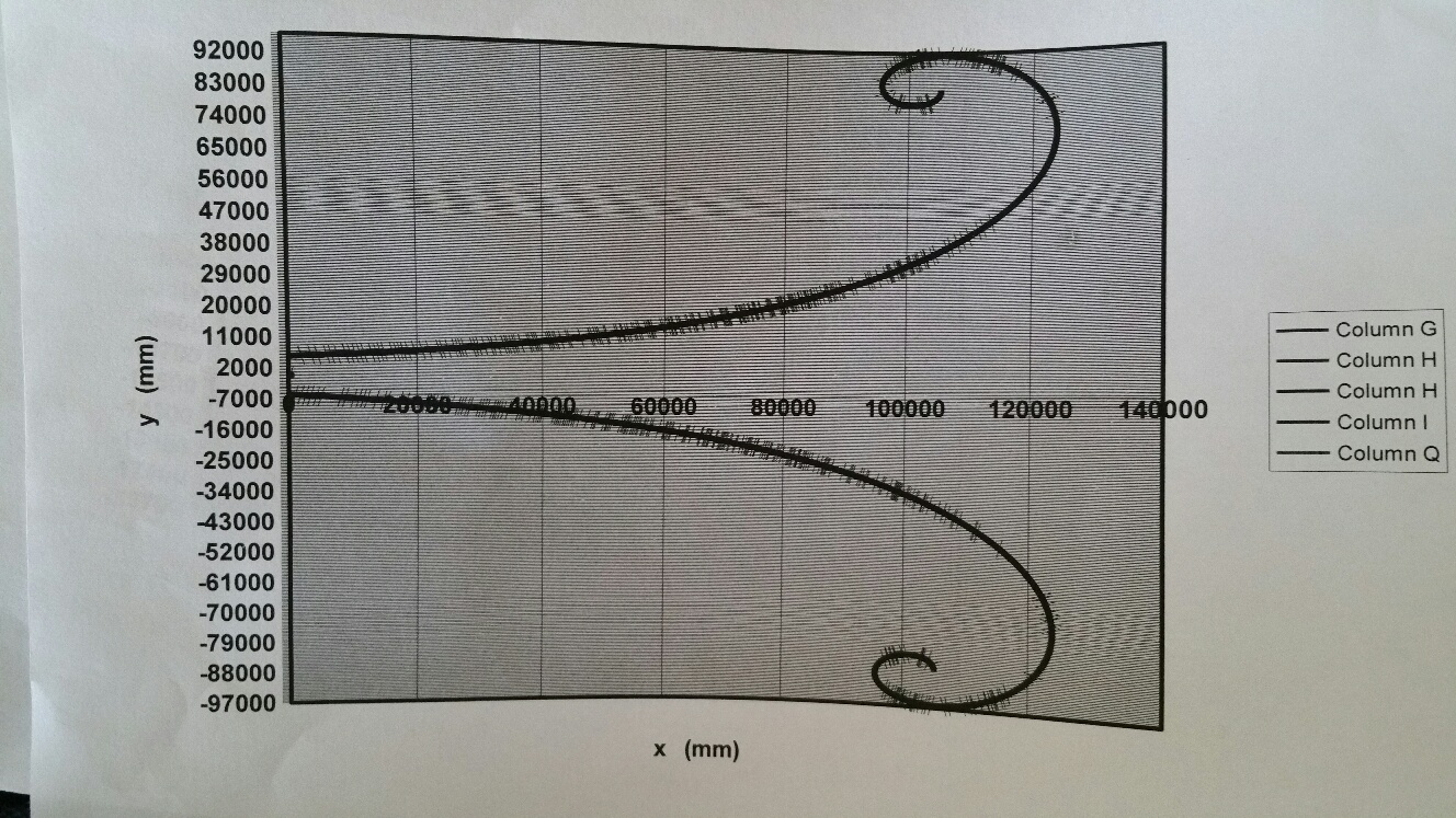

Here is one attempt at using the JMLC horn calculator. I like to avoid room absorbing fiberglass type traps and like the JMLC calculator. The room would be really large on some of the attempts I tried. I tried different flares with 31 to 37 feet throat width. Some of the widths were up to 600 feet wide. The dimensions are in mm.

Presumably for such a large horn and the natural roll off, to keep it flat to 20Hz this is going to be a potential Jericho moment. At least in a cathedral with its robustness, it can take infra sound energy levels. The whole medical impact of a large horn if driven by a powerful driver should be reviewed but presumably you have done so already.

I find the LeCleach responds best to a good width. Not easy to describe in few words but the horn seems to work to the sides and they represent effective length in what it gives, compared to other horns that seem to need actual physical length.
The amount of roundover seems more important than the cut-off or actual length. For a given mouth space in the room (I'm thinking a lower mid horn in this case) I'd suggest you try a higher cut-off that lets you take the mouth back to at least 135 degrees (for example). Directivity seems less variable. Group delay will have a significant bearing on where you cross it.
