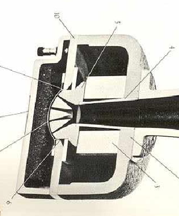

The tapered portion in the driver is very short. See attachment.

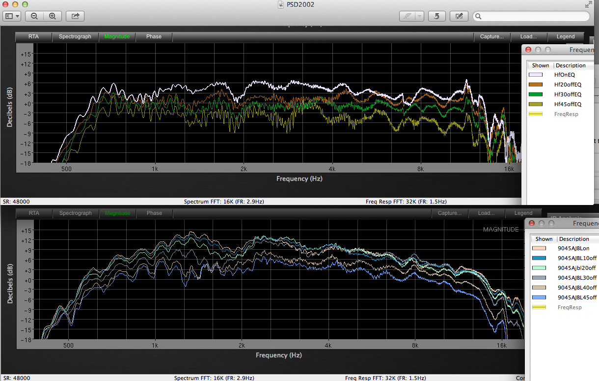

Having used the quadratic throat on 90 X 20 and 90 x 45 degree conical horns with both the Eminence PSD2002 "pancake" and old style long JBL 2420, HF dispersion was similar for either, the JBL maintaining -6 at 45 degree off at 10kHz, -8 at 16kHz.
The PSD 2002 has such ragged frequency response above 12 kHz it is a bit hard to discern HF dispersion, but had them laying around and wanted to make some tiny floor monitors...
Ensuring a perfect continuous profile between the compression driver and the horn seems to be far more important than the exit geometry of the driver.

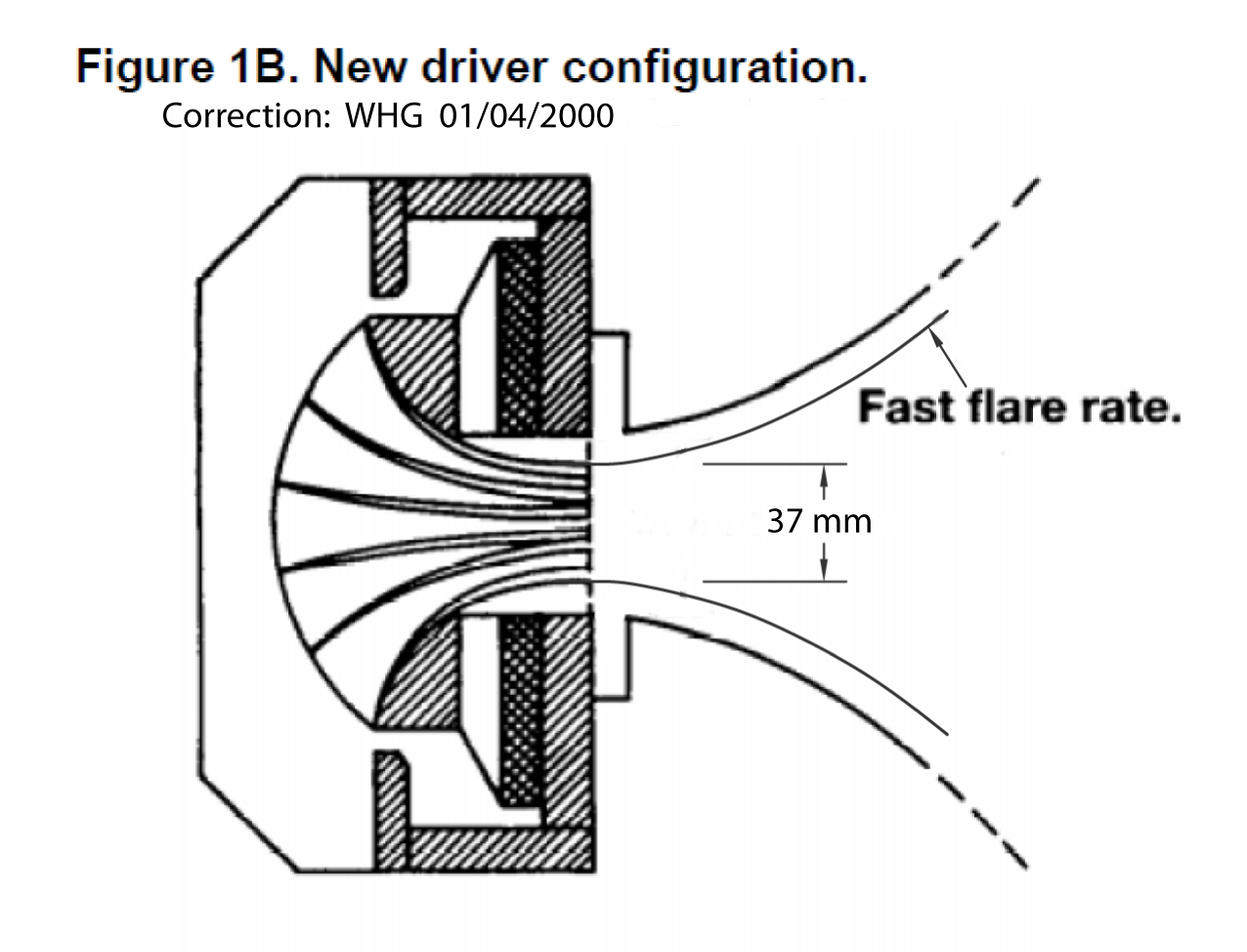

Correction
The driver section figures in the JBL specification [2] are incorrectly drawn. See attached figure [1] for the correction. The phase plug and driver exits coincide. The passage slope angle at that point is (t=0).
For optimum performance, try a Freehafer neck joined to a Le Cleac’h bell.
WHG
