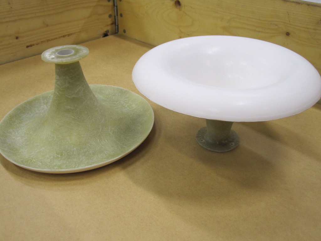

Joining edges of wood gramophone-style horns
I'm planning to build a gramophone-style horn out of bent wood (baltic birch or bending poplar ply) based on JMLC's spreadsheet. Does anyone have any creative ideas about joining wood edges of each petal? The only way I thought of doing it feasibly and tightly is by routing one side of each petal with a roundover bit so it ends up convex arch and the other side of each petal as a concave shape with the same radius. Does anyone have any other creative ideas about joining the edges of these complex shapes?

Technically the angle on the edge of the part changes constantly along its length. It's a constant angle looking at the front of the horn when the part is curved as it will be when assembled, so if you cut it at a constant angle when flat it will be wrong. However it might be close enough. Honestly it's probably easiest to make a thin part that you don't chamfer and then build up material on the outside of the horn.
Yes the included angle changes. The angle that is used for splitting the horn into petals should remain the same. That is the key to making this work. But it is possible to create a jig that will allow enough of a manipulation in the secondary reference flat to keep things going the way you want.
But there is a really simple reason why these horns are made of paper or card board. It is way easier. Consider laying it up in paper and then coating it with epoxy. Best of both worlds.
