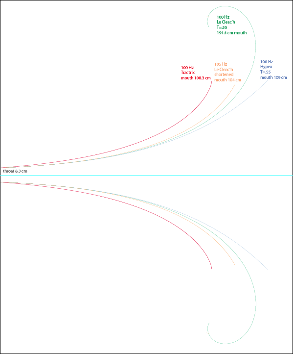

Shortened Large Le Cleac'h Horns?
Does anyone have any thoughts on shortening a Le Cleac'h horn to reduce mouth size? This may come across as a ridiculous question as I understand the benefit of the Le Cleac'h horn is the rolled back mouth flare that reduces waves reflecting back into the horn, but the size of a 100 Hz Le Cleac'h horn (almost 2 meters across) gets impossible to integrate with a multi-way horn setup while keeping everything in phase and avoiding a DSP to compensate. I graphed several curves (Tractrix, Le Cleac'h with T=.55, Hypex with T=.55, and a 105 Hz Le Cleac'h with shortened mouth, the circumference of which is equal to one 105 Hz wavelength. The shortened Le Cleac'h comes in somewhere between a Tractrix and Hypex. It looks like the new profile would have the throat impedance of the Hypex (T=.5). Would the shortened Le Cleac'h horn retain response down to flare frequency better than the Tractrix while reducing reflections closer to the mouth better than the Hypex?
Thoughts?
Thoughts?
You will loose the low frequency loading . And a fair bit of the directivity control that you are looking for. What you have shown graphically is no longer a LeCleach horn profile.
In short your back to a modified Hypex.
If you are seeking the advantages of a controlled directivity and good loading characteristics down to the horn Fc then you cannot really change the calculation to fit what you want. THere is reasoning behind all this stuff.

From what I understand, the response of the Hypex is fairly strong down to the flare frequency, so with this "modified Hypex" would the more aggressive mouth flare impact that response? How would it compare to the full 100 Hz Hypex in the illustration? Would it be better to go with the Hypex over the modified Hypex?

Your designing for a bass horn characteristic but expecting mid horn results. Take a look at the off axis response in Hornesp. That will give you a better idea of what is really happening.
For low frequencies it won't matter much - it's mostly length and mouth diameter. It's the higher frequencies that it will effect. I did some simulations where I truncated the roll back, and basically you need to have the mouth roll a bit past 90 degrees to the primary axis to get most of the benefits. For a horn that large, why not put it on the floor or on the floor in the corner and make a half or quarter horn, still keeping the roll back if you want it to go up to (relatively) higher frequencies?
Thanks for the response John - I'm looking for a range of 100-500 Hz where it will cross into a 320 Hz round tractrix (12db slope). I wouldn't think that range would be too difficult for the horn based on the Hypex simulations I did where it starts slowly dropping at 500 Hz. I understand that a square front 1/2 or 1/4 size horn can work when sitting on the floor, but I'm planning to build a round horn, and I'm assuming that the round mouth wouldn't load to the floor properly. Have you compared the large Le Cleac'h horn with a Hypex? In your simulations, does a 1/2 or 1/4 size Le Cleac'h with its compromises have benefits over a full size Expo or Hypex? Another option is a semicircle Le Cleac'h sitting on the floor...
What I meant was make a section of the a round horn, either half a horn or a quarter of a horn. Like this: http://www.6moons.com/industryfeatures/vsac20082/experience1.jpg
