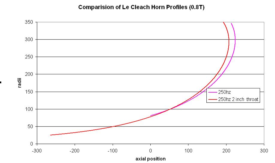

I am proposing to make some adaptors to reduce the throat of my 250Hz Le Cleach horns down from 160mm (for Lowther) down to 52mm for a 2" compression driver. When i used the Le Cleach calculator i have found that the profile does not simply extend backwards. Looking at the spreadsheet it looks as if the natural expansion routine it is using will give a different profile for every throat size. Attached is a graph showing how the profiles differ - what should i do, curve fit a profile "that smooth" from my current throat backwards or ?? suggestions please, as i dont know how sensitive the throat portion of the horn is.
i will be making flanged fibreglass extensions which will bolt on to the back of the existing horns.

For the math you need to do this, see my post
http://www.diyaudio.com/forums/multi-way/140190-jean-michel-lecleach-horns-119.html#post2686127
Do not worry about the wave front dimensions in the neck, just apply Salmon's formula using ordinal dimensions. You will be primarly concerned with the radii (dia/2) and tangent angles at the driver and horn exits between which your adapter is to be placed.
