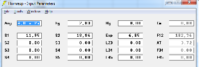

Hey M10,
Check your sim one more time!
You say the throat piece is 68,5mm but your faulty sim is done with 65mm length. Because of this you get the wrong flare and angles.
I found length was 69mm so no big difference.

You are absolutely right Revintage. I am a bit dissapointed that you didn't find the other mistake :). The sim calculates the throat angle, not the mouth angle.
Cutoff is 182 Hz. From the schematic diagram I export the horn data, and it gives the mouth angle. It is 4.67 degrees.

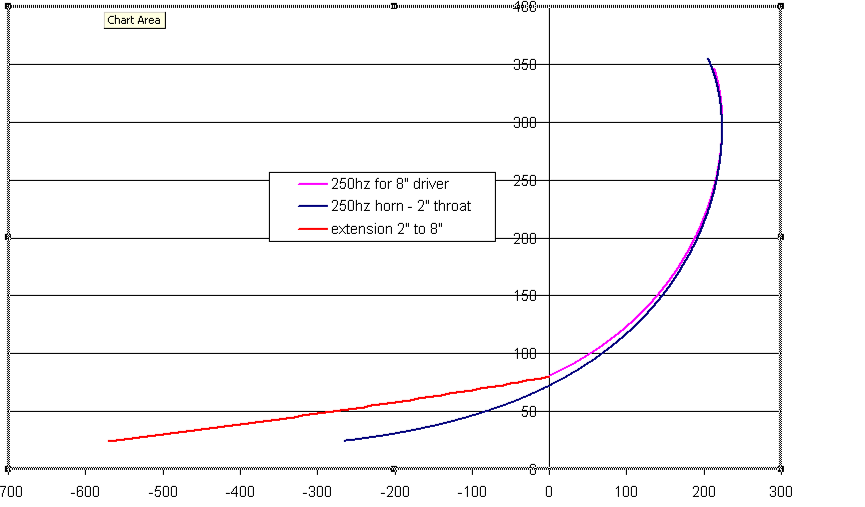

I am proposing to make some adaptors to reduce the throat of my 250Hz Le Cleach horns down from 160mm (for Lowther) down to 52mm for a 2" compression driver. When i used the Le Cleach calculator i have found that the profile does not simply extend backwards. Looking at the spreadsheet it looks as if the natural expansion routine it is using will give a different profile for every throat size. Attached is a graph showing how the profiles differ - what should i do, curve fit a profile "that smooth" from my current throat backwards or ?? suggestions please, as i dont know how sensitive the throat portion of the horn is.
i will be making flanged fibreglass extensions which will bolt on to the back of the existing horns.

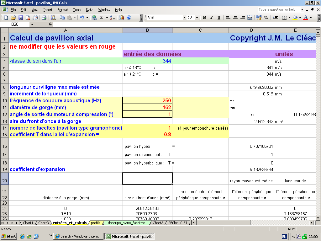

VnV,
Your adapter problem has been used as a test case for the horn adapter spreadsheet I developed recently. The attached MS/Word file documents dimensions of the adapter that you need. Unfortunately Excel files cannot be attached to messages here; so the formula used have been documented here as well. Comments as well as additions/corrections to this work are welcome.
WHG
N.B., due to the product of parameters m * T being fixed by driver exit diameter and flare slope, the required long adapter length and low fc should enhance LF loading of the horn.
  • JMLC-Adapt.doc
I have put the data provided into a plot - for comparison. To my uneducated eye it looks a little long, and out of family with Azura and other commercial JMLC horns. My experimentation with conical horns gave long results also.
I have been using curve fitting routines to back predict the existing horn, working out compression instead of expansion. To date all have a point of inflection around 100mm dia where the solution diverges.
Hello,
Often peole speak of a "Le Cléac'h horn profile". The under-meaning of that is that for a given T, a given Fc and various throat diameters the profiles of the obtained horns should share a common profile.
This is not the case, for the obvious reason that for a given distance to mouth, the wavefront shape will not be the same if the throat diameter is a, 2a or na...
So the problem to build an adapter for a Le Cléac'h horn of a given throat diameter in order to use a driver having a very smaller exit diameter is not a trivial one.
In some cases the adding of the adapter will introduce the profile slope twill loose 1st order or second order continuity and this is IMHO a bad thing.
The problem is a bit simpler if the axisymetric horn is calculated for the smaller throat diameter and then cut in order to provide a removable adapter (the wavefront on the membrane of a loudspeaker having a large diameter is lesss well defined also... )
Best regards from Paris, France
Jean-Michel Le Cléac'h
