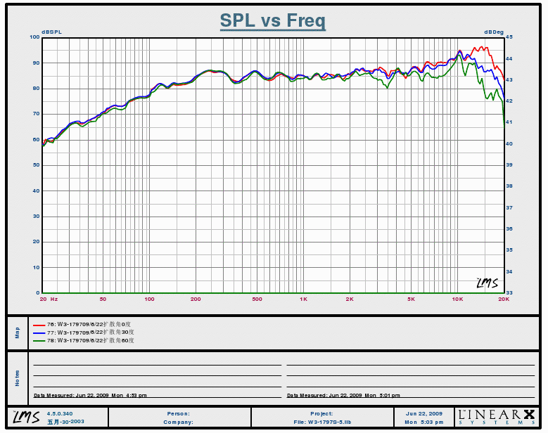

Tangband offers interesting flat units that resembles Balanced Mode Radiators: W3-1797S and W4-1757SB. Question is can we use modal transducer in a waveguide? I think we can if one chose right kind of pressure feed and loading that does not destroy disc balancing. Then we can use these inexpensive drivers with possible simple phase plug and full range with transmission line.
jzagaja said:Tangband offers interesting flat units that resembles Balanced Mode Radiators: W3-1797S and W4-1757SB. Question is can we use modal transducer in a waveguide? I think we can if one chose right kind of pressure feed and loading that does not destroy disc balancing. Then we can use these inexpensive drivers with possible simple phase plug and full range with transmission line.

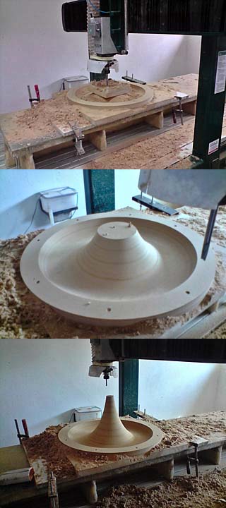

A flat piston is a very good source for an OS waveguide. In my first tests I used a Panasonic honeycomb device. It worked very well. The loading isn't a significant structural effect.
I don't think so. A disk in beak up mode won't do well in any horn. But did You measure that BMRs? I would be very interested in the reults using them as direct radiators.
I think the answer would be obvious after looking and driver off-axis response variation with angle.jzagaja said:Tangband offers interesting flat units that resembles Balanced Mode Radiators: W3-1797S and W4-1757SB. Question is can we use modal transducer in a waveguide? I think we can if one chose right kind of pressure feed and loading that does not destroy disc balancing. Then we can use these inexpensive drivers with possible simple phase plug and full range with transmission line.
Unfortunately all data comes from TB also here:
http://www.htguide.com/forum/showthread.php4?t=30060

jzagaja said:400Hz, 1", 14° with conical coupler went into prototyping. This is a standard for older compression drivers like TAD4001 and BC DE25/250.
