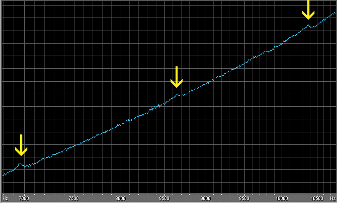

As I can see you are using Limp (from the Arta suite). The impedance curve you obtain is very smooth (I guess at lest a 1/24 octave smoothing is used...).
While I am an Arta user and promoter, I don't use it for impedance mesurement in the case I want to locate minute artifacts on them.
As an example I could do a study of the effect of diffraction and/or refllected waves inside a JBL 2405 tweeter to the slit of which I add different mouth prolongations. The different types of horns they figured gave different artifacts on the impedance curve.
Here attached a magnification of an impedance curve showing minutes peaks, probably due to membrane break up.
