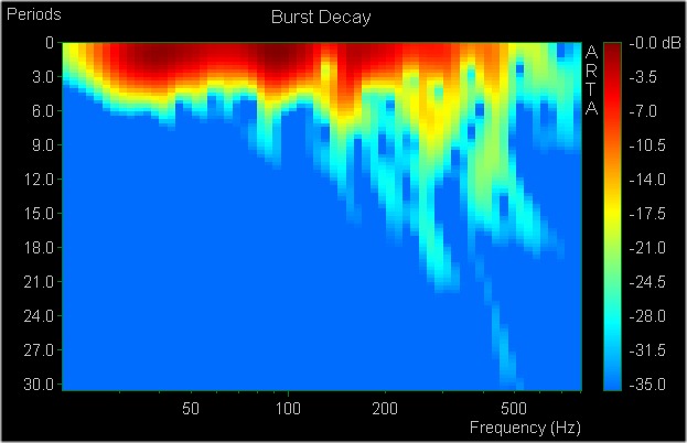

Would it be possible to have this spectrogram plot
http://www.diyaudio.com/forums/attachment.php?s=&postid=1838422&stamp=1243414513
to be viewed in a time scale of periods, not the linear time? Then it would be more clear how the room affect the sound.

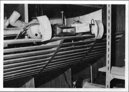

You'll find in attached file a burst decay of the pulse response of the bass horn belonging to Jean-Paul.

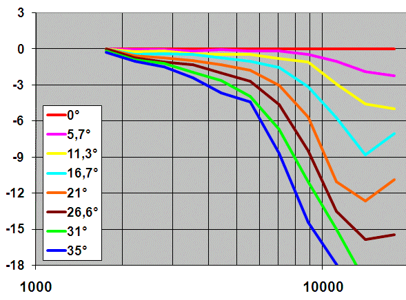

Hello Michael,
If one look to the on axis unequalized response curve of an axisymetric Le Cléac'h horn there is no such hole as with an axisymetric waveguide.
Eventually a small hole on the response curve may be seen at frequency over 14kHz and with angle over 15 degrees from the axis.
I attached a graph with frequency response curves at different angles for one of my TAD TD2001 mounted on a Le Cléac'h horn (Fc=320Hz T=0.8) applying on axis equalization.
