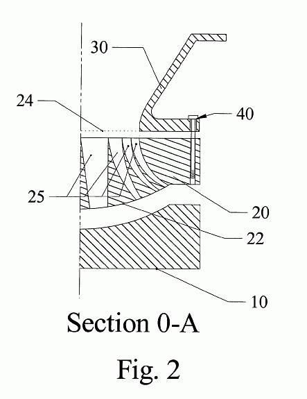

jzagaja said:A pure phase plug means exactly this I think:
I can't tell anything from those photo's. Could someone sketch or explain what it is?
A driver without conical part just cut on phase plug exit. The angle should be 0°, and suitable for OS?
jzagaja said:A driver without conical part just cut on phase plug exit.
I'm sorry, I don't quite understand. Do you mean that the phase plug have no "flare"? Well thats not only not new, its not even a good idea. The phase plug should have some flare, but what to choose? Older drivers using the concept of "cutoff and flare rate" figured that the lower these were the less it would interfer with the "horn". But on a waveguide the situation is quite another thing and this flare rate should be conceivably be as large as possible. This is the way the driver are going and it makes perfect sense.
So "A driver without a conical part" would not be a good idea IMO.
Maybe yes, maybe no, it doesn't matter in that patent so it perobaly wasn't discussed. Its hard to tell flare from a drawing because the area changes with radius and that can't be seen in a 2D drawing.
First tme I actually saw the picture of it.🙂jzagaja said:Well Earl I had in mind situation from your patent. Does it have a "flare"?
I don't believe anything like that had been build and measured intensively.
Earl,
In your patent everywhere there is a pure phase plug exit. I understand conical coupler is ok as long its length is no longer than throat diameter because otherwise it will have an influence on directivity.
Hello Jacek,
As I can see from the shape of the slits inside the phase plug there is a flare.
Then, in the plane of the exit of the slits the wavefront could be planar (if it is isophase as I think Earl want to).
Best regards from Paris, France
Jean-Michel Le Cléac'h
Eighteensound says pure phase plug isn't like JBL's "optimized aperture":
http://www.google.com/patents/about?id=17OUAAAAEBAJ&dq=Andrea+Manzini
