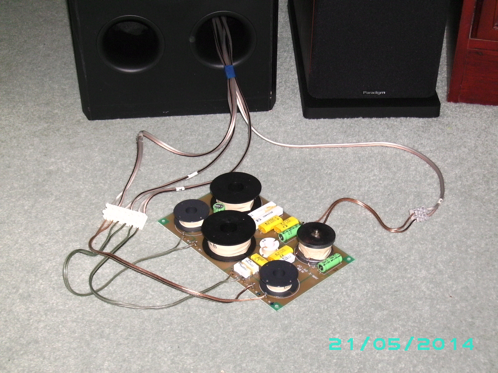

Thanks shmb,
This is what I'm doing at the moment. But I haven't modified anything yet.

1. The 2R2 resistor mentioned in post #34, should be place before C5 (22uF) so it is on amp side and not driver side (location makes a difference).
2. Create an L-pad for the midrange driver and it's impedance. Look for around 3dB attenuation. The tweeter may need it's L-pad altered to suit.
3. Add BSC in the filter but I think this may be too complex. Even so, 2dB - 4dB BSC is all that is generally required. A BSC LR (1.5mH + 3R3) network may be able to be placed before the filter.
4. Change position of speaker in the room so there is some rear wall loading. Make sure it's not the same distance as woofer to floor or a direct multiple.
5. Use an amp's tone control as their turnover point for bass usually lines up around the baffle step frequency for larger speakers.
6. Retune the ports in the box to a higher Fb as this can give more drive and life in the bottom end. Try half the existing length which will raise the Fb by around 10Hz and lift 50Hz by around 4dB but the F3 also rises slightly. You can use cardboard tubes to experiment. There was a guy here who got the results he wanted by removing the ports and using only the holes left in the enclosure. It increases the Fb a lot but doesn't hurt to experiment.
7. The bolt through L1 will alter the inductance (increase). If it is ferrous, replace it with a non ferrous bolt.

If I place the 2R2 before C5 that will just be the same as placing it across the input to the whole network. You don't mean across C5 do you?
I'll try the cardboard tube trick.

In practice this would be difficult, but I would definitely recommend moving the inductors further apart and arranging them like this: Placement of coils in crossover networks (as mentioned earlier in this thread)
This mod alone should somewhat improve the midrange response.

Unsolder C5 at the input side and add 2R2 in series before the cap. That frame would be a cross brace and is fine.
