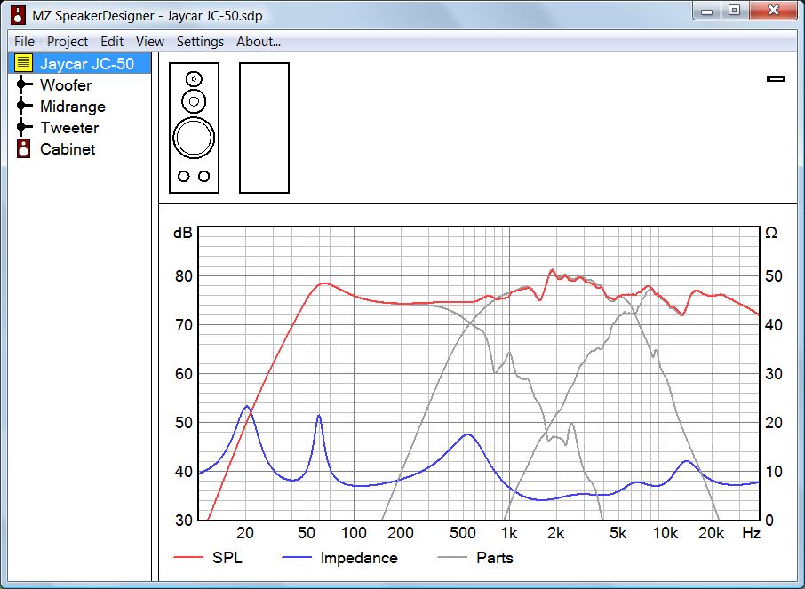

Catalogue values for the woofer are Re 6.9 Fs 39/40 Qms 6.623Qes0.506 Vas 32.8
SD 214cm<2
Stated SPL is 90dB but I know that is taken at the peak in response at the top end, where-as the domes 89dB is reasonable
I'm wondering if the lack of bass is simply baffle step and adding a second woofer rear facing would be the easiest way to get around the perceived lack of grunt down low, and this assumes room placement is already optimal

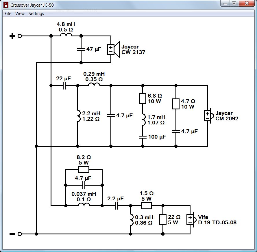

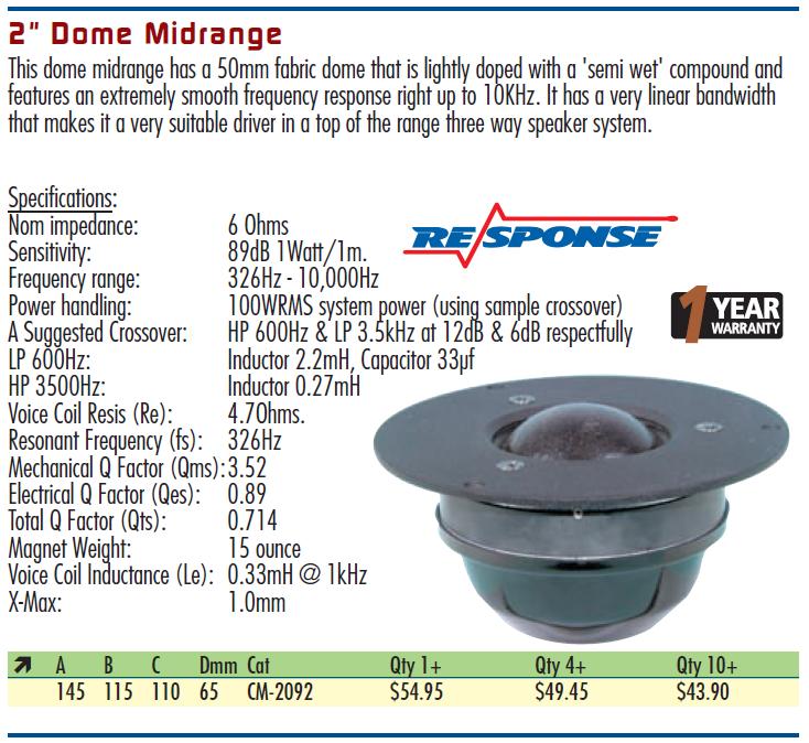

I have an old Jaycar catalogue open here and where the PDF shows a 22uF cap the catalogue recommends 33uF
First tho I would correct the coil orientation and phase

Not sure what Jaycar cat you have but the figures you quote for the woofer are not what is in my 1999 cat for the CW-2137 page 43.
QMS 7.632
Qes 0.364
Vas 98Lt
I can't see Fs or SD in my specs.

Sorry Talbit I gave the specs for the better woofer CW 2136. The cheaper woofer is a different driver entirely and to get deep bass needs more than one woofer and a huge box. I happen to have a quad of these spare too, I was saving them for a midbass in an OB speaker but the new house is too small for OB

I recalculated a crossover of 700Hz and looked on the Jaycar site for the crossover coils and it looks like they are not going to stock them any more. Might have to wind my own.
I recon the designer has come up with the L & C values by experimentation. It must have taken a lot of work.
The way I understand it, the woofer L.P. L/C values should be the same as the Mid high pass L/C values. But it's probably not as simple as that. By my calcs, there is a gap of about 780 Hz between the woofer and the mid in the original design. It certainly sounds like it to my ear even though they published a fairly flat response curve for the whole speaker.

Talbit, the inductor and capacitor values are based/calculated on the drivers impedence at the specific crossover frequency points these values can be a lot higher than the nominal values. eg an 8ohm woofer may have an impedence of 15ohms at 700hz. you need to measure the impedence at the crossover points and use these values for calculating the inductors and capacitors. cheers Greg
The problem with those Jaycar drivers is that published data are unreliable and nobody measures the actual TS-parameters. Nevertheless I do attach a simulation of the Jaycar JC-50 speaker (microphone distance 3 m). I assumed the woofer (Jaycar CW-2137) to be identical to the MCM55-1215 and the midrange (Jaycar CM-2092) to the Dayton DC50F-8. Cabinet and port dimensions are estimated. The crossover certainly is not completely wrong, but the midrange seems to be too loud by some dBs. I recommend to try a 2.2 ohm resistor in front of the midrange filter.

Dizzi, Thanks for the simulations. Nice work! But the published plot of the whole unit also looked very good. And simulations are not the same as my "Golden Ears". That's what makes me think that the original design is different to what I actually have on my lounge room floor.
I'm not sure where you suggest the 2.2R should go. Across the actual driver? Placing it "in front of the midrange filter" would appear to suggest at the input to the whole setup. I see the D19 has a voltage divider across it. Is this what you are suggesting?

I'll disagree with Dissi here about padding down the midrange. I personally hate to throw away midrange SPL as heat
Try something else first
Simply disconnect the woofers and listen for a while to see how the midrange on its own performs for you. If the upper midrange is OK then it's a woofer problem
Personally I think the designer got it slightly wrong, I don't think it needs the resonance peak filter when crossing that dome that high as it exhibits a near perfect second order closed box roll-off at ~350Hz

As I said in an earlier post I think the lack of percieved bass is a baffle step problem
True Audio TechTopics: Diffraction Loss
Baffle Step Compensation
This would sound as if you needed an extra amplifier to drive the bass, a 6dB loss is substantial
The best fix in my opinion is an extra woofer or a separate subwoofer
Doing the arithmetic will let you know at what frequency the -3dB point is
The easiest [ and IMO the best] solution is a powered subwoofer of sufficient power and SPL capability to match the tops

Or just build a new cabinet reusing the drivers and XO plus a Baffle step woofer rear facing using a simple first order coil in series at the -3dB point
