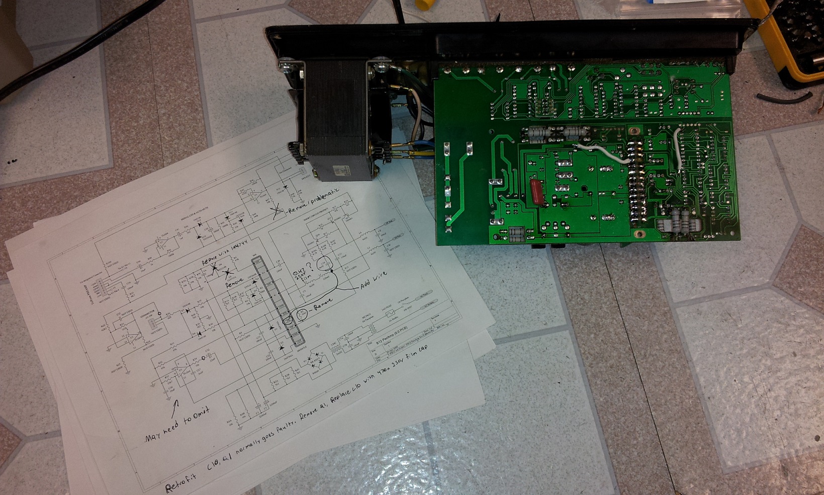

My solution DOES in fact work! Just have to perform the modifications I had scribbled in the previous picture, and do some tweaking.
Attached were the last design files I had created before the project was toasted.
The component values are good enough to get it working.
But the front-end needed some component value tweaking to get the frequency to match better with the JBL output filter stage configuration, as since this is self-oscillating the frequency has a tendency to dip too low on high modulations causing overheating in the output filter stage. Lower volumes were perfectly fine though.
the 2nd thing I needed to do was change the output transistors to TO-220 for better custom heatsinking. I chose the surface-mount versions so I could slide the board and sink it inside the original S64AMI heatsink shroud, but that never happened because potting...
So I increased the width of the board, and never got around to changing the output configuration, Also the board needed to be converted to fully surface mount which didnt happen yet.
Also, the IRFB4229s I chose were a little too much for this design as well, because R3 has to be tweaked for minimum heating, but it affected the fidelity of the amplifier.
You will have to play around. it does work though! This Design was tested with the amp shown in my previous photos, and I believe it was a +/-90V Rail system.

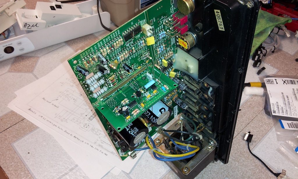

I have finally had my design fabricated.
It is a very simple design that uses an opamp to make the ramp and integrator, then a FET driver IC with 2 pretty nice FETS.
It also uses the incoming rail voltages to create a +15V supply referenced to the bottom rail so the FETs can be properly driven.
As long as I did it right, this should be a drop in replacement for the S64AMI module.
I will post a schematic soon.

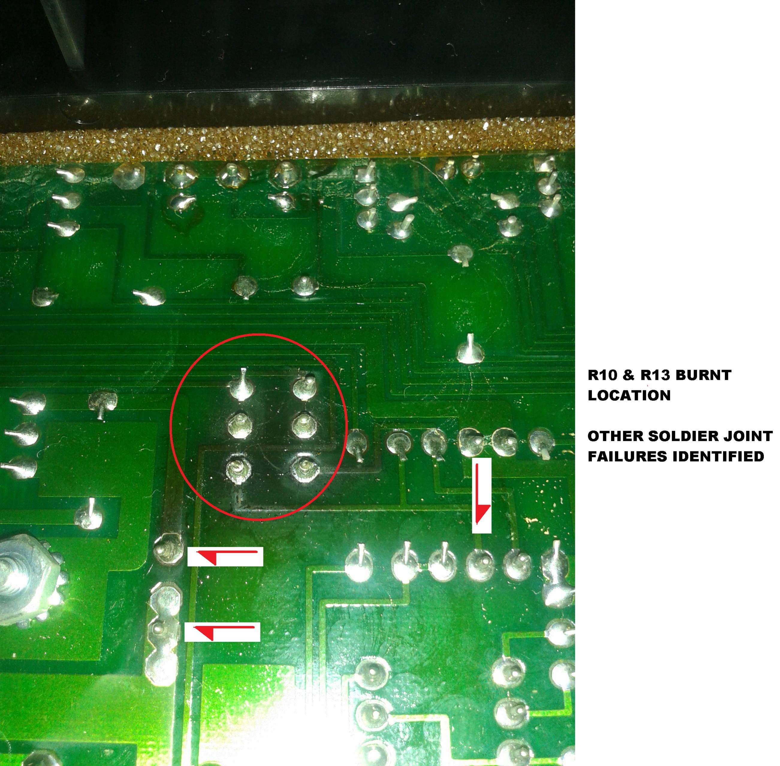

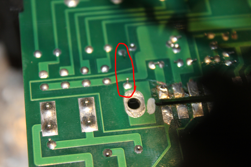

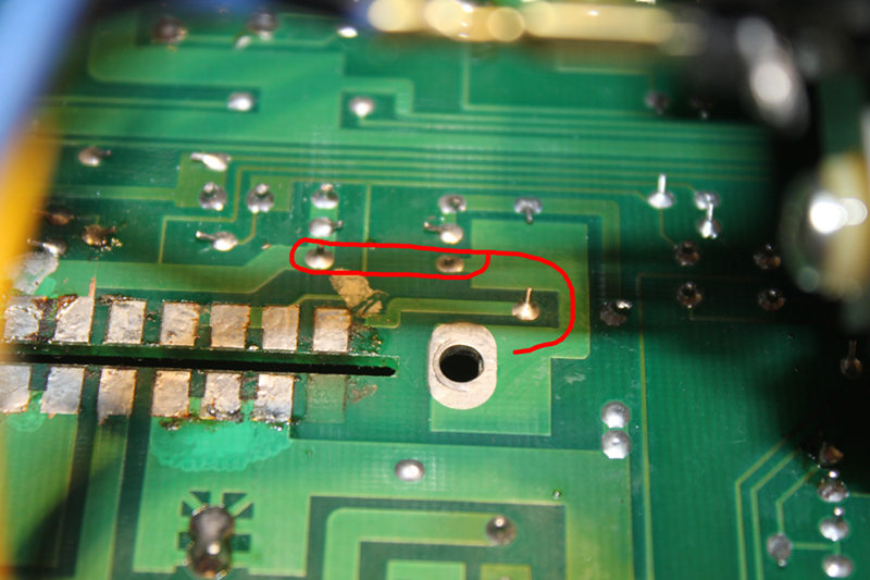

I enjoyed reading the 36 pages of history regarding the S53AMI and the work Pat and the rest of the passionate ones attempt to gain the trophy of fixing this consumer's nightmare.
My first run down the rabbit hole was just as frustrating as the next man's headache dealing with poor quality production hiding behind a GRADE A badge. The first quick jabs I was hit with:
Item 3 reminded me of a period where Alpine's car amplifiers were having similar conditions, which required a 12-pack and a couple hours checking and reworking the circuit boards to get them operational again... No component failures, just could not handle the heat and would just go into protection mode and shut down. Power-cycle the amp, lower the drive capacity and increase cooling operations might get you to post up at the club with the right bass-line.
I diagnosed the patient and called the cause before I even disconnected the system and opened it up. I had verified basic properties with a DMM to quantify my intuitions. Sure, these powered sub-woofers will run fine, for years, if your drive them like a grandmother going to bingo night and the VFW. Open her up, kick out the cobwebs and let the rhythm move the neighbors and Pandora's Box is open for suggestive troubleshooting / operations.
You can see what I mean in the image, as the rings in the joints identify the conditions I speak of. Yes, the sub could work well for a week or two, hiccup for the same period or just have a meltdown in the middle of the freeway. Your flip for the ball...
I am not sure how much I will spend trying to eradicate the demons from the design, but I am already thinking of dropping in a design change relatively quickly and as painless as possible (I HOPE).
- Woofer wired 180 degrees out of phase, previous owner mentioned lack of drive.
- R10 & R13 campfire evidence.
- Multiple weak soldier joints, typically caused by high heat & poor cooling.
