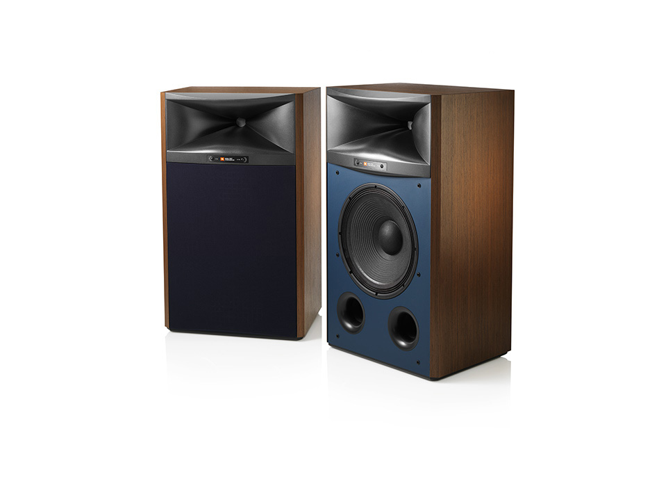

M2 Master Reference Monitor Products | JBL Professional : yes seems smoother on the blue monitor !
The bass F3 too (or not the same driver?) ! And 12" or 15" on the blue monitor ?!
It looks like more the 7 serie : LSR708i Products | JBL Professional (not the same CD in the 7 serie, but the same as the M2 in the Blue Monitor ? !)
Always liked the blue front grill... très chic !
Here's some side by sides. Definitely a different waveguide.
When the M2 came out, Geddes made some comments about the 'beak' being a marketing gimmick. (I'm too lazy to dig up the posts, this was a couple of years ago.)
I have a 3D printer, and I figured out how to design the beak in 3D. (I posted that here, again, I'm too lazy to look up my own thread.)
When I measured my waveguide, I found that it measured pretty good, but it wasn't quite as smooth as the QSC, which is still the best waveguide I've every measured.
I've mostly abandoned using the 'beak', except in extraordinary circumstances*, and it looks like JBL has too. I mean, it's "sorta" there in the new waveguide, but it's so small I doubt the effect is any more than cosmetic.

It looks like the M2, LSR305, LSR308, LSR705, LSR708 and 4367 waveguides are all designed using the same software, the shape of each of these waveguides (call it break or anything) being directly dictated by the software depending on parameters such as horizontal and vertical directivity, dimensions and shape of the mouth, and wavefront shape at the throat.
There is no "choice" to put breaks or not, and replicating one of these waveguides based on visual clues (let alone drawing conclusions based on these visual clues, or measurements of these replicas) is most probably pointless.
The M2 waveguide *is* available (and pretty cheap for what it is), so is the D2, and the LSR305 are also available for the price of a single of these waveguides.
So why not just try them instead of guessing?...
