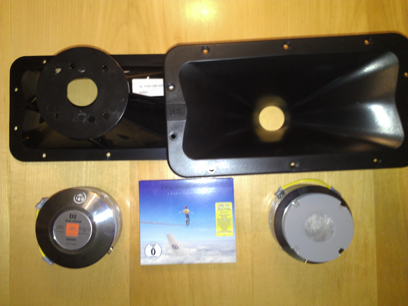

They have arrived ! Sorry for the bad picture quality.
Haptics and visual quality are very good. The size and weight of the driver are in the same ballpark as a 2426.
It will probably not go very low on that horn. So my measurements will not show the lowest possible extension for that driver.

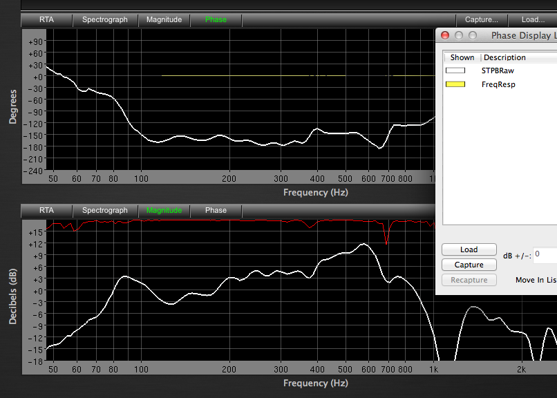

I'm sure the JBL 15 can play nicely up to 1khz or so in a typical enlcosure, but the bandpass chamber applies an acoustic low-pass filter. If I were to guess the 15's in the SH90 are only playing up to 200 or 300hz. The larger driver and lower xo require larger ports farther from the throat. I just don't see a 15" driver, used as described in the Synergy patent, working up to 700hz or higher with physics being as they are. The patent is available on Google patents......I would suggest studying that thoroughly.
Nate,
Legis' 15" Synergy are good to 500 Hz, which for home use would certainly be a workable crossover frequency for a variety of HF drivers.
http://www.diyaudio.com/forums/subwoofers/258706-study-dipole-cardioid-bass-horn-28.html
I don't recall if he ended up reducing the volume of the bandpass chamber, but that does makes a big difference in the BP cutoff frequency.
By reducing the BP volume in the 2x10" SynTripP, the cutoff frequency (about -3 dB at 900 Hz) was almost as high as in my 2x8" Paraline cabinets.
Art

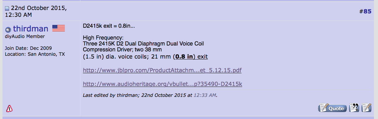

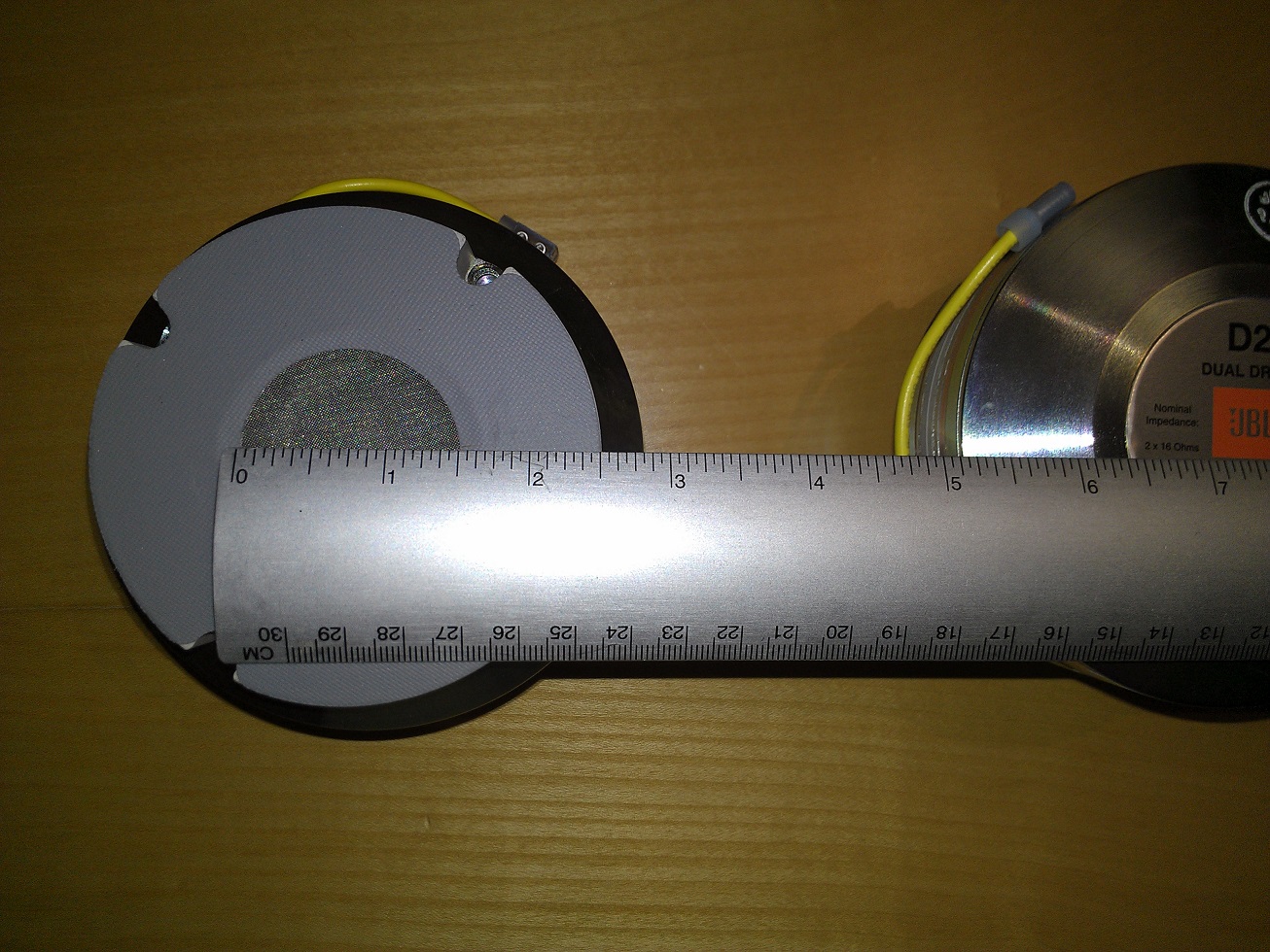

My D2s do definitley have 1.5" exit maybe you mix up the driver types:
I screwed up, there is (should not have been) a "D3" in this discussion.
The D2430K (like you have, or as used in the M2) is a dual 3" diaphragm with a 1.5" exit, or perhaps closer to 1.4" by your ruler.
The D2415K (as used in the JBL VTX V20) is a dual 1.5" diaphragm with a .8" exit.
At any rate, "D2" is not enough of a descriptor to know which is being referenced in this thread any more :^).
