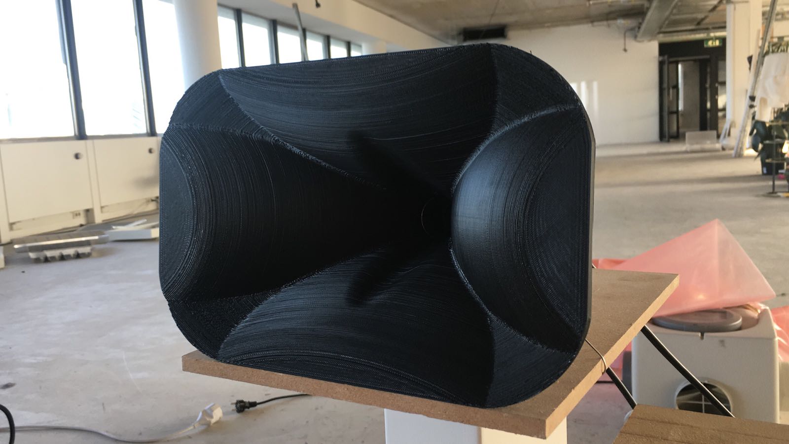

Just finished one waveguide after 32 hours of printing...
Bolted on a BMS4550 and crossed it over at 800hz to a Faital Pro 15PR400 on a 60x60 cm flat baffle and did a quick measurement just to check if I got it kind of flat.
Coming from a 2 way synergy (300/20khz) with the same bass speaker, the first thing I didn't like was the bass speaker covering the lower midrange, but apart from that theres a lot to it that I like.
Somehow in my synergy's the mid can be a bit of transcending over the fine details, although it measures "flat" to 20khz. This was gone with this waveguide, maybe the finer transition to the CD responsible for this.
Hope to do some serious measurements later this week!

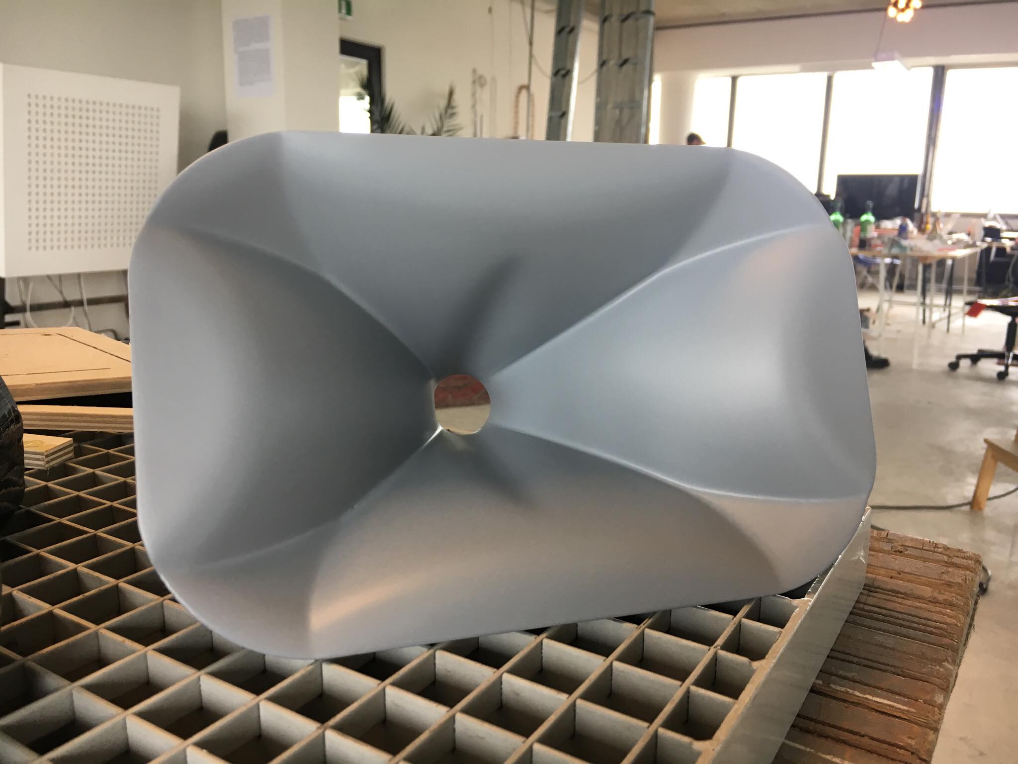

I don't want t to hijack the forum, but wanted to share this image, been sanding for quite some time and a lot of spray paint applied. Coming out really neat and I'm really curious how the mold will come out!
