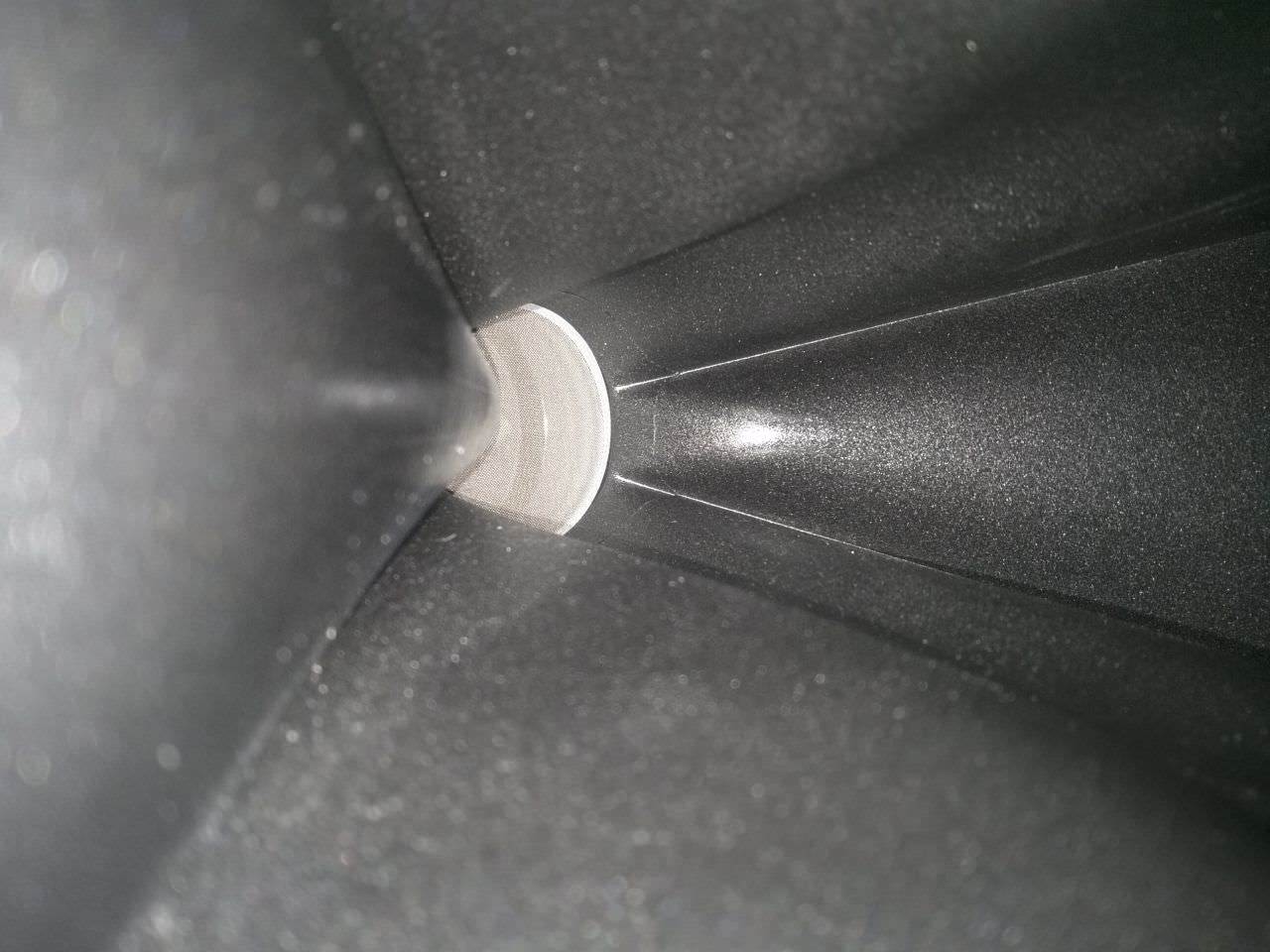

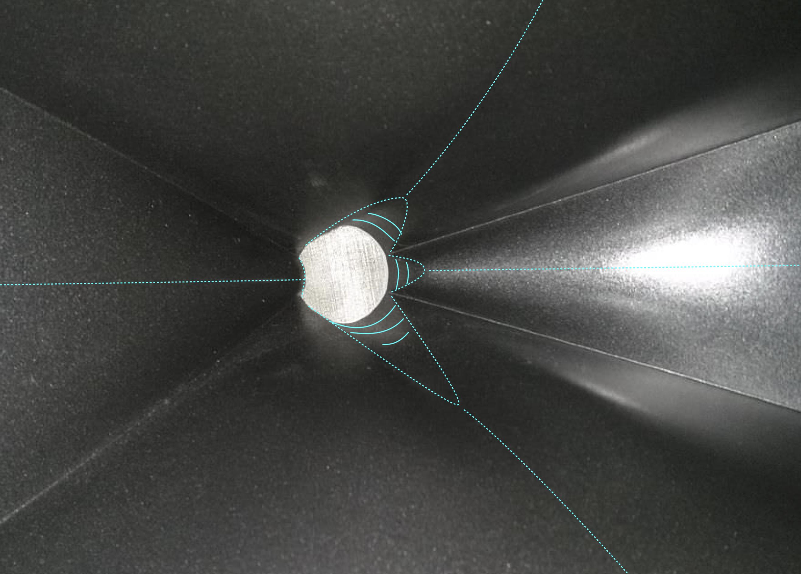

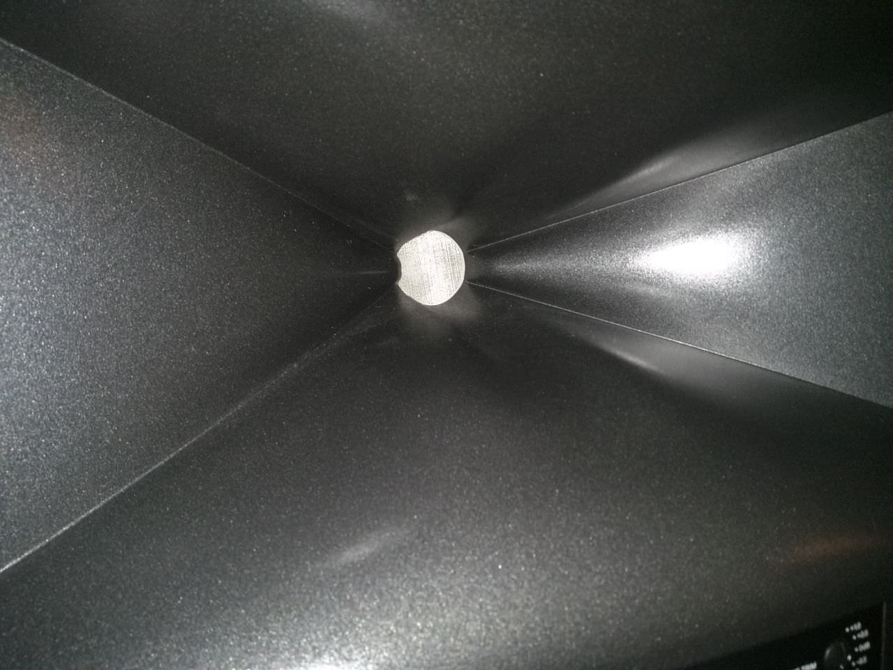

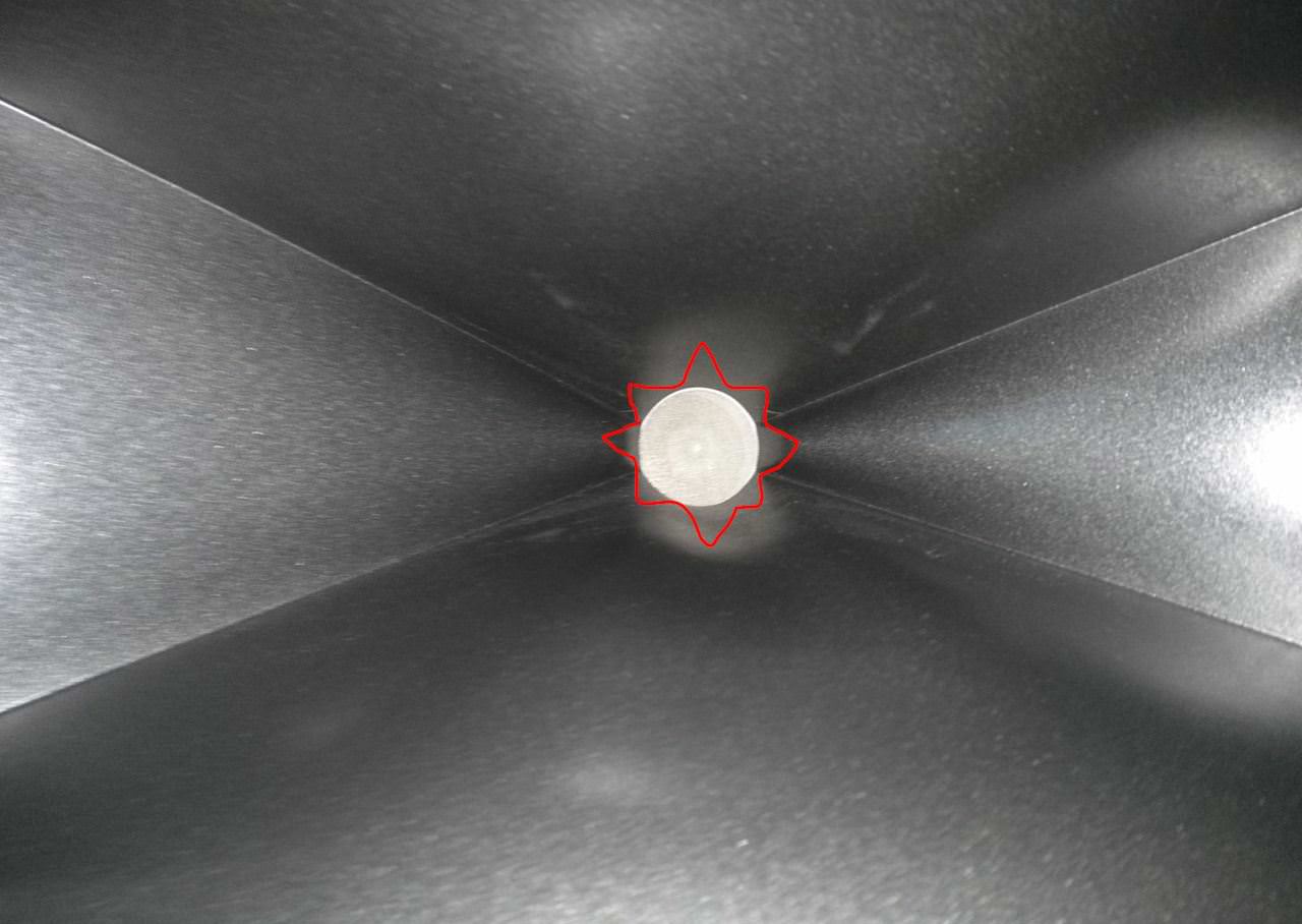

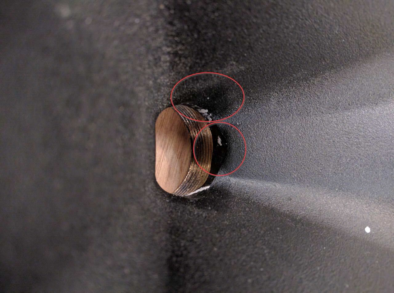

I was working on a waveguide design over the three day weekend, and noticed something interesting about the JBL 4367.
The JBL 4367 is one of the latest JBL speakers with their "image control waveguide."

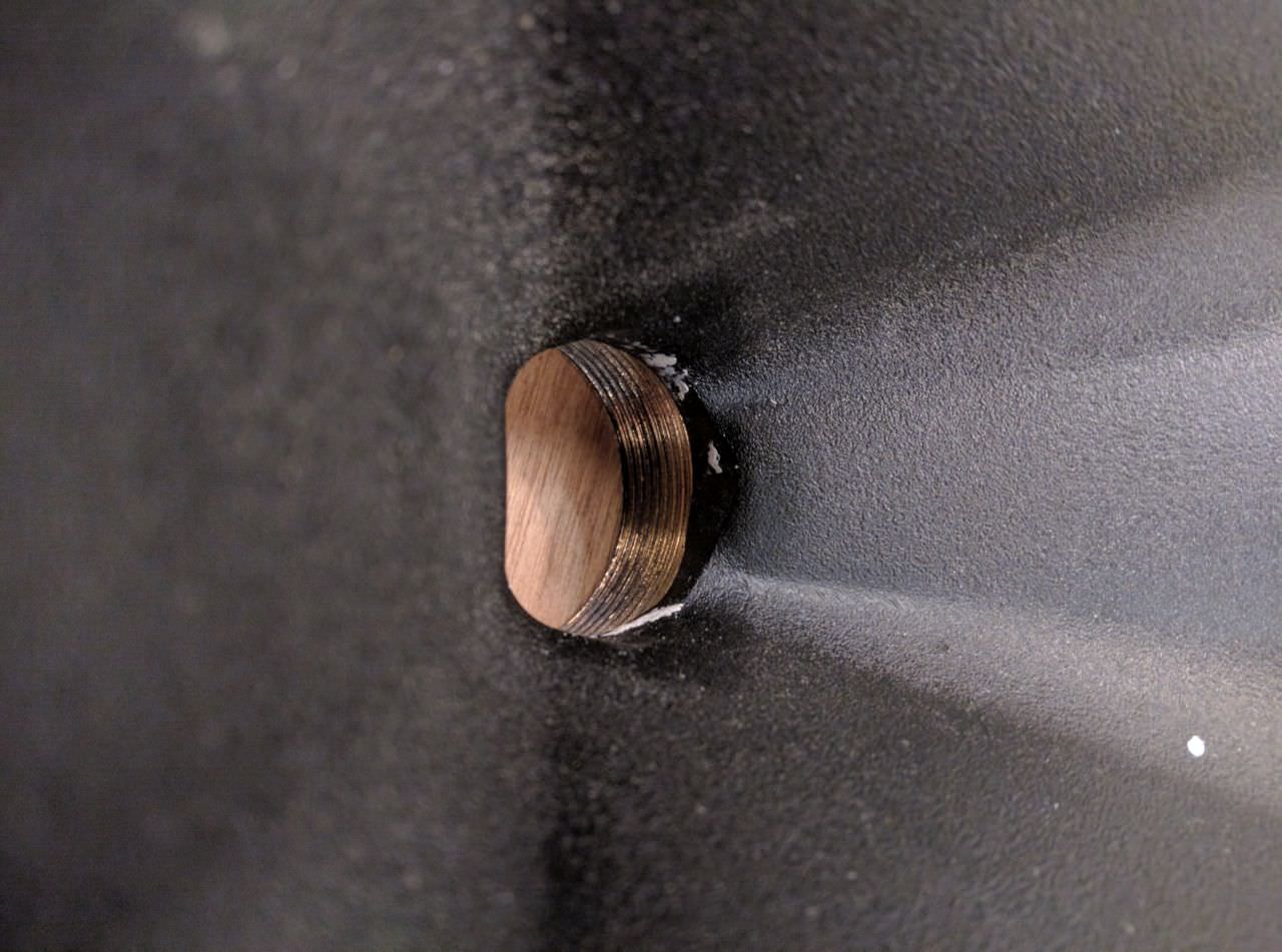

Until this weekend, I'd never noticed that the JBL 4367 waveguide is very very similar to the JBL progressive transition waveguide.
Look closely and you'll notice a couple of things. First, the PT waveguide has 'beaks' like the 4367, they're just very very subtle. And if you look close at the throat, there's an *extremely* shallow diffraction slot in there. See how it expands on the vertical axis and the walls are flat on the horizontal axis? In this respect, it's similar to the 4367, only the diffraction slot on the 4367 is much more pronounced.
Of course, all of this is mostly academic, unless you happen to be spending your holiday designing a waveguide!
But if you ARE designing a waveguide, these photos may provide some insight into how the waveguide is designed in your 3D software. In particular, I believe that the walls of the waveguide are swept around a shape that's similar to this:
I believe the waveguide walls may be swept around an eight pointed star. (Conventional waveguides are swept around a circle, ellipse, or rectangle.)
Here's my crude illustration. Note that the 'beaks' of the waveguide mirror the eight pointed star.

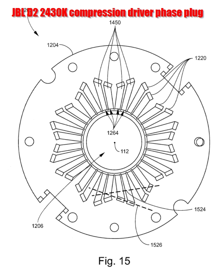

Not coincidentally, the phase plug on the D2 2430K that's mounted on the JBL M2 and the JBL 4367 has the same shape. IE, the phase plug of the D2 2430K produces a wavefront that's shaped like an eight pointed star, and the throat of the 4367 is shaped like an eight pointed star.
This brings up some interesting considerations, because the single diaphragm JBL ring radiators have a square shaped phase plug. (The dual diaphragm D2s basically feature two phase plugs, one for each driver, and the combined shape is an eight sided star.)

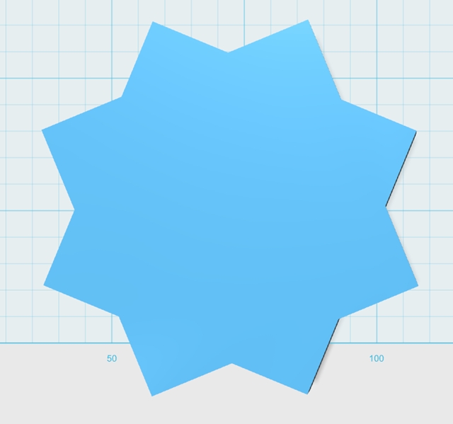

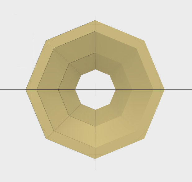

John, your observations seem pretty spot-on.

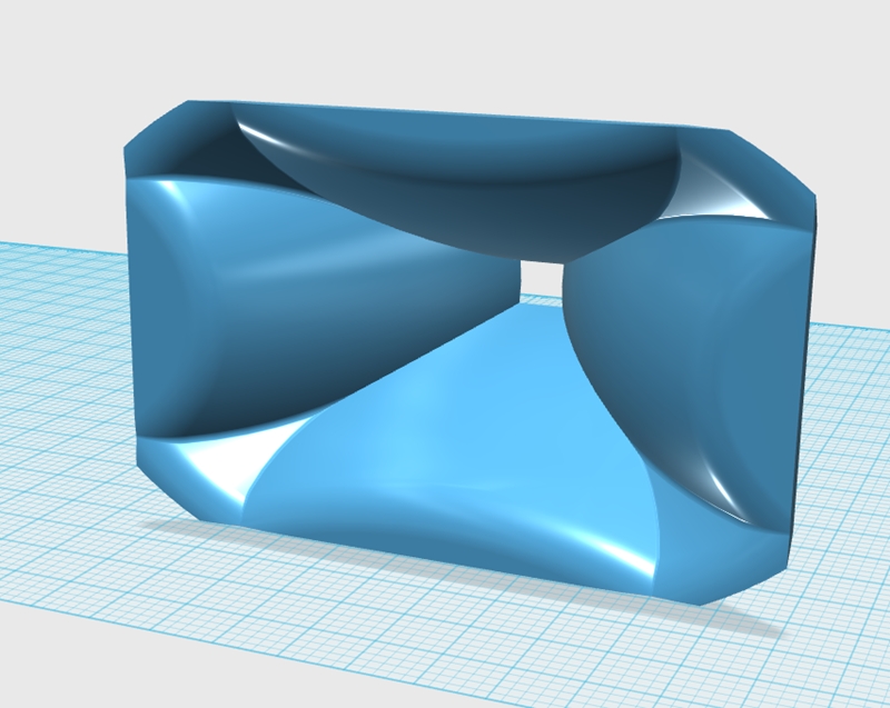

This is the derived geometry from a JBL PT waveguide, which appears to be composed of 3 octagonal sections :

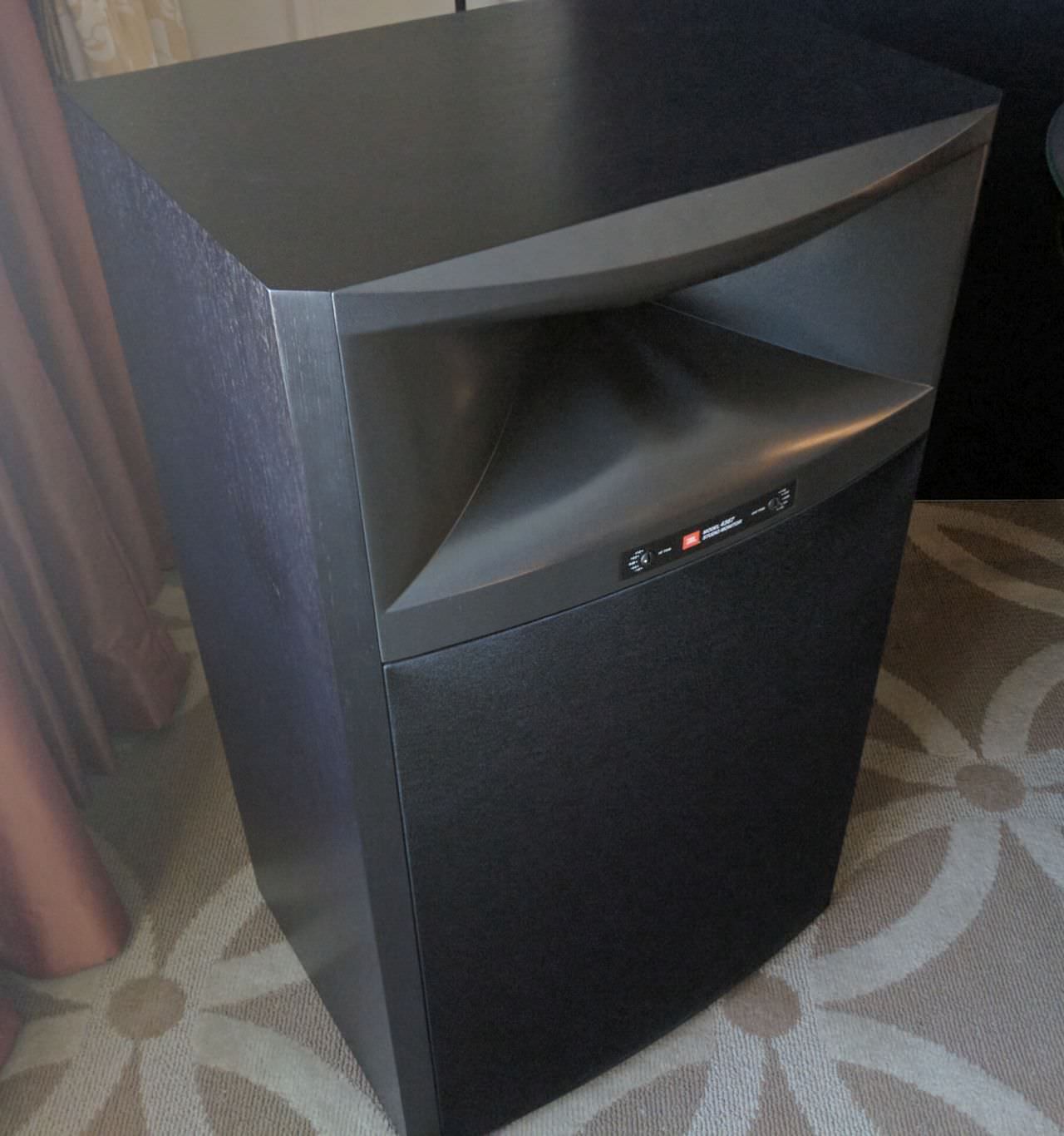

For me, the best sound at CES this year was the JBL 4367. For some reason, there are a bunch of BMS 4552s on eBay right now, so I thought I'd throw together a "4367-ish" waveguide for the 4552.
Here's the 4367. More pics in post JBL M2 for The Poors

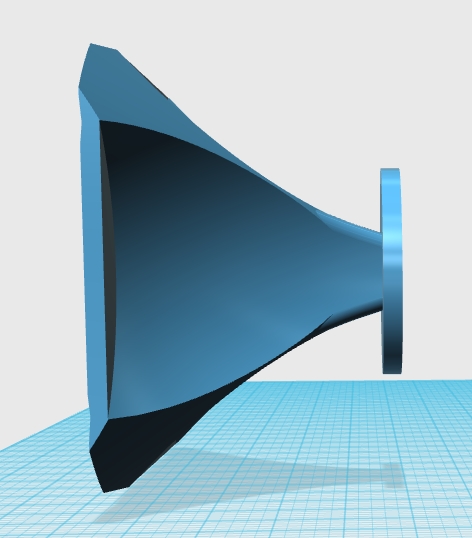

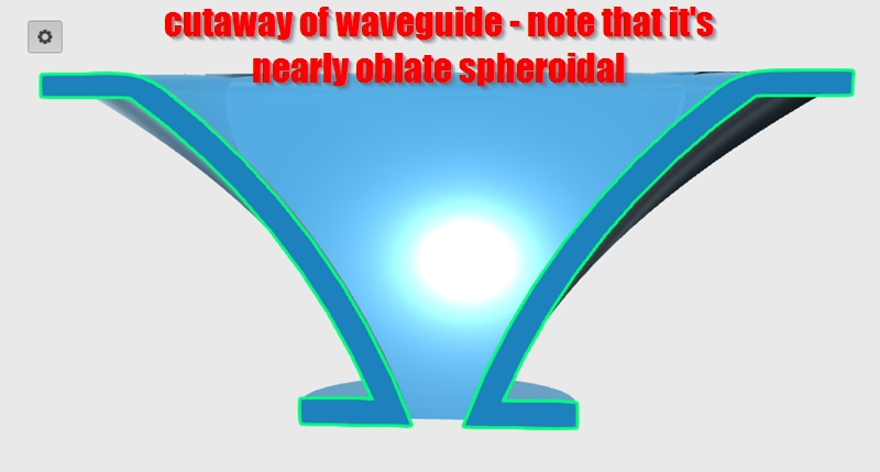

MEGA Here's a link to the 123D model, which you can open and modify in 123D. I believe you can also open this in Autodesk Fusion.
MEGA Here's a link to the model in STL. You can open this with just about anything. You can print this directly to your 3D printer.
The spherical parts of the waveguide make it look like it's narrow, but it's actually quite wide. Here's a cutaway. The exit angle of the BMS 4552 is matched to the entrance angle of the waveguide. This isn't an OS waveguide but it shares some of the design ideals: there's a slooooow transition from the exit of the compression driver to the mouth of the horn.

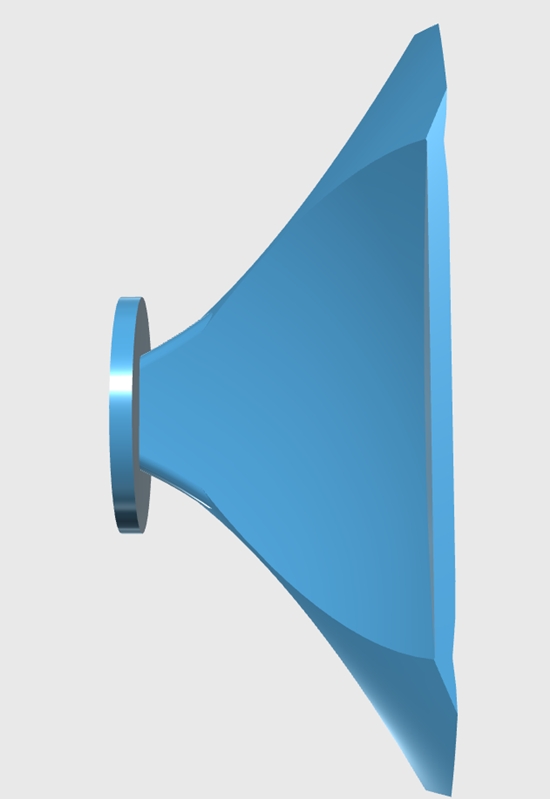

Overhead view.
Side view.

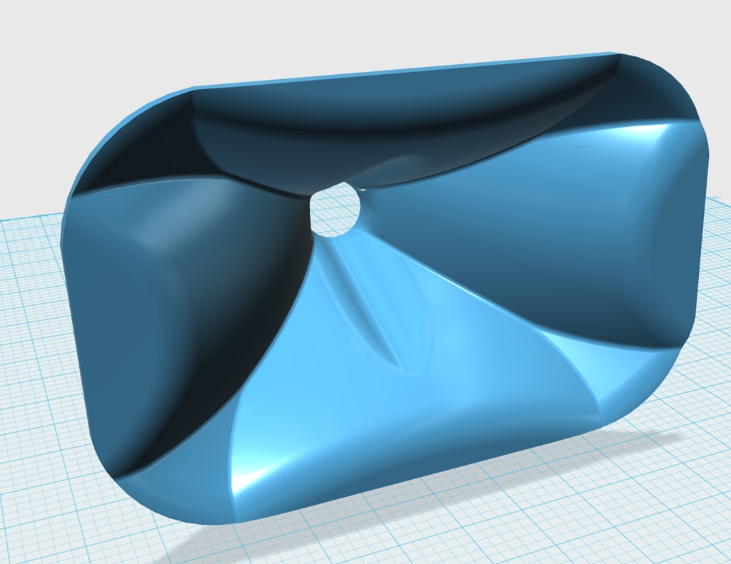

This is what the waveguide looked like before I added the 4367's vertical diffraction slot.
The waveguide measures 16.2cm x 23.4cm x 10.9cm. For comparison's sake, the PT waveguide used in the econowave measures 16.3cm x 30.23cm x 11.2cm

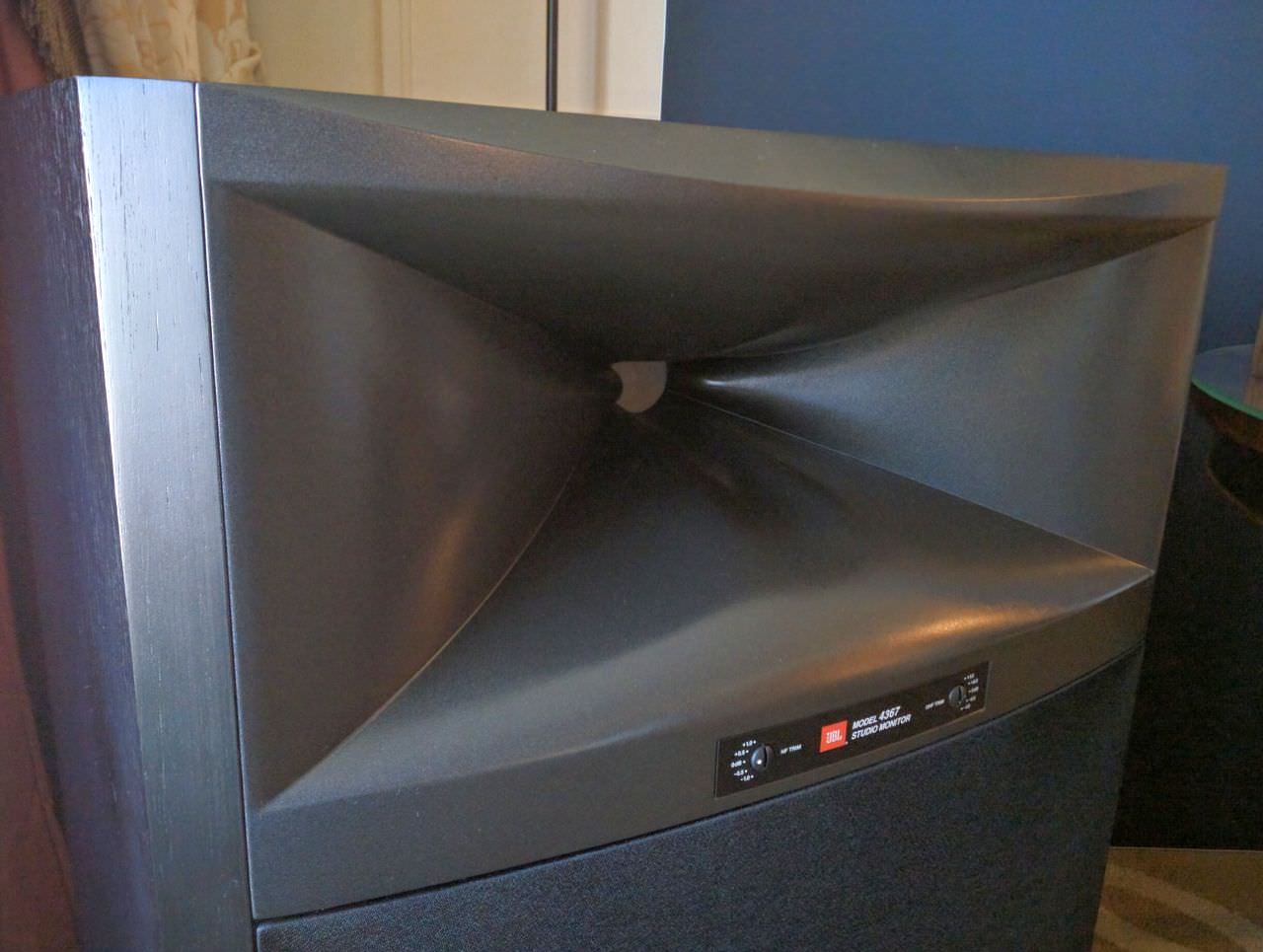

John, I really don't see this 8 branches star here. To me this waveguide/horn is really similar to the M2, but the beaks just « disappeared » because of the new dimensions (and probably other constrains like different woofer directivity, cost, design etc).
It’s like an M2 that was stretched horizontally and in depth, while tighten vertically. Beaks are still there but the top and bottom ones are of course much smoother and enlarged to the point that we almost don't see them.
Maybe just because the dispersion pattern had to be different for home environment (more directivity in both directions, with emphasis vertically).
Ex:
What do you think?
I think the "agressive" beaks of the original JBL M2 were probably not ideal. Keep in mind that was Charles Sprinkle's first attempt at evolving the JBL biradial geometry. (IIRC, he didn't design the progressive transition waveguides popularized by Zilch about ten years ago.
So the later designs 'backed off' on the beaks. They're still there, but very subtle.
In addition to this, the vertical diffraction slot in the 4367 is quite apparent. Very similar to the 18Sound XT1086.
If I'm lucky, I'll have some measurements of my 'homage' to that waveguide later today.

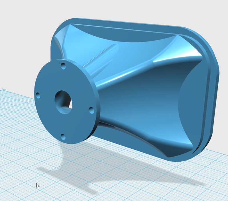

If you don't have a 3D printer, that means that you're going to need to go with something like the CDX1-1425 that EAW uses in their "ANYA" speaker. EAW has their own customized version of the CDX1-1425 that's designed to be packed tightly.
Here's the "stock" version, which is $100 at Parts Express
But if you DO have a 3D printer, you can build something like this fairly cheaply. Just buy a pile of neodymium 3/4" tweeters and 3D print the phase plug. If you go that route, I'm thinking you may be able to make something competitive with a JBL D2430K for around $150. It would basically look like a Keele CBT, loading a slot, which would then feed a waveguide.
