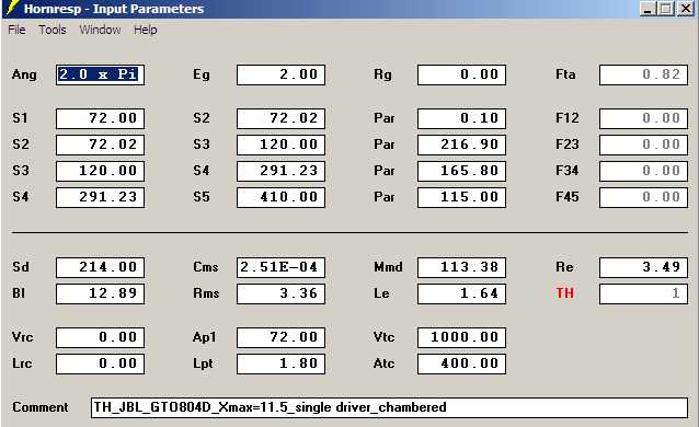

Code:
ID=28.80
Ang=2.0 x Pi
Eg=2.83
Rg=0.00
Fta=-0.29
S1=275.00
S2=270.13
Par=19.50
F12=0.00
S2=270.13
S3=205.24
Par=260.00
F23=0.00
S3=205.24
S4=200.00
Par=21.00
F34=0.00
S4=0.00
S5=0.00
L45=0.00
F45=0.00
Sd=214.00
Bl=12.89
Cms=2.51E-04
Rms=3.36
Mmd=113.38
Le=1.64
Re=3.49
TH=2S
Vrc=0.00
Lrc=0.00
Ap1=0.00
Lpt=0.00
Vtc=0.00
Atc=0.00
Pmax=100
Xmax=5.0
Comment=NEW RECORD - JBL GTO804

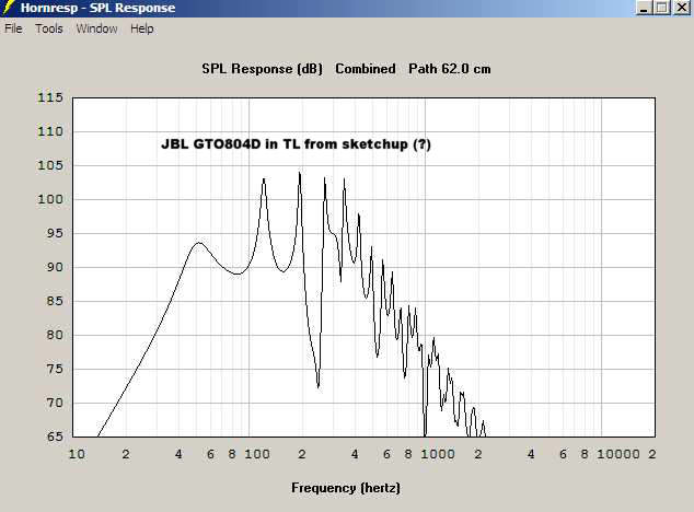

Hi 2009thread1,
Do you have any idea on a preferred size? When I simulate a TH (for a single JBL GTO804D) in Hornresp I get something around 95/110 L_net. For a tapped horn with a long folded horn path that may mean 125/130 L_gross. Your preferred external size will determine the folding.

Hi 2009thread1,
The sketchup TL looks like 72.38 L_gross, that is a lot smaller. But which one is better? 🙂

ive never heard a t-line before, but from videos they're really loud on the lows, but ive never heard an 8" tapped horn beforeThe sketchup TL looks like 72.38 L_gross, that is a lot smaller. But which one is better? 🙂

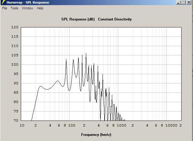

🙄 Don't be looking at me - your the one with AutoCADHi 2009thread1,
I haven't found time (or reason, I use ACAD) to learn Google sketchup, maybe NEO Dan can help. I'll attach a first try Hornresp input and spl window:
