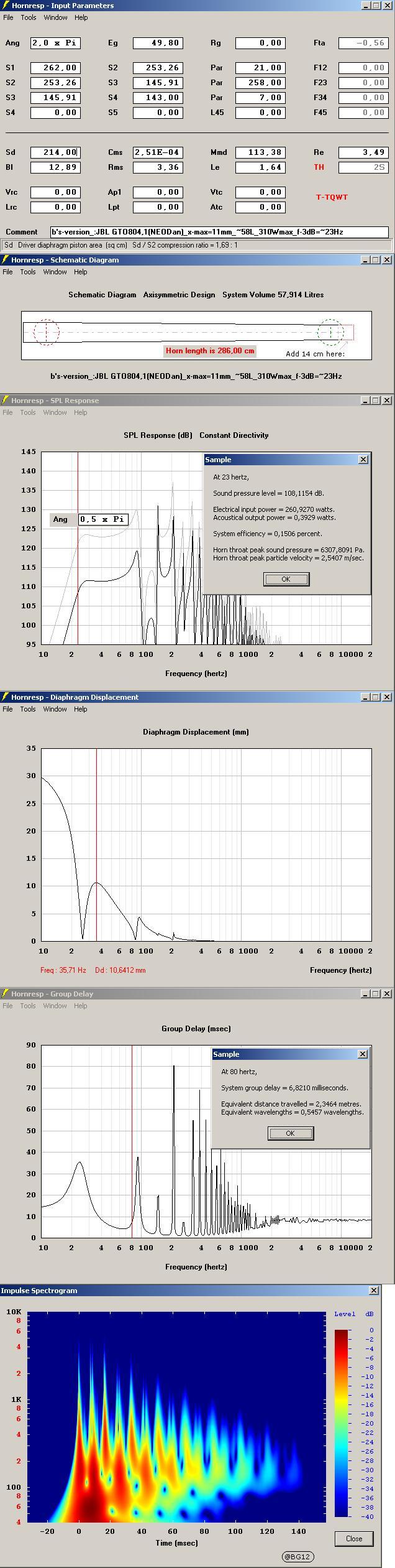

Hi, Here is an example using your design as a template but with slightly changed dimensions:
b🙂
I think he took the screen shot and then realized that 7 is too short to fit the driver in so he just drew it on. It is impressive that it can be shrunk down so much without loosing much mid-band sensitivity. I do wish we could make this stronger in the bottom end after stuffing.
So would you change anything else or redesign, I can redraw.
Hi Dan,

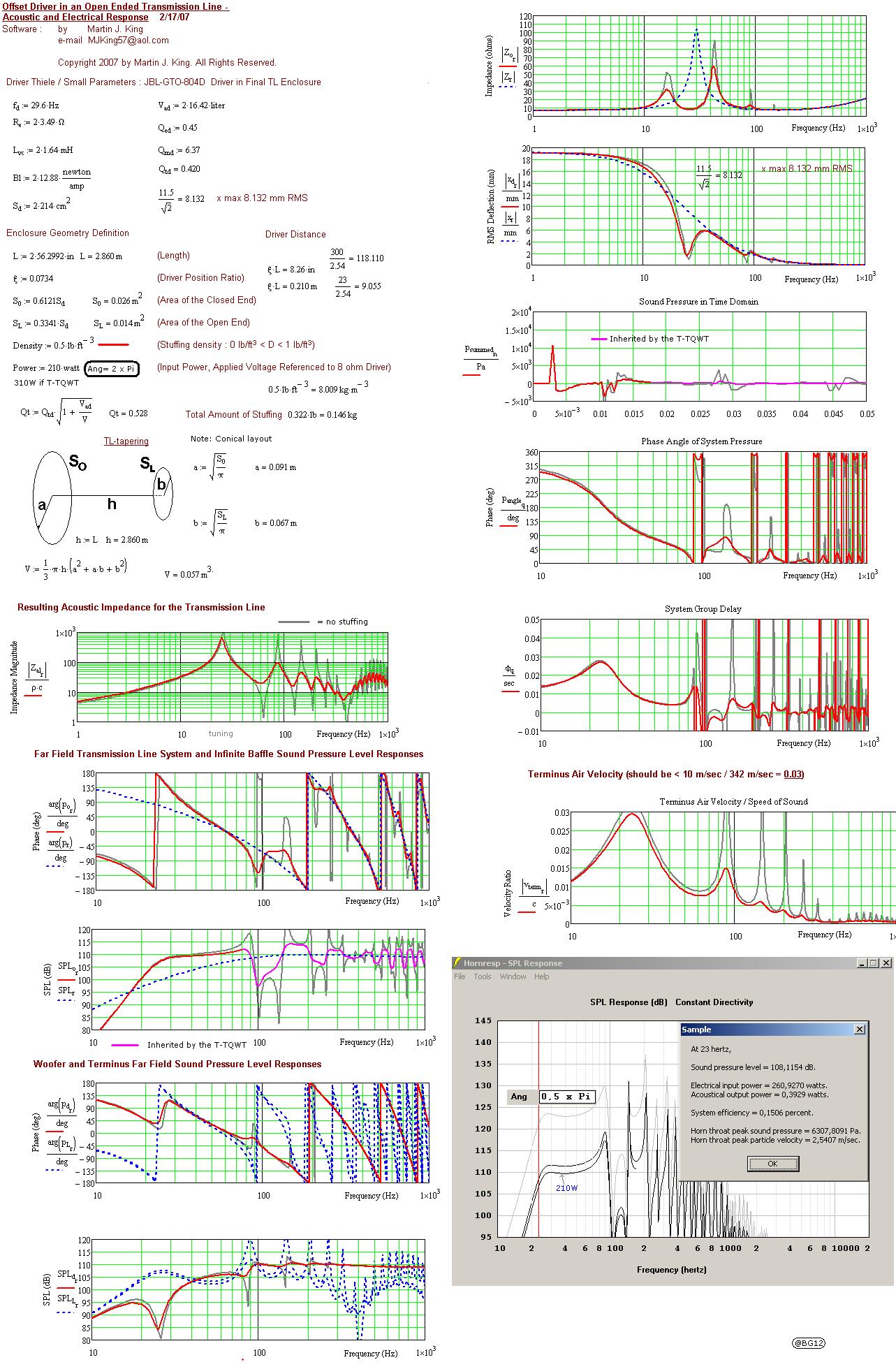

I redrew your design because of the phase-response at ~75-95 Hz, i.e. the Gldy that show a peak I don't think would be smoothened/attenuated enough by the damping material or folds.
At ~80 Hz I try to keep the Gldy lower than ~9.4 mS a value I used for years allowing the use of a simple sub plate-amp.
No EQ for the sub or signal-delays for the main speaker are expected to be necessary as the off-band ripple is low and the excess phase/Gldy are smooth/low when the speakers are in a row and near a suitable wall.
IME, integration to main speakers with a single sub is then an easy task, in an space like that an ordinary living-room normally provides, of-course.
b🙂

I noticed the GD was a bit lower in the hornresp, it seems a bit optimistic that the very high q notch you got in the MJK worksheets is going to work like that though.
I was surprised by the terminus velocity numbers for such a small cross section.
I think I missed something, I don't see any drawing.
Sorry for writing drawing when I meant simulating as in post @70.
There are both math artifacts in HR and MJK:s programs: You have to look both at the phase response and the Gldy to estimate if the shown Gldy peak or the change is phase slope are consistent and not forgetting to include the change in Phase/Gldy that for sure will happen when a LPF is introduced to the overall equation.Measuring experience is also of a great value to add...
I was not:no:
