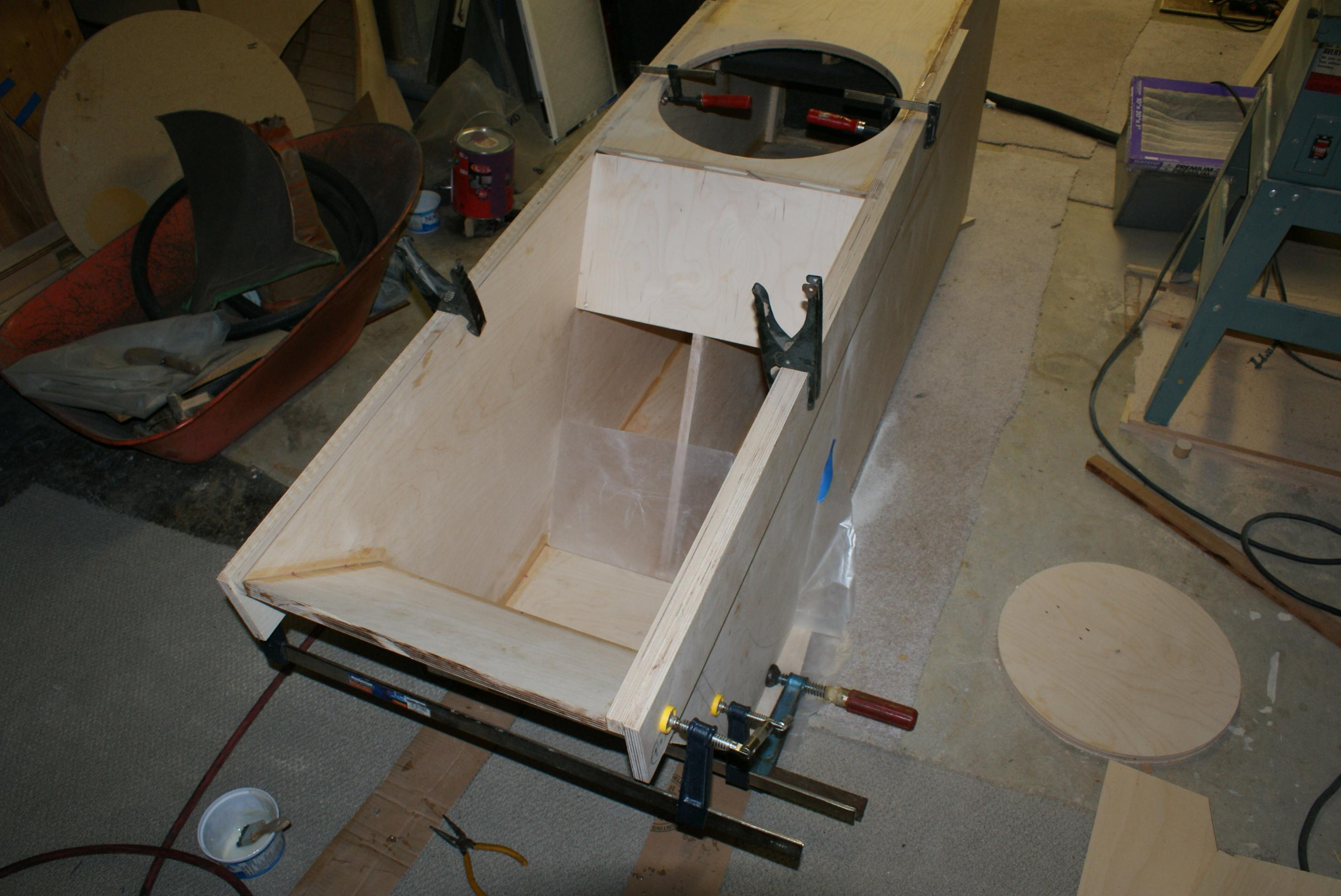

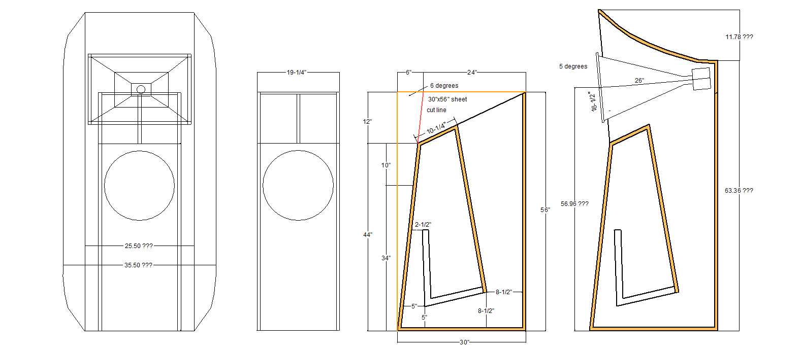

Hi scott, sure, I have a preliminary plan that my friend did for it. it's not compete ,but major dimentions are there. It is not too difficult , It takes 3 1/2 sheets 5x5 baltic birch. If you have a table saw that will be helpfull and a skill saw for the larger panels ,bisket joiner ,epoxy for assembly. There is also a composit chamber that will need a mould made. I plan to make another pair ,and could take pics through the build if you're not in too much hurry. Basically it is new for me too and still a work inprogress but as is a very pleasing bass.
just for the record I am now using the 2245 [single] in a 10 cubic foot box with a 15" x 5" port 15.3" long [tuned to 30 cycles] as per the jbl sight, and never felt the need for "LOWER" bass as I have never heard music[I don't do home theater] ,amplified or "otherwise" that had any thing close to a need for anything below that frequency .So I wanna build that backloaded horn . and when I can afford it I will build one more.and I don't think I turn it up as loud or don't need to: I am using a 60 wpc tube amp with 104 db [,fully horn loaded speakers with excellent lower midrange and upper bass but missing the bottom octave] .eff speakers.I bet i have never put more that 2 watts into this system.no need i just look for as close to effortless as i can afford to get .THX

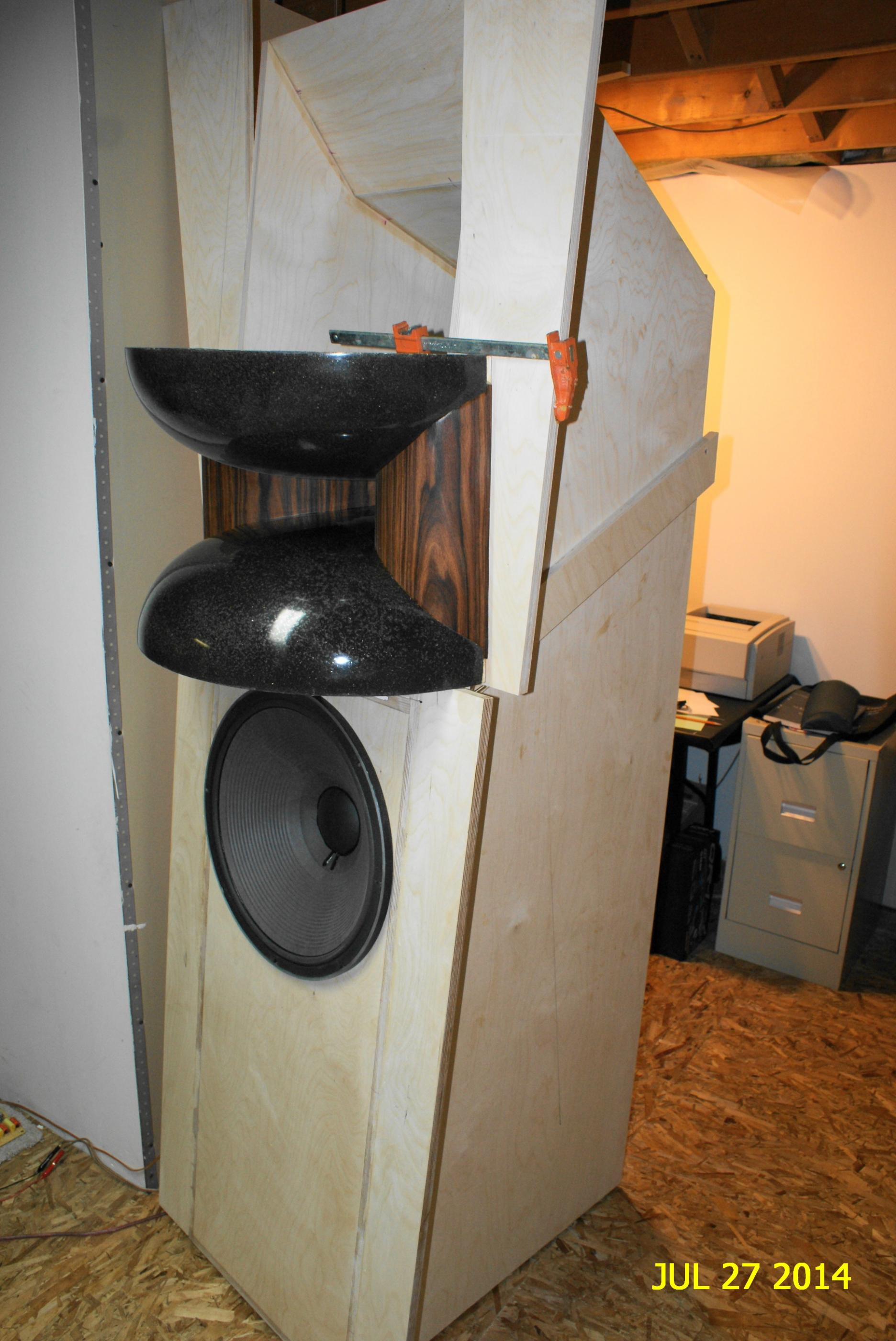

yup Monster! Goliath ! 7 ft tall 30 inch deep 20 inch wide without the baffle extensions,but hey it's only plywood! 300$ worth of plywood will still get you farther than a million in speaker wire
Ya, all kidding aside, I posted all the build pictures so far on Photobucket so as not to clog or hijack Scott's thread , find them here...
Still a work in progress and I will post more as they come
