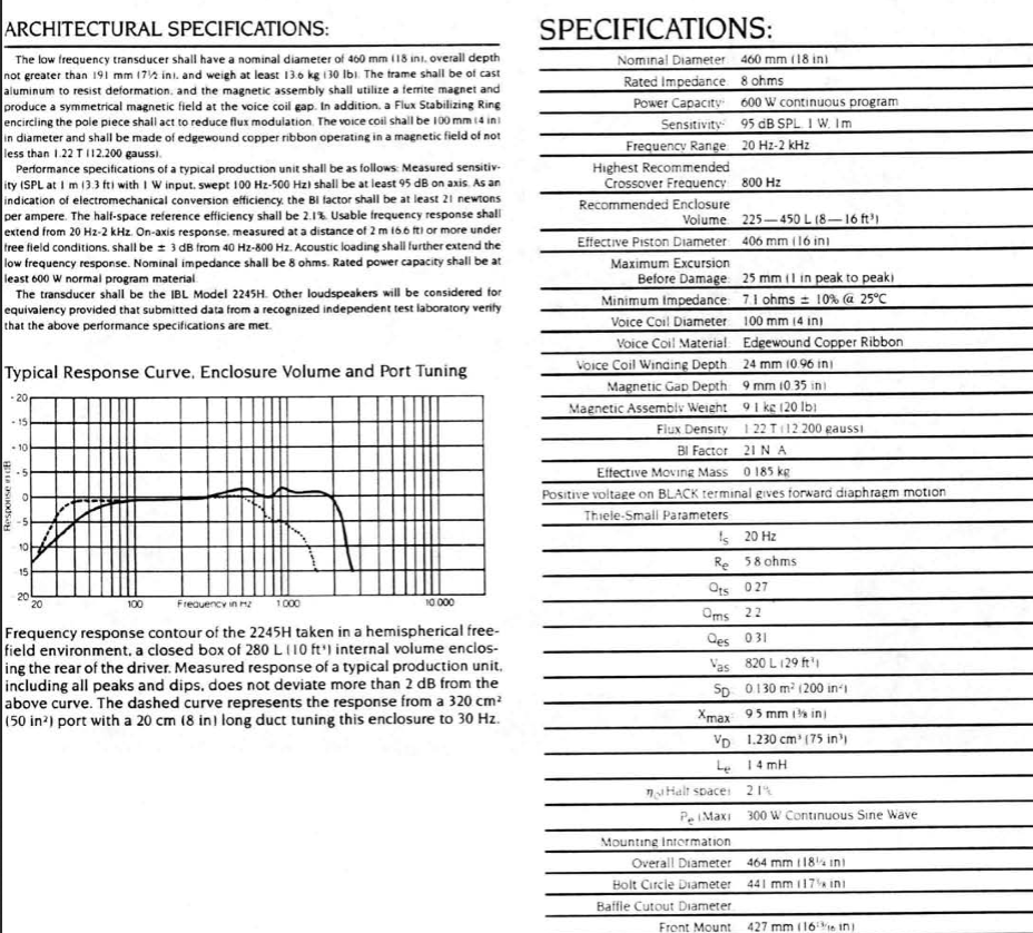

Hi ON the JBL 2245 H The TS Parameters are: fs 20 qts .27 qms 2.2 qes .27 vas 821.2 eff 2.1 pe 300 x max 9.65 re 5.8 le 1.4 sd 0.130 bl 21 mms 185 flux 1.22 Any idea if i could build a folded horn with this driver.I have the tools and experience to build it I just need a drawing. and as far as size i have enough room for a say 3'x2.5' x6' .I should be able to get some decent horn length with something of that size?Thanx Scott

You’ve not specified exactly what you plan to use this driver for so I’ll just tell you of my experience where I’ve used the 2245 woofer in a 12cf ported enclosure tuned to 20 Hz.
It’s probably the best sounding woofer I’ve ever had, except that I wanted it for a subwoofer for my HT and that’s where I encountered its major weakness, its Xmax limit of ½ inch (9.5 cm). And when they say 9.5cm they mean 9.5cm not 9.6 because this speaker very easily bottoms out mechanically producing a very laud and frightening whapping sound, in fact in my enclosure this driver can only handle 18 watts at 10Hz.
In a horn enclosure you’ll have to use a low cut filter not to allow any signals below 25 Hz other than that it should sound great.

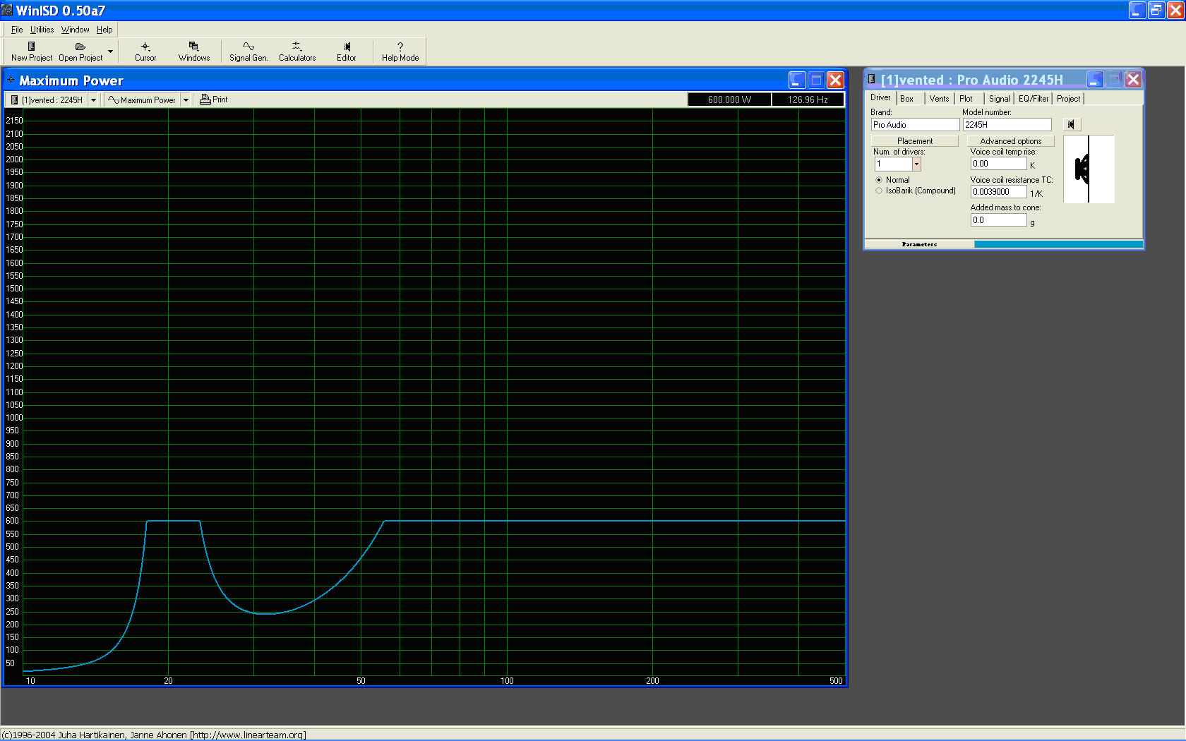

Hi djk
It doesn't matter if the amp clips or not, its almost all frequency dependent. Anything below a ported box resonance frequency more than 18 watts will bottom out a JBL 2245, the 2240 also had this problem. In fact if you run winISP you'll find that the power is even limited above the resonance frequency. JBL improved the situation with the 2241 & 2242 you just have to check the rear pole piece to see why. If you can manage the Xmax weakness (Hi-pass filter, Limiters, etc) the 2245 is really a great sounding driver, but a sub woofer for HT it is not, too bad because it was JBL's lowest playing 18" driver with a 20Hz FS.

Did you run the 2245s with a tube amp or with a SS amp? Actually SS amps tend to better control the over excursion when clipping (so-called hard clipping) because the back EMF of the speaker gets shunted out to the power supply by the reverse polarity diodes across the output transistors producing a dynamic-brake effect, whereas tube amps don't have this D-B effect and thusly have a soft-clipping nature.
I agree with you 100% that a closed box would be better for the 2245 to help control the Xmax limit, however with a Vas of 29cf its motor structure was not really strong enough to get full performance out of a smaller box (in you case of 5 cf per driver), so the user had to resort to gain boosts and sharp filtering to produce the required sound while protecting the driver. By the way what was the roll-off of your filter?
In my case I had a 12cf box tuned to 20Hz for a single driver, and that one 2245 also shook the house but with no-filters or boost because I was trying to get a 15Hz low end for my HT which is where I failed. I had to change the driver before I destroyed it. Which is sad because I really liked it. I was considering adding a second driver and sealing the box as you did, but with the foam problems and the difficulty getting an original unit I decided it was not worth the risk.
For the fun it I tweaked the 2245 Xmax in winISP to allow a 1 inch excursion (instead of 9.5mm) and the predicted performance of this speaker would be hard to beat even by the best subs available today. Someone should perhaps think of building such an animal.

Sorry djk, I won't bother asking because I know very well what happens to a woofer when an amp clips both for solid state and for tubes, as I have been designing and characterizing amps (both tube, SS and micro-wave) since the late-sixties some have which have been used in recording studios.
A SS amp will attempt to stop (or brake) all of the cone's movement when it clips due to the reverse bias shunt diodes that are always used to protect the power transistors from the coil’s back EMF. If these diodes were not there the power output transistors could be destroyed by the back EMF voltage.
At the moment of clipping the cone's inertia produces a voltage that is greater than the clipped output of the amp and as such the speaker changes from a current load to a current generator and as I hope you are aware due to the laws of physics a current flowing back into the amp’s low impedance power supply looks like a short circuit on the coil thus forcing a dynamic brake action on the cone. Therefore clipping actually stops the cones movement with a SS amp.
This action causes the so-called Hard-Clipping sound that SS amps are known for. Tube amps on the other hand will tend to over push the cone on clipping as the back EMF voltage actually adds to the plate voltage that in turn raises the output voltage delaying somewhat the clipping and rounding out the sharp corners of the clipped signal.
Many people think that it’s the feedback / dampening factor that controls the speaker movement at clipping, but this is not true, because at clipping a feedback driven amplifier loses all dampening capability (i.e. cone control) and it’s the only the shunt diodes that rules under this condition.
I suggest that you should open any speaker software and model the JBL 2245 for yourself, you’ll be amazed to see how much frequency limits its power handling capability, it can only support full power (600 watts program / 300 watts RMS) at the box’s resonant frequency, its power capability drops both above (e.g. 238 program watts at 33 Hz) and below this frequency, and in my case, at 10Hz it only supports 18 watts before the Xmax limit is exceeded (see the supplied winISP chart I've supplied).
