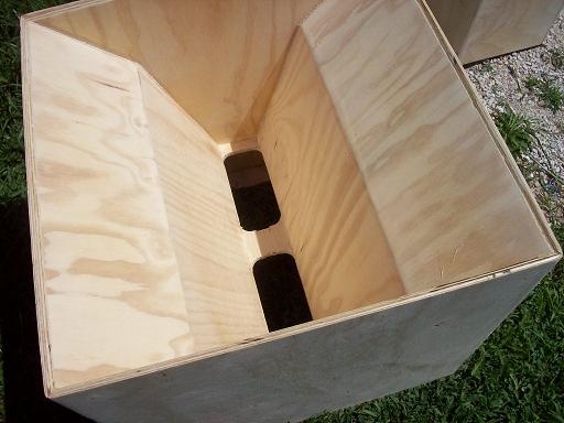

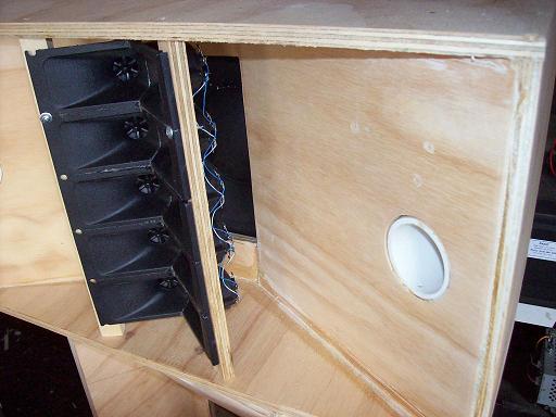

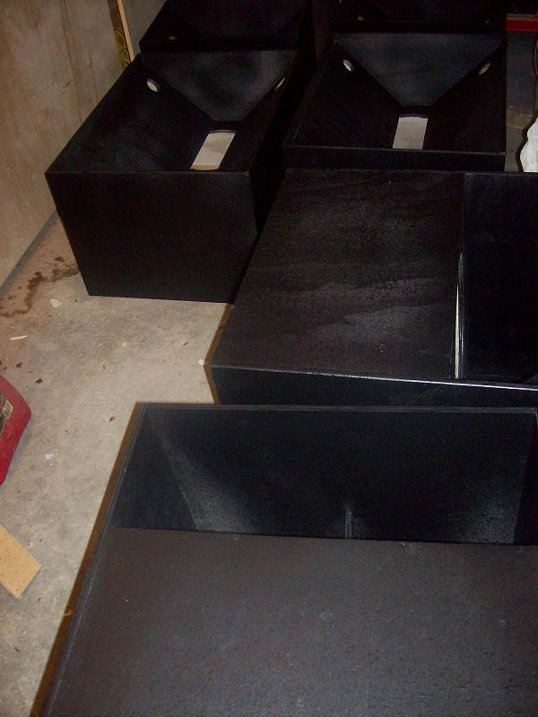

On the tops, yes ports in the flares. In the earlier pic I didn't have the ports cut in all of the cabinets yet. Yes, side ports are feedback magnets. Black paint kinda hides things, but I think you can see where I put the ports.
I'm not going to post anything on tops until tested. However I will say they were designed around standard 15x22 and 22x30 grills. The single driver cabinet perfectly cuts a pair of tops per sheet, and the dual driver cabinet has a little left over per sheet. Drivers are beta12a-2's. Since the demise of the 55-1740, I've been really scratching my head on what to do for tops. My hope is that this is the answer I've been looking for -- testing will tell for sure.

On tops, I don't want to post design till I hear it. Selenium 220's with wave guides and piezo arrays will both be tried. According to hornresp, the tops hit hard at 100hz in 4pi space, so I think they'll be a good match for the cubes.
