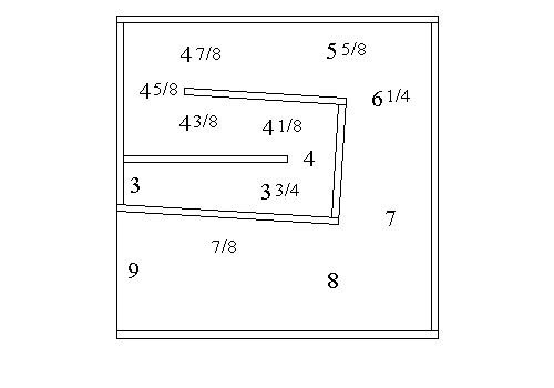

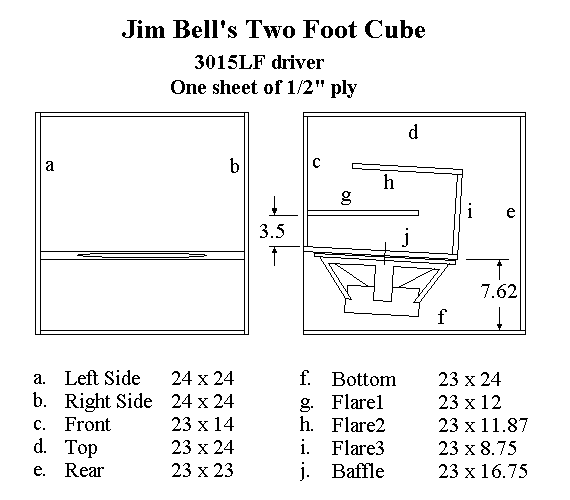

OK, apologies for the 'dimension guesstimates' at work. As you can see, they don't quite line up with my memory.

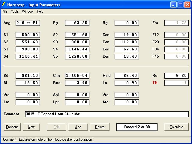

A 5mm xmax and 16mm xlim on the omega sounds like it was made for only one kind of sound... I couldn't sim any reasonable TH configuration and apply more than 100watts before exceeding 5mm.
Personally I think they need to go in the reflex box they were designed for, and let them sound like they were designed to sound.
4 Big uns vs 8 Little uns
Cubic inches:
4 Big uns:
4 x 36 x 46 x 24 = 158 976
8 Little uns:
8 x 24 x 24 x 24 = 110 592
Wood:
4 Big uns:
8 Sheets 0.75 inch plywood
8 Little uns:
8 sheets 0.50 inch plywood
Drivers:
4 Big uns:
4 Kappalite 3015lf
8 Little uns:
8 Kappalite 3015lf
What does it cost us? I'm guessing the US guys have cheaper plywood, so you are happy to build big high efficiency boxes.
In my case the wood makes costs almost as much as the driver on the big boxes.
Regards, Ben

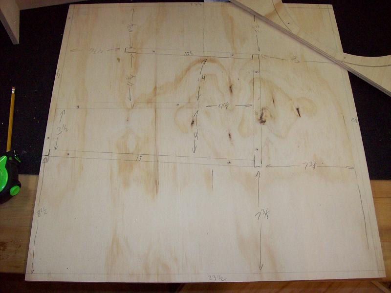

Your drawing looks better than my construction !
I'm about ready to start testing -- will let you know what braces/baffles are needed.
thanks

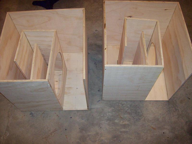

That's a small mouth. The driver is going to be mounted magnet out? Looks like that might shade a significant part of the mouth and cause a drop in efficiency and a noticeable change in frequency response that may not be desirable. Some of my experiments with my POC #1 suggest that even a small amount of shading was enough to noticeably impact efficiency.
... whether I can comfortably install and change drivers.
Could you move the mouth to opposite the driver?
Maybe this will affect the horn length too much, and I'm sure the directionality would change.
Regards, Ben
I need to learn not to open my mouth on stuff like this until I'm complete... oh well.
In terms of shading, installing driver etc... I don't think it'll be an issue, however only testing will tell for sure. One thing I've typically noticed, is magnet in mouth plays 'by ear' lower, which usually shows up in tests as more 40hz and less 100hz. Where this design is a little lacking in the 40hz department until you get to a block of 4, I'm hoping it plays to my advantage.

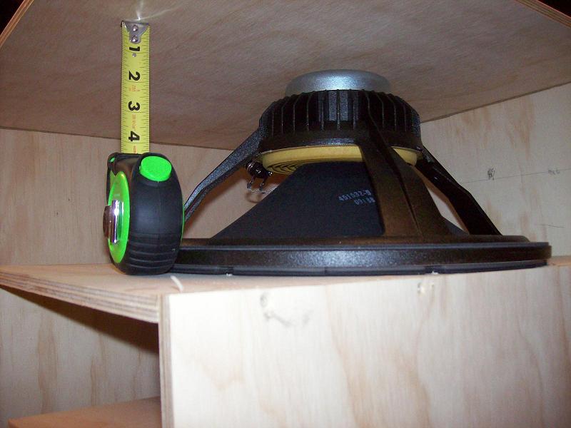

One thing I ALWAYS do, is mount the driver to the baffle board before any assembly happens. That way I can always exactly center the driver, and there are no surprises. When cabinet is done, it's a simple thing to reinstall screws or bolts.
With it being 23" internal dimension, and over an inch between magnet and cabinet -- installation of driver is easy.

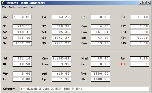

Hi jbell,
In addition to your version, that shoots for maximum low frequency extension, you might also want to investigate a version w/ flatter midfrequency response. It might provide some useful upper frequency extension, as well as (very) slightly improved excursion control.
