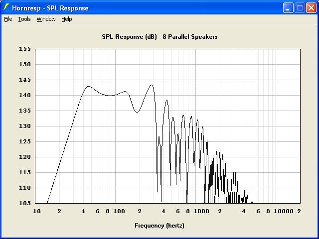

Here's a set of eight 24" cubes at 63v each in 2pi that is safe xmax wise to 35hz, that I'm starting a run of. Each cube can be made from a single 42lb sheet of 1/2" ply. (quite the contrast to 2 sheets of 72lb ply each.) Yea it takes more power/drivers to get there, but my back will like me better the next day.
Not sure I want anyone dancing on 24" cubes... so the big box is probably right at home for you.
If it tests out well enough to post plans, I will. (maybe don will be kind enough to draw up something pretty for me again....)

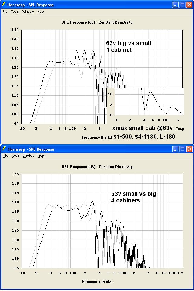

Will do. The small cabinet is not very creative... it's just a squashed version of the big cabinet. (I included the s1,s4,L23 for anyone curious)
And no, it does not compete down low with the big cabinet... for that, the big cabinet, well, lets just say I smile when I hear it.
Here's my arm chair quarterback sims. Looks like in a block of 4 they are very respectable to 40hz. In singles, the small cabinet is lacking.... Only testing will show if it has anywhere near the directionality of the big cabinet, and what resonances/reflectors are needed (if any) to get a good 'sound.'
EDIT: oops, just realized I didn't check xmax on big cabinet, 50v is all you should put into that to stay within 9.6mm xmax, which is 2db lower overall than what my graphs show. (with an xlim of 17mm you are safe with more power, just distortion will be setting in.) The big cabinet is safe xmax wise down to 32hz.... woof.

Ben & Flip:
Ben: check my 1 cab and 4 cab sims. Yes it plays lower in a pack, look specifically at the 40hz mark on each.
Flip:Yea more 3015lf excursion would be nice in the big cabinet, but in the small cabinet I'm good above 40hz up to 63v. Not sure the Vc really wants much more than that, so more excursion would be a waste. I think this cube is about as good a fit for a 3015lf as I've been able to come up with.
As far as easy... Rip 4x8 sheet 24" wide on table saw, turn and cross cut 2 panels 24x24 for side/side. Then move fence to 23.5" and crosscut 24x23.5 top/bottom. Take the other half and rip to 23. Crosscut a 23x23.5 for the back, move fence to 15, cut 2 at 23x15 for front and baffle, move fence to 11, crosscut 1, move fence to 10, crosscut 2. Use circle jig to cut baffle opening -- All done, and the about 10" long left over is there to make braces out of.
Nothing left over but dust...

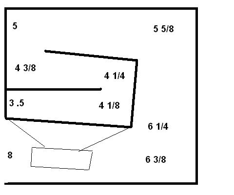

Hi Jbell
is the back panel 23" X 23 "😕
Also what is the angle of the internal taper?
Just trying to draw this up & get it right🙂
you caught me editing my post (doing this from memory, as I'm not in the shop...) back is 23x23.5
Here is a cartoon of what I remember. (dimensions are approximate, could be up to 1/2" off)
I really didn't want to post anything until I had a couple built/tested. oh well... anyone wanting to jump in early -- go ahead.
