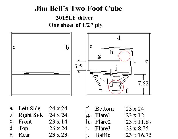

Hi Jim,
Here's my plan & cut list for the 2' cube.
Changes/corrections?
I'd love to see the calculations you used to come up with those folds, Don. I've been trying to come up with a similar folding scheme for another TH I want to build (S1=258cm^2, S4=1187cm^2, L=241.3cm), but not making much progress...

What kind of handles are you going to use for the cube? Also where will you place them?

Dayton PH114 Plastic Pocket Handle 4-Sided | Parts-Express.com
There are a couple options where the 5 3/4" cutout will work without interfering with an interior panel. I don't like spring handles (they vibrate) or strap handles (they are in the way) These seem to be the best idea I've found. With a jasper jig, circle cut outs are a 30 second process.. I've also thought about (but not actually done yet) mounting my jacks in these.

Thanks Jim... Got the pocket handles ordered. So where are the good locations for them to go? Sure don't want to put them where they will interfere with the output.

I attached a pic of the 2 places I'd put it. Neither place should affect the sound. The good part about the center option, is if you have to notch panel 'j' a little, that's ok, it doesn't create a 'leak' if you do. It should also get at least 3 screws into panels 'h' and 'i' with the slight possibility of getting the 4th into panel 'j' It's close to center of gravity, but not quite. I'm big on handles having something more than 1/2" of wood to connect to. Use the 'mouth' option if you plan on putting stuff on top of the cubes when carting in/out. You have the flexibility there to put them center of gravity. I am going to have to try jacks in these handles, as I think it should provide a nice 'protected' place for them.
