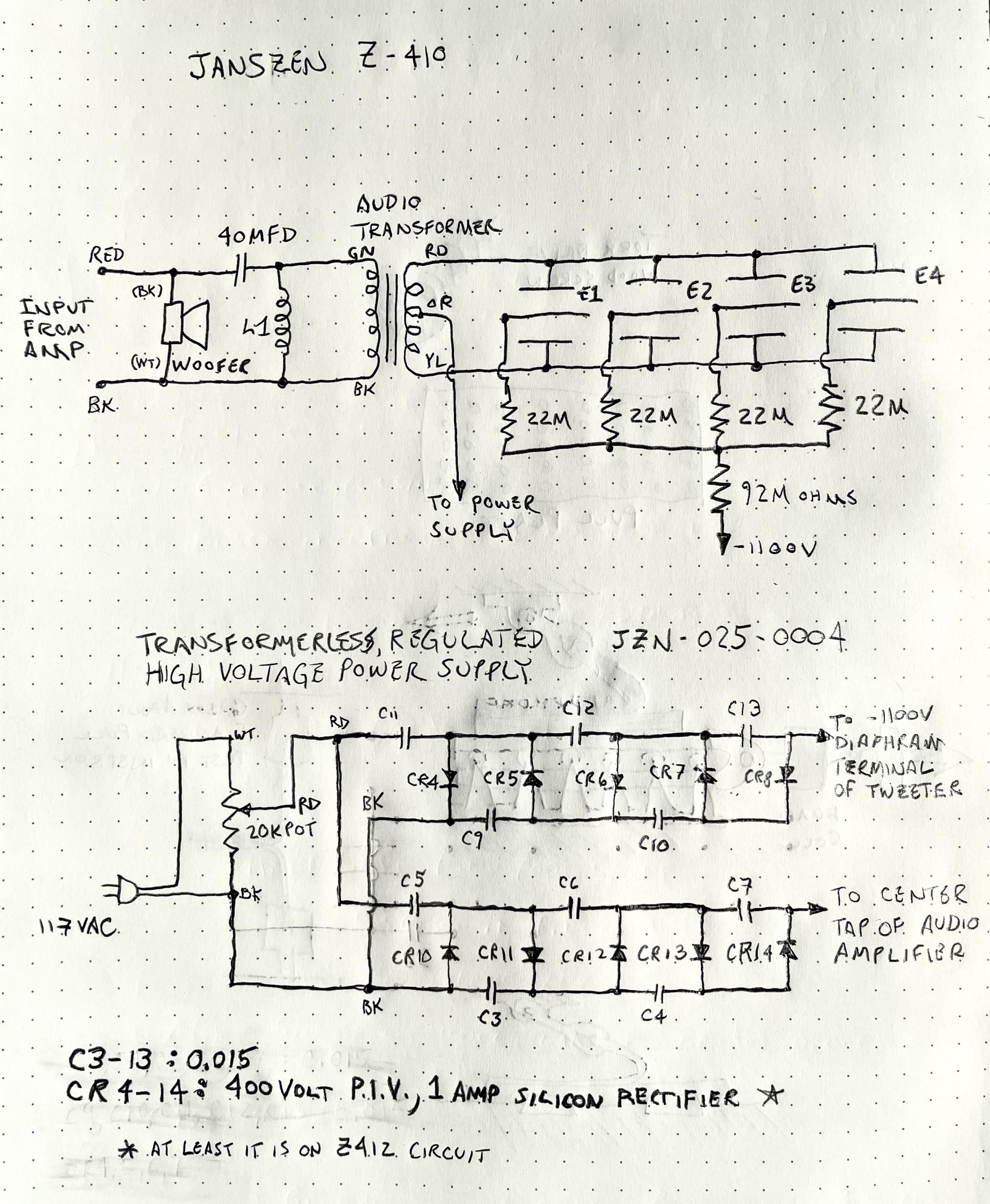

Here is a better schematic that follows what I think to be a Janszen wiring diagram format. You were correct, the top diodes were backwards. Ha! It is difficult to identify which way they go since I am looking at component parts mirror imaged from the wiring trace on the back both left to right and also the similar left side parts to right side parts. A double whammy for me.
Peter

Thanks for the additional board pic. Your schematic now looks correct. :up:

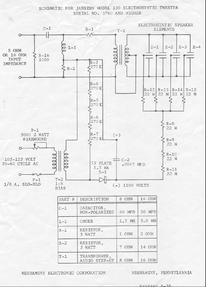

...In a note on his website, young Janszen mentioned the factory wiring diagrams got the polarity defined incorrectly.
You can see an example of the polarity error contained in some of the factory diagrams. The orientation of the diode would produce +1100V, not -1100V.
Either the diode orientation is incorrect or the voltage label is incorrect...I'm not sure which.
