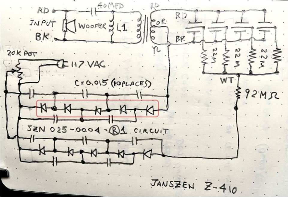

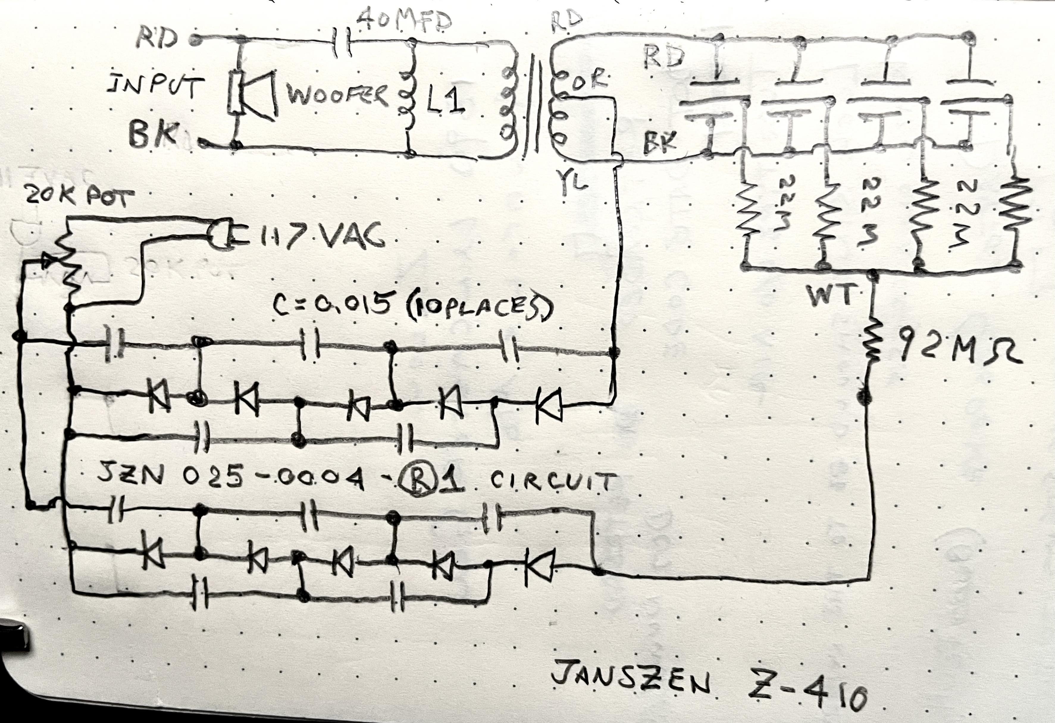

Here is my hand sketch wiring diagram:
Peter
I think this will work?

I can't see your wiring diagram.
If your interface is like the one I have, given what you've described I would suspect the 20 megaohm potentiometer on the output of the bias supply.
A few options to check it:
1) Swap the potentiometer from one speaker to the other and see if it fixes the problem. Discharge everything thoroughly first. Discharging is assumed in the next couple of suggestions also.
2) If you want to measure the potentiometer, you'll need to remove it from the circuit. Out of circuit, check its full resistance and also the readings from the wiper to each end as the position is changed.
3) You can substitute some fixed resistors in place of the pot and see if it then behaves correctly at various levels. There should be about 1200 volts DC coming out of the multiplier, so your resistors and/or meter need to handle that plus some extra for safety.
4) Assuming you don't have a voltmeter capable of reading the bias voltage, another diagnostic option would be to decrease the wall voltage with a variac and check the potentiometer's affect on the bias circuit at something like half the normal voltage. That should get you down into normal voltmeter range.
Since the bias is powered from wall voltage (mains electricity), there are potentially lethal voltages/currents inside. Be careful with whatever you decide to do.

The adjustment circuit of your bias supply is different than the one I have.
I would still start by checking the potentiometer though. You can test its action under power by connecting your voltmeter to the wiper terminal and the pot's lower terminal in your drawing. Across those terminals, you should have varying AC voltage as the knob is turned (0-120 VAC). As stated previously, be careful. That is potentially lethal voltage/current. Using alligator test leads to clip your meter in while power is disconnected is one safer way to do this (you should have no hands near live circuits this way, though you can have stored energy in the capacitors).

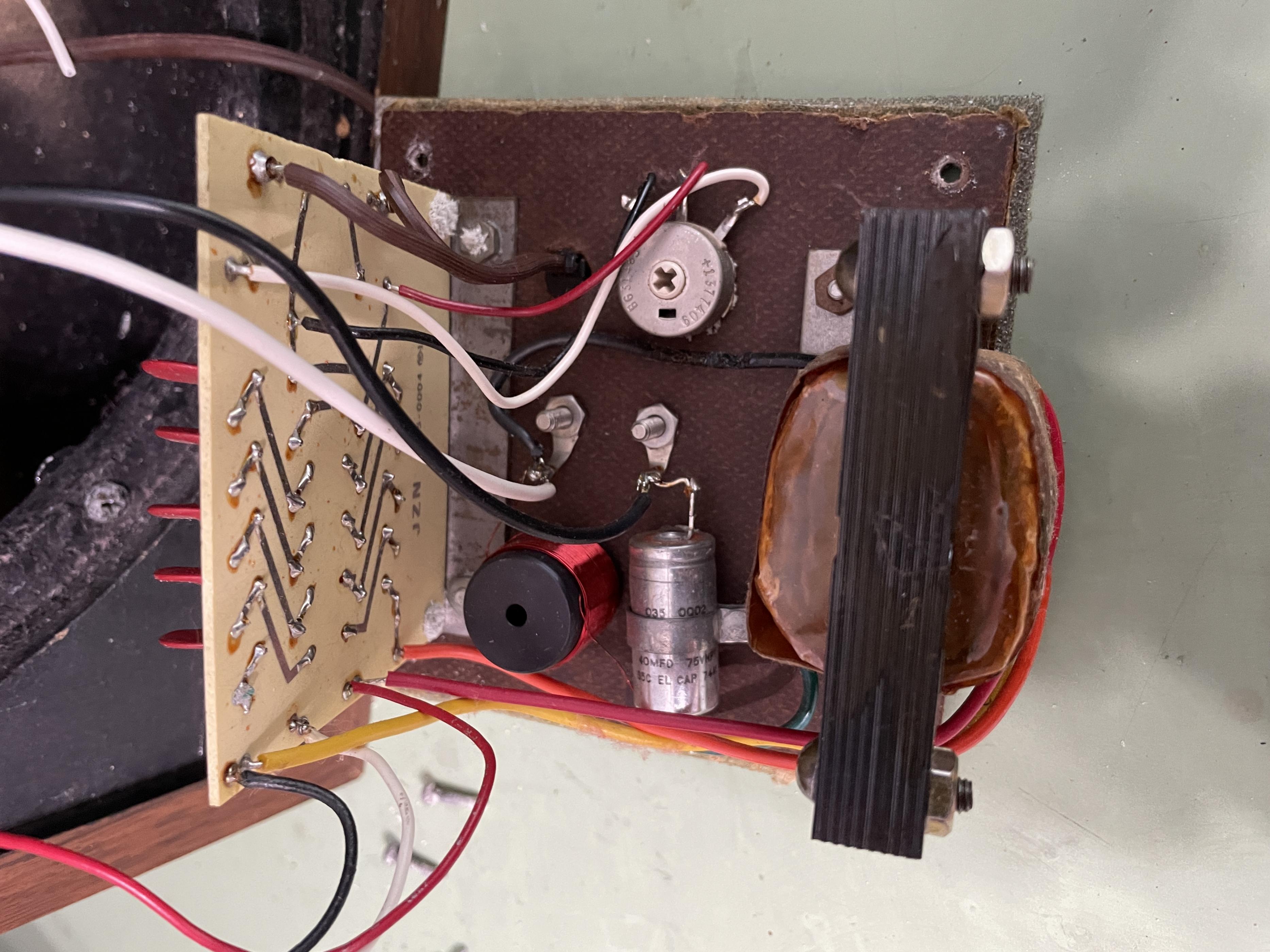

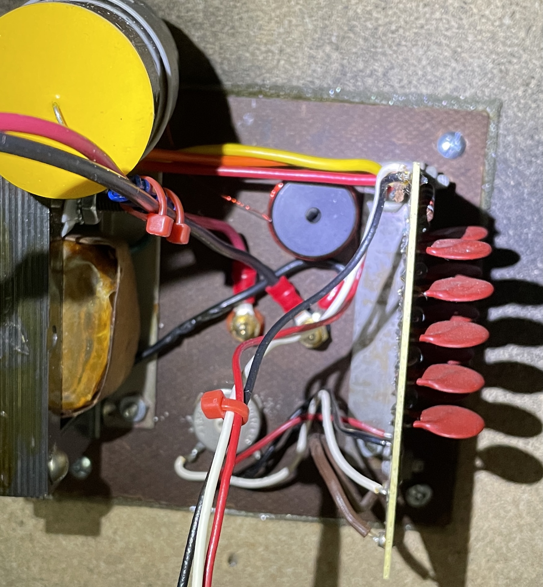

Hopefully, these are pictures of the circuit board before and after I recapped it and put on gold attachment connectors.
It bugged me that the red and black speaker connectors were run as black and white inside.
I changed wire colors and the 40mfd electrolytic cap to a polypropylene.
Peter

BTW, looking at the circuit, it seems the controls ought to be 0 - 100%. Maybe, there is a charge on the plates and letting them dissipate over time is part of my problem.

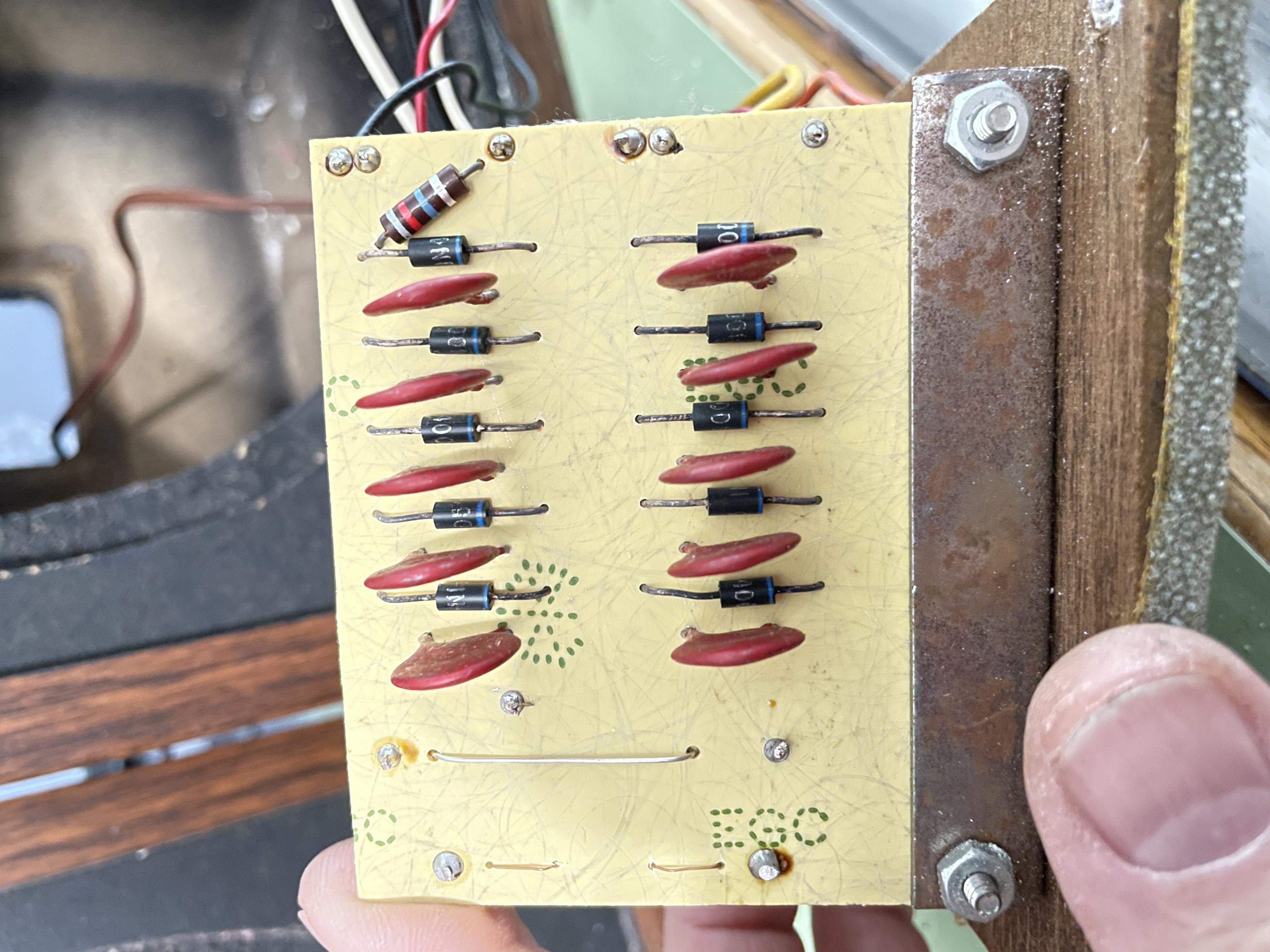

Thanks for posting the pics and schematic. Any chance of a pic showing the component side of the board?
Also, can you verify the orientation of the top string of diodes in the schematic? I think the orientation might need to be reversed.
Electrostatic components
Attached should be an image of the components and the wiring traces.
Curiously, I think I got the diode polarity correct but I’m not an electrical guy. In a note on his website, young Janszen mentioned the factory wiring diagrams got the polarity defined incorrectly.
Ha. Maybe I’m right or maybe I’m in good company.
Peter
