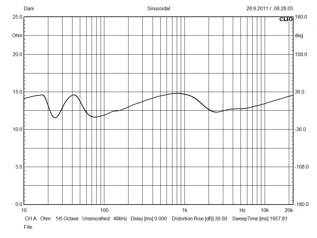

Hello dear comrades! Tell me please if there are measurements of the frequency response after modifying the crossover at post #68 from Kimon? I have Jamo Concert 8, I'm thinking about replacing the crossover, which one is better to choose? According to the scheme that System7 provided in post # 62, there are measurements on graph. After these modifications, does the sensitivity or impedance of acoustics change?
I have not made any measurements after crossover modification (I lack both instruments and skills ), nor System7 did. I relied entirely on Boxsim's predictions and, I have to say, I think that they are very close to reality.
Anyway, you may Judge for yourself. You can load the W17E (woofer) and T25 ( tweeter) files (provided by Dissi) to the Boxsim and check the results for each crossover schematic. Have fun!
(It is true that impedance falls to a minimum of 3 ohm, according to Boxsim, with my schematic).

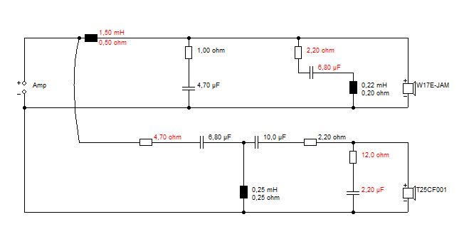

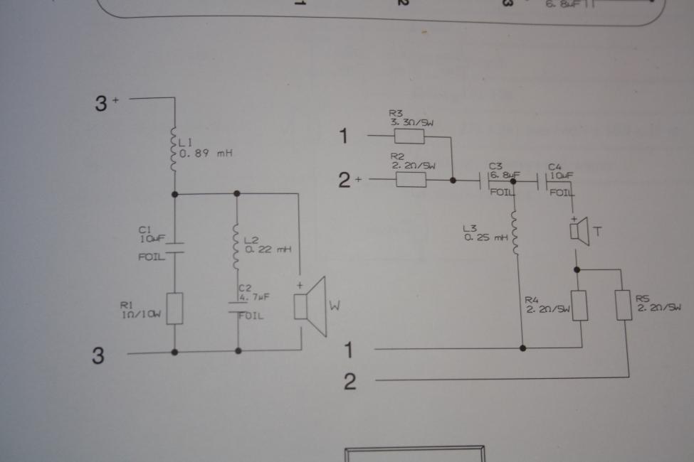

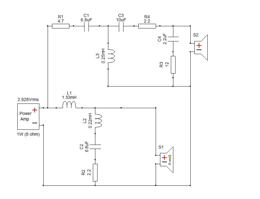

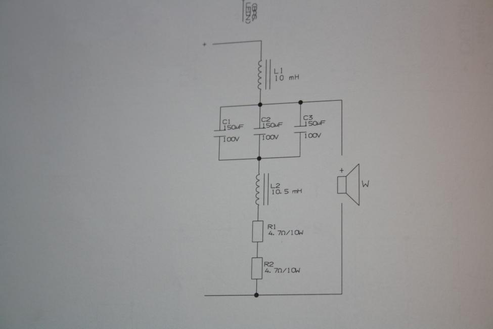

Hello guys! I decided to make crossovers for my Concert 8 according to the System7 scheme. The characteristics of commercially available coils are slightly different. By the values of resistors and capacitors, everything seems to be OK?I'm not sure that works better, but it's your project. I got a hole in the midrange there, and a 0.25mH with a resistance of 1.3 must be rare as hen's teeth. Really, "if it's not broken, don't fix it" is the engineer's motto! Fixing the notch was the main event. The idea is to get the rolloff as straight a line as possible. 😀
Original:
Mine:
You should post your frequency response if you want someone to check it.
Couple of Boxsim settings which matter. Boxsim needs to know the (minimal phase) frd measurement was made in "the box which is simmed". Acoustic centres (SEO) I guessed at 50mm for the bass and 17mm for tweeter. I used medium settings of 126 data points. I usually import over similar Visaton drivers to keep some factors similar. The AL170 and the SC10N here.
I did find my original sim was not very accurate due to some poor guesses. But I'm getting the same as Dissi now. And I think the phase is a bit butterworth, ie not precisely aligned.

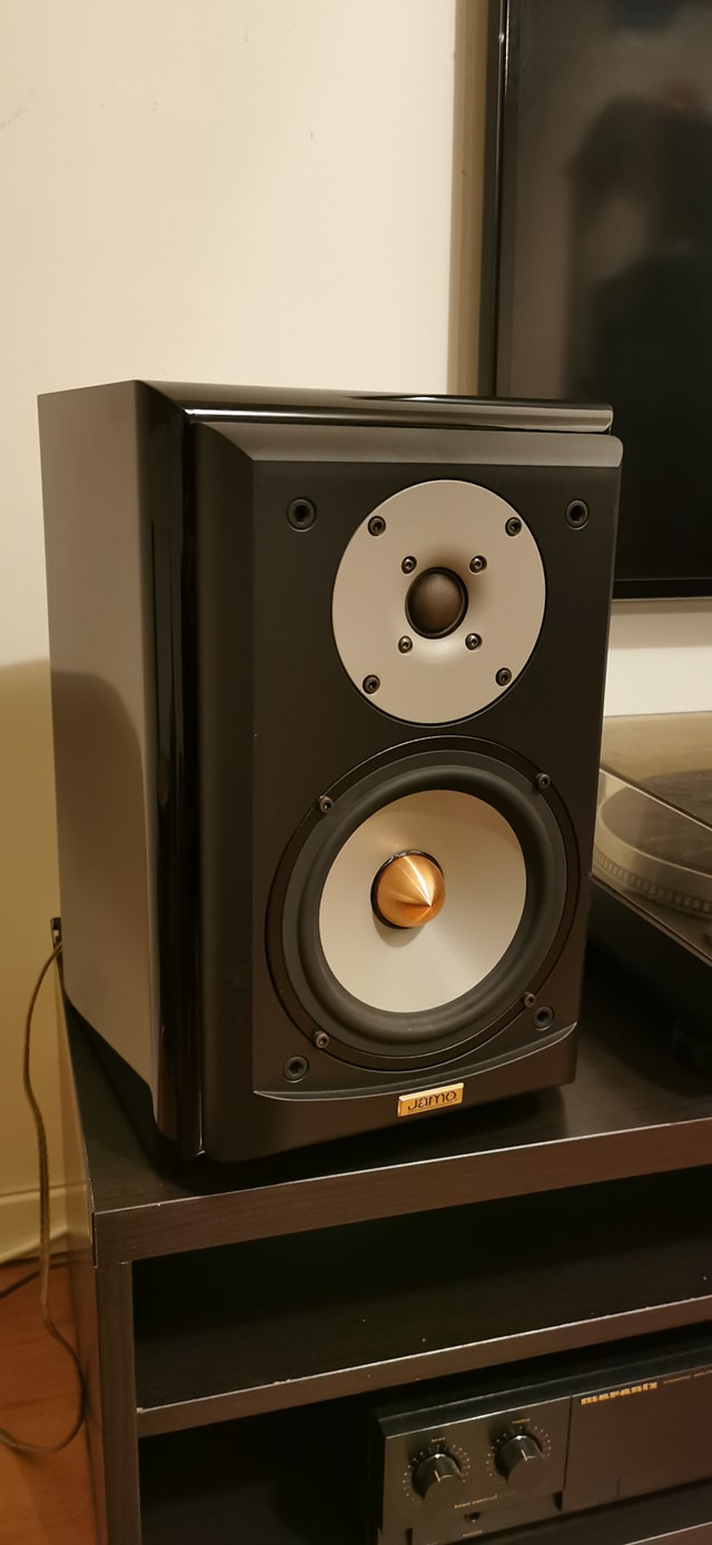

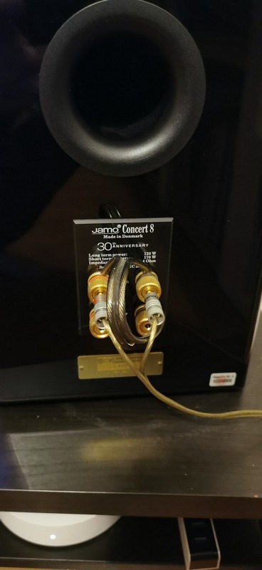

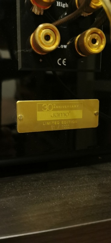

Hi guys,
As promised, I would like to present to you the very rare (1000 copies only) Concert 8 Limited Edition 30th Anniversary.
The sound is incredibly clear and the bass impressive for the size.
Glad to finally own them after all these years of waiting.
The installation is provisional, I will design custom feets for them this week.
More info to follow.
For infos, my amplifier is a Marantz PM7000 old version from 1999 with FX-Audio FX-01 DAC on PC with Foobar 2000 and FLAC & WAV files.

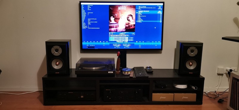

But i want to upgrade the amplifier with a new Leak Stereo 130 that include all entries i need and loose also some cables !
A good choice or not, that is the question but the many tests on youtube are convincing especially with the speakers used.
Some pics of this pure beauties 😍

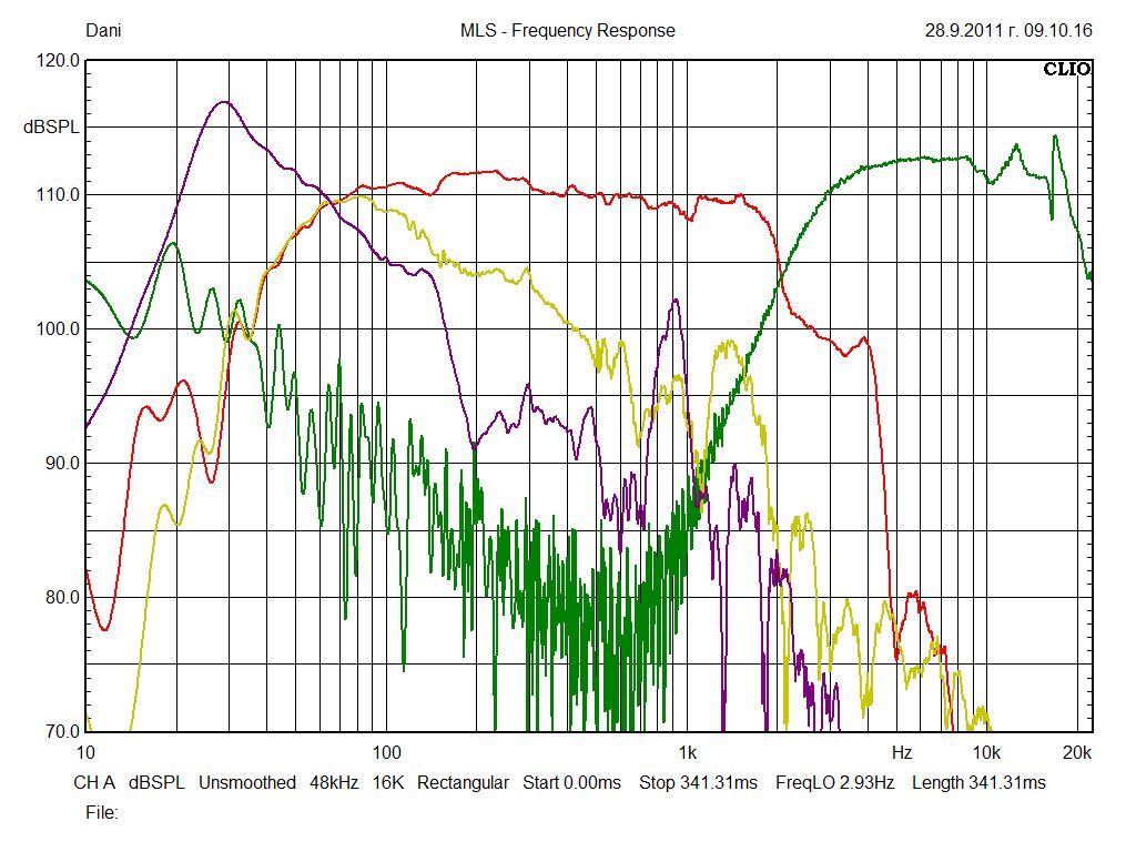

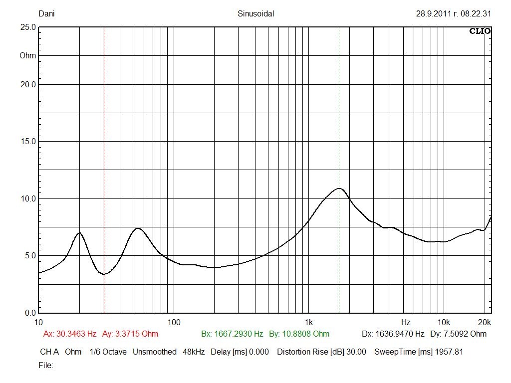

and Concert 11/D870
jamo - concert 11 - midwoofer + tweeter + vifa + br. - fr.,mic 2cm.,amp 30db ..jpg123.1 KB · Views: 245

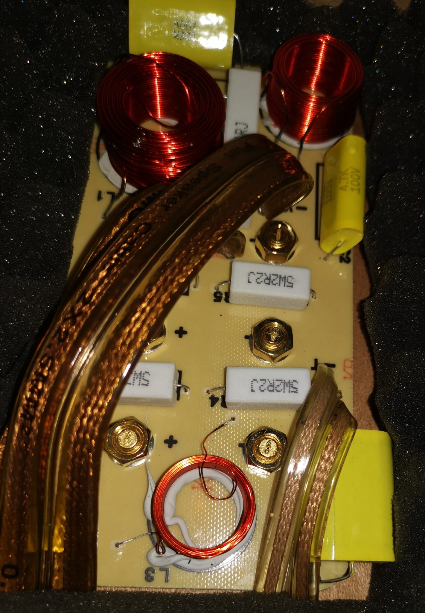

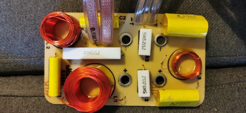

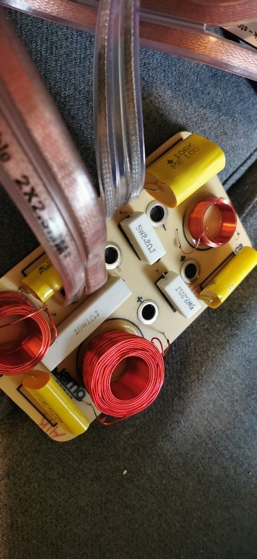

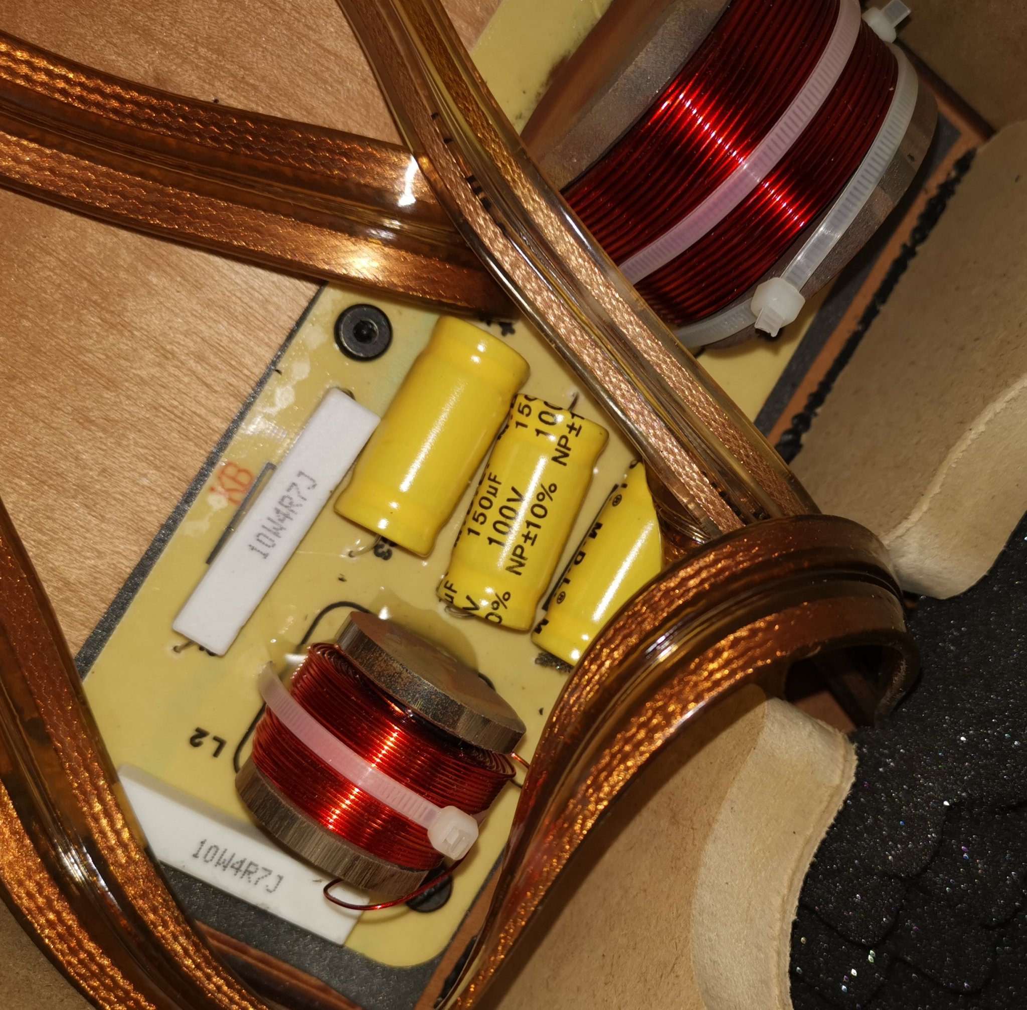

Hi guys,
I add too some pics of the OEM crossover of my limited Concert 8 if needed 😉
I don't have the specs of the selfs...
Jérôme.
Jérôme.

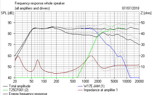

kimon, I think I have come to some conclusions here.
This speaker is quite similar to the SEAS Thor:
Which is a BW3 MTM design by Joe D'Appolito which is sometimes criticised for light bass, IIRC.
This might just be a bass voicing problem, dependent on room size and placement. The SEAS Thor could be easily adjusted, IMO.

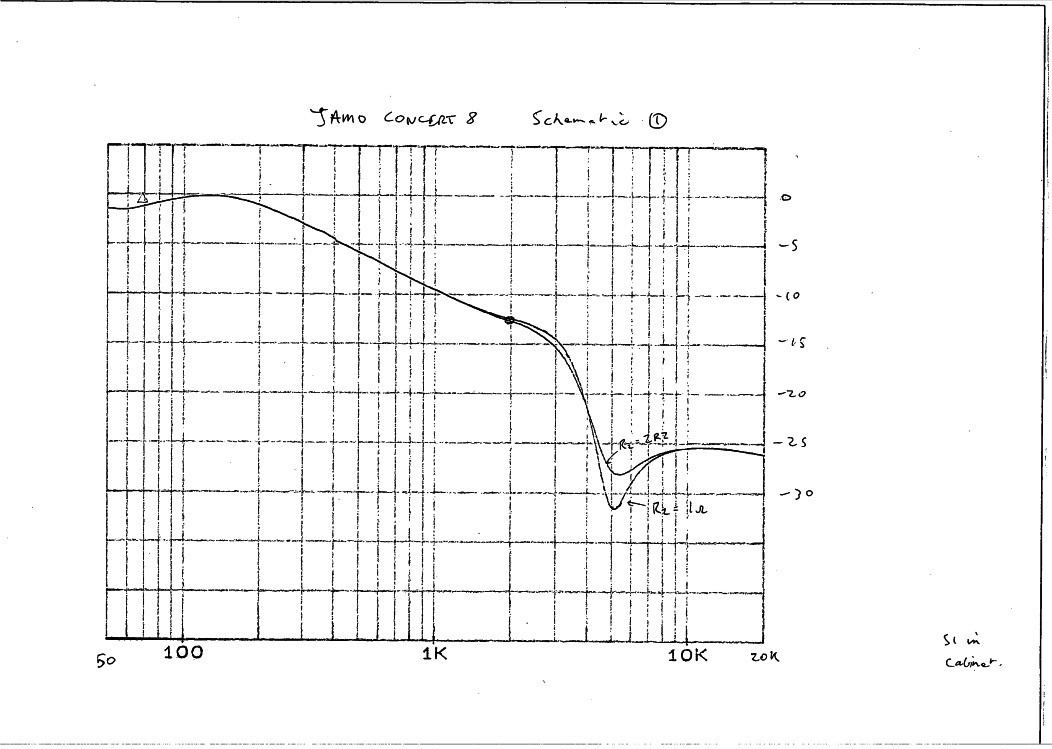

We have discovered the Jamo has a badly designed notch. That is fixed easily enough with two new components, 2.2R and 6.8uF. The voicing is adjusted for more bass with a 1.5mH coil for more slope and a 4.7R resistor to take tweeter down. 1R and 4,7uF doesn't do much, so we'll leave them. Finally, the T25 tweeter is bright at the top, so I like Joe's 12R/2.2uF zobel.
It all comes together as below. If you fix the notch and add the zobel, the voicing change can, of course, be tested on the biwireable connections externally with an additional 0.5mH and a 2.7R. The dotted line is your original as best we can sim it. Not too radical a change, really, and easily implemented I reckon..
I've just lashed up a mod to one speaker along the lines you've suggested, The only difference being that I found the effect of C1 R1 to be so minimal they have been omitted. With the values shown, I made an in-room measurement using averaged third-octive analysis and a pink noise source. Mic was on tweeter axis @ 800mm. There ara a couple of room modes to ignore (floor-ceiling) at 80 & 250Hz, but otherwise looks promising. The bass drive curve was taken with the loudspeaker in-situe in the cabinet.I found a third order tweeter was not so nice with fourth order bass. But don't let me stop you. 😀
I use 8 ohms nominal as a conventional label. They are usually 6 ohms DC resistance and the sim knows this.
The dotted line in the original sim might show what the filter is doing in the original Jamo Concert 8:
Not pretty, is it? I would call that a flawed speaker.
The second redesign I came up with is carefully modelled based on Dave's frd. It's actually regular 4th order stuff, with an added 4kHz notch for the breakup and a 1.3kHz notch for the typical surround resonance. I'm not too sure about exact tweeter level, but it's adjustable anyway.
If it works, I think it'll sound good. I could have got the tweeter flatter, but it messed up the lovely impedance, and it will be fine off axis, IMO. But hey, it's all the hobby. And a hobby is, by definition, an interesting waste of time! 😀
You can always get Boxsim from Visaton. I have a vague idea what I am doing when I import frd and zma files, but there's nothing like doing it yourself.

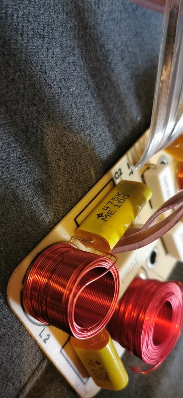

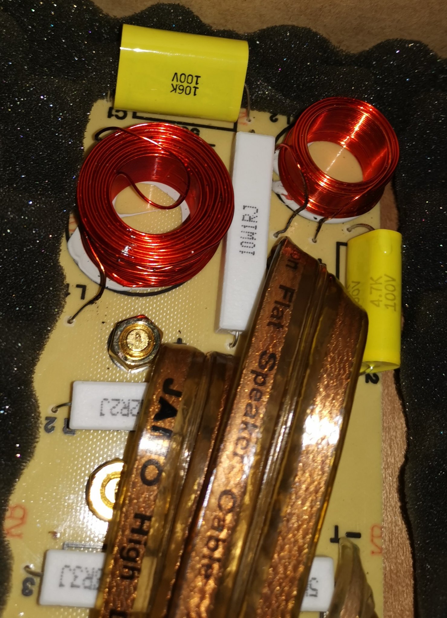

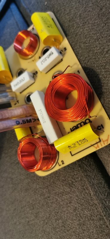

For my 20 year old pair of Jamo Concert D 830 which I have in secondary system,
I am going to replace capacitors and resistors.
I am simply going to replace with same values is caps and resistors.
For replacement I got Solen SA (4.7 uf) , Mundorf M Supreme ( 6.8 and 10 uf) caps and Mills resistors.
I believe a yellow capacitor marked as 106K 100V on the supplied crossover of Concert would mean value of 10.6 uf 100V. I am planning to replace this one with Mundorf M Supreme 10 uf 600V with Tolerance +/- 2 % , as I happen to have this one with me in spare . My question is : will be safe to install a 10.0 uf (+/- 2% ) value cap in place of 10.6 uf value cap? will it likely affect the out put noticeably or significantly?
