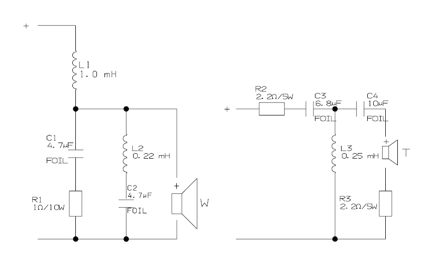

My intention was to improve the system response, whether by tweaking the existing crossover (retaining as many original components as possible) or completely re-designing it. In my opinion, the latter was of much more benefit. It is a good system, but it can be improved when one is not constrained by the cost of the overall crossover.
Personally, I was more impressed by the box/baffle than by the drivers/crossover, although the latter are excellent on their own, despite my concern with the midwoofer.

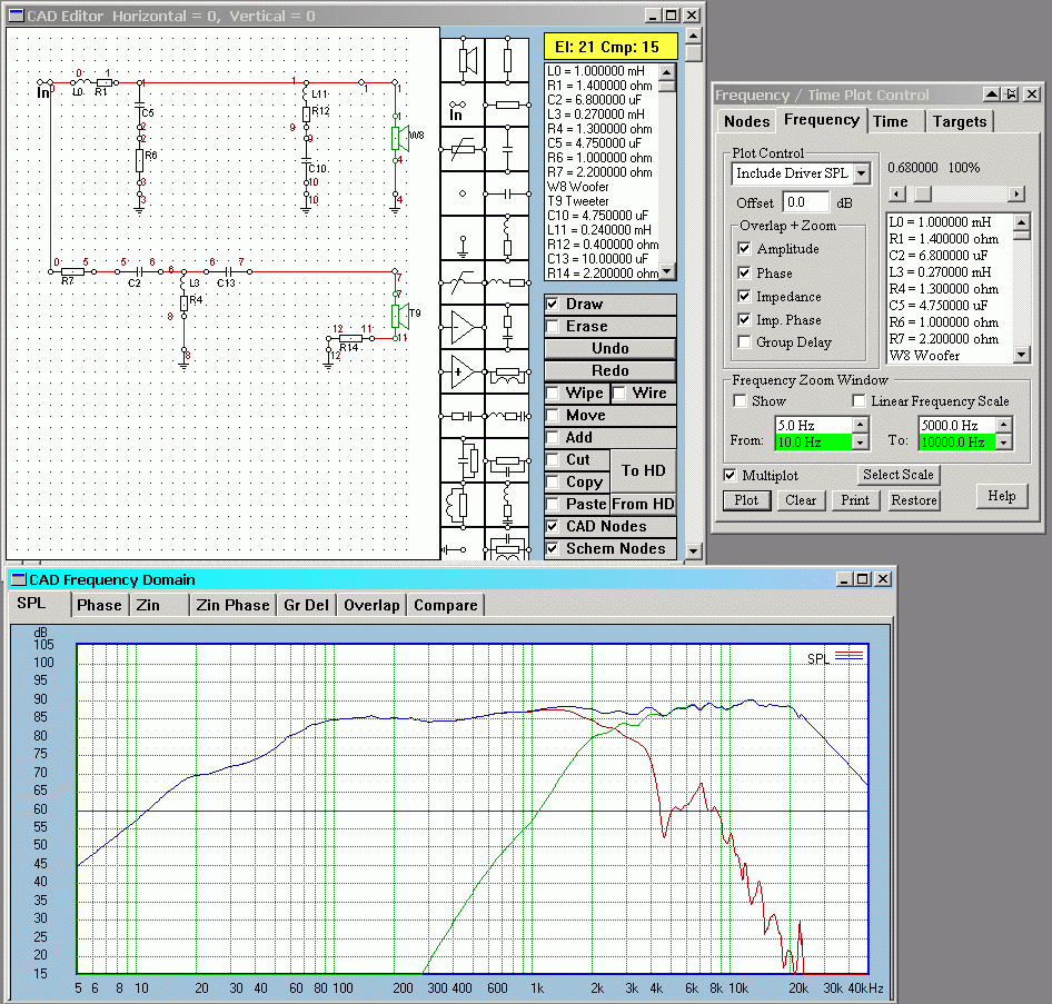

2000Hz is not low for a good tweeter. I would say that the crossover is 2500Hz, not unusual, especially one of the quality of this Seas unit. My final crossover was around 1900Hz, but then I seldom drive a system as loud as many would. A manufacturer has to take some possible abuse into account to protect it.
I am confident of the crossover schematic. I ran a quick test in my new design program. A typical third order electrical on a tweeter (with the L-R 4 acoustic response) often has the second cap somewhat (or very much) larger than the first one. Swap the caps and the summed response is definitely bad.
I don't comment on cap quality. I'm not one to put emphasis on this, other than to use good quality caps, avoiding non-polarized electrolytics, except for certain 3-way woofers due to the large values sometimes required.

Hello Kimon,
The suggestion of lowering levels of the woofer at 1 kHz and lowering tweeter levels by 3-4 dB's seems spot on. Have a quick look of DLR's measurement of the original speaker and it becomes pretty obvious this is a sub-optimal x/o design.
The designer opted for only minimal Baffle Step correction, and to make things worse, the somewhat rising woofer response, which is matched by a similar trend in tweeter SPL.
The woofer L of only 1 mH is already a give-away in this respect, although the woofer is a nominally 4 Ohm unit. Furthermore, the 5-6 kHz peak is insufficiently sucked-out.
Correct the BSC, and make the woofer flat as of 100-150 Hz, matched with a flat tweeter crossing over at 1800 Hz or so, and you will have a very nice system.

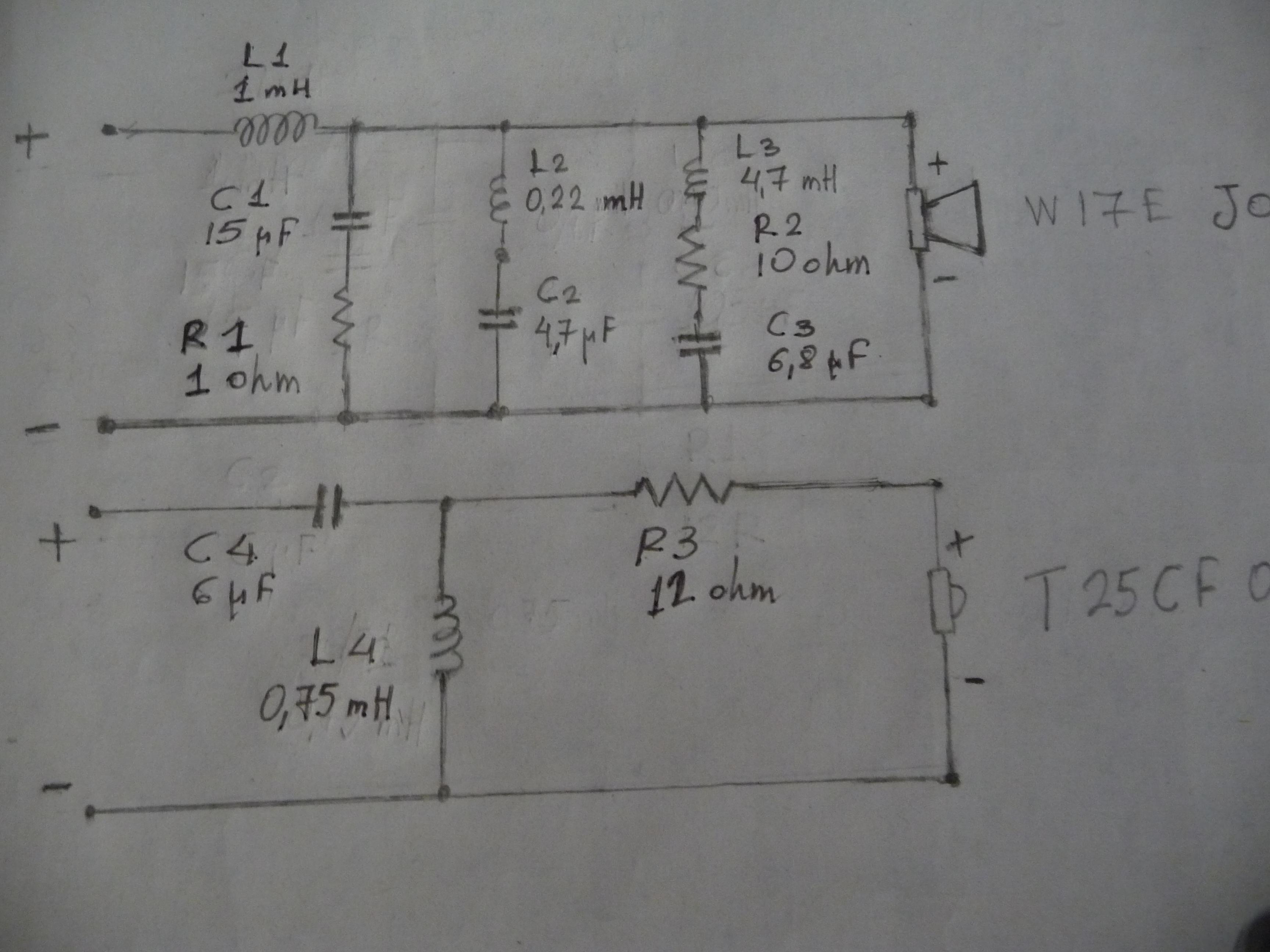

and thank you for answering.This is my opinion too,and I suspect that the nicely curved front baffle makes things worst(just the opposite of what happen with women curves!).I am inclined to use J.Bagby's high pass crossover for the Excel T25 tweeter found on this page: DIY2000
So, we are done messing with the high pass.What about the low pass?Sadly, there isn't ready-made solution.In order to achieve full BSC I am thinking to halve the cross frequency from 2500 Hz to 1250 Hz by doubling the values of L and C: 1mH becomes 2mH and 4.7μF, 10 μF.Will it works?Ah, and something peculiar about Jamo's crossover:the existing values L and C are well chosen for a 2nd order L-R or Bessel crossover at 2500 Hz,but for an 8 ohm speaker.Any explanations?

Here's dir aka Dave's analysis:
And your current modification:

Steve and Shaun I am much obliged for your friendly advices.I have been searching a lot in the Net last year, looking for crossover solutions that one could use to couple W17E jam (woofer) and T25CF001 (6 ohm tweeter) in a more "agreable" way than that of the designer of JAMO Concert 8 / D 830.Both drivers are made by SEAS,the latter (tweeter) being still in production.Woofer is specially made for Jamo,and it is identical to the W17E 002 with the exception of the resistance:it's 4 ohm,not 8 as the normal production unit.That been said,finding crossover for T25 is fairly easy.I have chosen Jeff Bagby's solution,presented in the DIY2000 contest.It's 4th order,with Fc at 1750 Hz.The only disadvantage for my task is the rather big resistor in series with the speaker (12 ohm),that reduces tweeter's output to 83-84 db (according to Jeff's simulations).I'm planning to replace it with a 9-9.5 ohm one,in order to reach 85-86db.My concern is if this change will affect drastically Fc.I have been told no,not significantly.
On the woofer branch I tried only minor changes. My goal is to reach 85db.I added the LRC circuit to have full BSC and I increased the shunt capacitor from 4,7 to 15 μF in order to achieve a 2nd order filter(i.e. to increase the slope and have an Fc around 1300 Hz.The answer for this lies in W17E's distortion profile:it has an increasing 3rd order HD after 1300Hz,with a peak at 1800Hz.Thus the low Fc).Should I omit the 1 ohm resistor?According to online calculators,1mH/15 mF gives a L-R or critical filter, 1mH/21mF a Bessel and 1mH/31mF a Butterworth one.Any opinions about which one to choose?(I use mh-audio.nl calculators).
Errata...Jeff Bagby's crossover is 4th order acoustical.Crossover branch.Sounds like a family tree.I'm talking about passes or ways.
OEM crossover and files in WinPCD
These measurement files were from 2007 when I started working with the system. I took a few minutes and found the PCD session files (this was before I started work on WinPCD). Those can be imported into WinPCD, making an easy transition, but the measurement files must be manually imported as PCD didn't save that info in the session file as does WinPCD.
I used the AC Offset section in WinPCD with the minimum-phase version of the files and set up a session file in WinPCD. Double check the values, but I'm fairly sure that they are for the OEM crossover. You should add in estimated or measured inductor resistance values for any that may be missing. WinPCD has entries for some inductors that aren't in PCD which was due to the limitations Jeff had with Excel.
